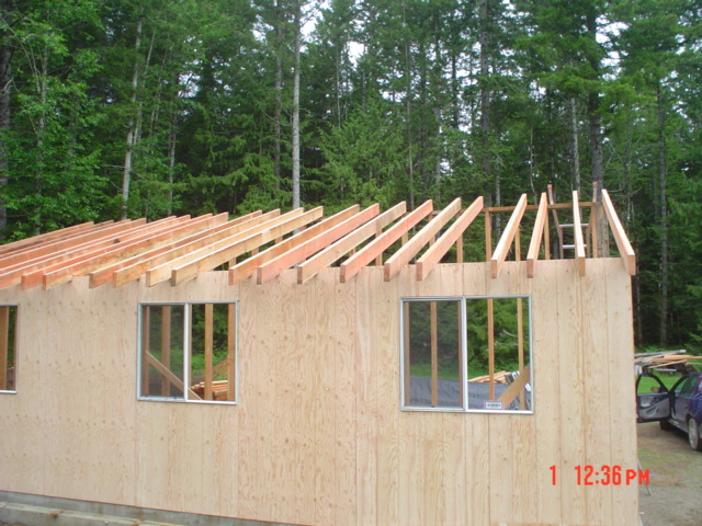

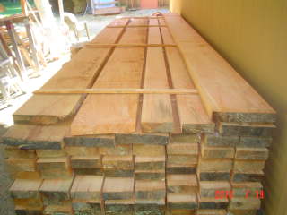

A couple of years ago had to buy some lumber for a company I worked for. Even after picking through a stack of lumber the best ones were still crap to say the least. :( Lucky I have some nice Douglas firs on my place that I have been able to mill. A couple had died and took down 4 altogether, 70-90 years old and up to 4 ft diameter. After getting milled by a band saw on my property they get stickered between layers and then air dried for at least 6 months. You can't buy what I have at the store. :D Depending on your project and area you may try to talk to some band saw mill operators who would cut to your specs.

It will help if you can lay out your lumber in a manner such that air has access to all sides of it. Laying a board on a concrete floor is not a good idea. Moisture will evaporate much slower from the side of the board that is facing concrete, causing it to warp. "Stickering" boards (placing narrow slats of wood at bottom of pile and between each layer) will help to decrease warping. That being said, you need to have decent lumber to start with and even then, some boards will warp. I bought about $1000 worth of lumber from Lowes about 2 months ago, and was very surprised at the quality and straightness of their boards. Maybe it has something to do with geographic location. I am in western NY.
