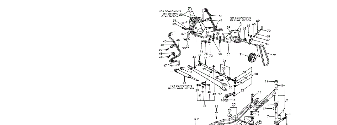

No power steering. That is a shock absorber.
I really don't want to mess with it.
   / What to do with a Ford 4000? #13
That is not a shock absorber. PS cylinder is anchored to the radius arm and mounts on the "tie rod". See the attached.
   / What to do with a Ford 4000? #14
Yes it has power steering, you can see the pump in one of the pics. Now how well it works is another question.
