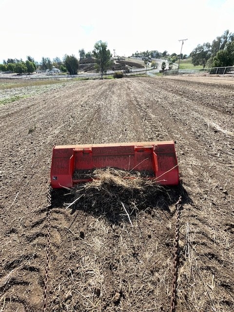

I stared at my junk long enough to think I already had a good drag. It was heavy and indestructible with a round front edge that would not dig in and a stout grading blade on the rear... All I had to do was flip my bucket over and tow it behind the tractor. Actually worked pretty good lol. For a no cost one time use, I'm happy.

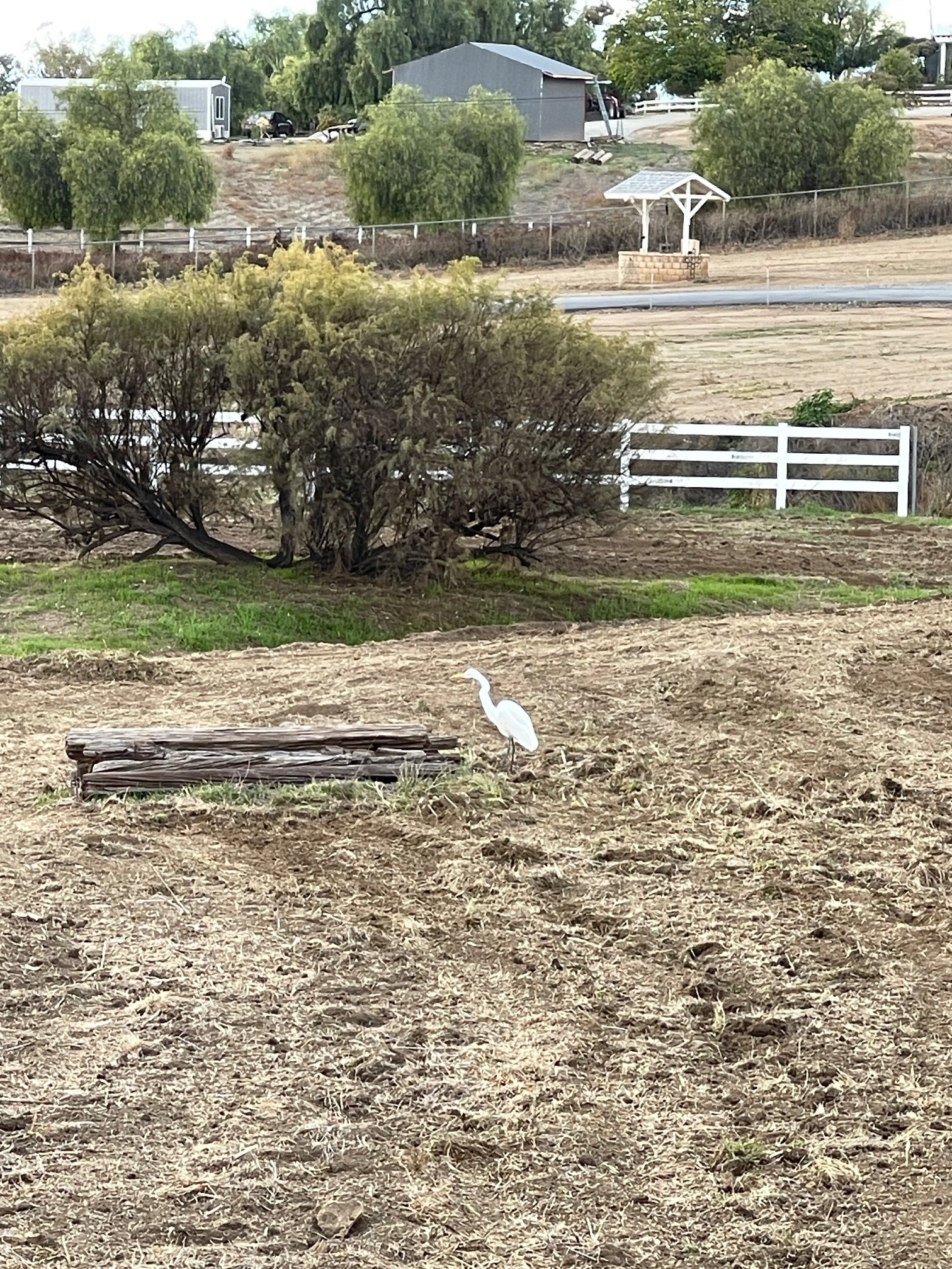

And this Giant Crane came by to see if I kicked up and snakes or gophers... lots of gophers.

Very creative. Looks like you got great results from it too!!!!

I was surprised how well that worked. And pleased I did not make or buy something for this one time use...hope this helps somebody else needing to smooth a large area.

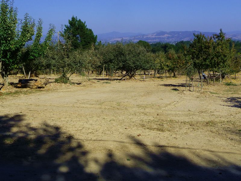

This would be slow for a large area, but I've had good results back-dragging the area after digging out stumps with the backhoe and driving over the fill to compress it. Bucket down and floated, with bucket curl adjusted to grade like Scootr described above. And while going backward, swerving can move material sideways toward low spots.
This is where apple harvest bins are lifted onto the truck so it has to be level, or at least smooth.

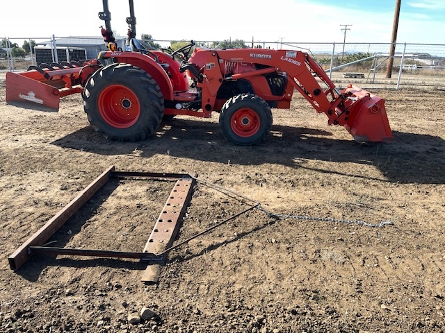

I made something out of the stuff lying about. Don't laugh, it was free :giggle:
Buddy gave me an old dozer blade...
Worked good on a freshly disced field to smooth it out for mowing next year.
It actually buried a bunch of the under 6" rock. The bigger stuff still on the top will have to be gathered but now you can see them a mile away.
Note the heavy rear channel is lower than the blade.

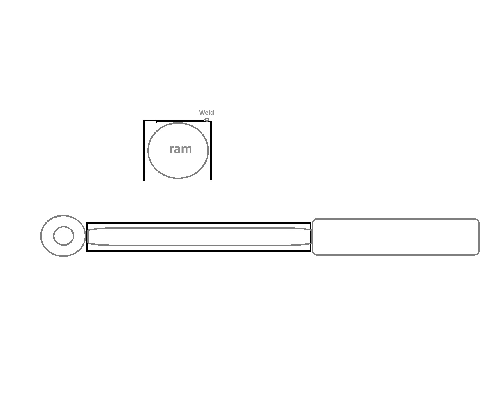

Just made a pair of cylinder safety locks using scrap L metal. 2 pieces laid over each other making a U shaped lock. I prefer the bucket raised to clean the air filter etc.
These will make it safe.
Pictures later.
