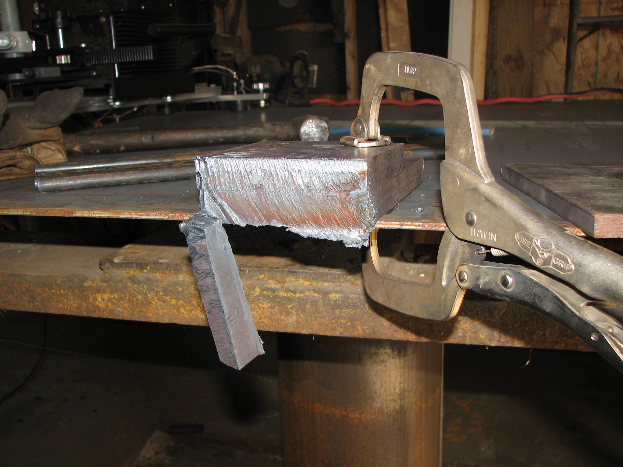

The Hypertherm Powermax45 will sever 1", it is factory rated as a 1/2" machine for production use, with 3/4" as maximum thickness with at least a 10 inch per minute speed, and 1" as severance cutting. Personally I have cut 1-1/2"......very slowly. If you look on the Hypertherm website you will see the ratings for each of the systems clearly spelled out. I also must add...the Hypertherm units are designed and manufactured in Hanover, NH, USA by employee owners. All of their ratings are easily achievable, and actually quite conservative.
Someone in an earliier post said that plasma's were "expensive to buy, expensive to operate".......They can be expensive if you buy top of the line equipment, however the best plasma cutters are very inexpensive (far less and much more versatile than oxy-accetylene) to operate. You will also find that a good brand 45 amp plasma, like the Hypertherm Powermax45, will cut faster, thicker, and with about 6 times the consumable life of the low cost 60 Amp imports. The low cost imports may be good if your budget only considers purchase price, and not performance or operating costs.
The first picture is two pieces of 3/4" steel stacked and cut with a Powermax45 hand torch in my home shop. The second pic is a part I made from 3/8" steel, the holes were cut as well, on my 4 x 4 cnc plasma with the same Powermax45, the last pic is a piece of 1/4" steel cut with the 45. I use it for hand and machine cutting.....its capacities far exceed Hypertherms recommendations, and it is very inexpensive to use as the consumables last a long time.
