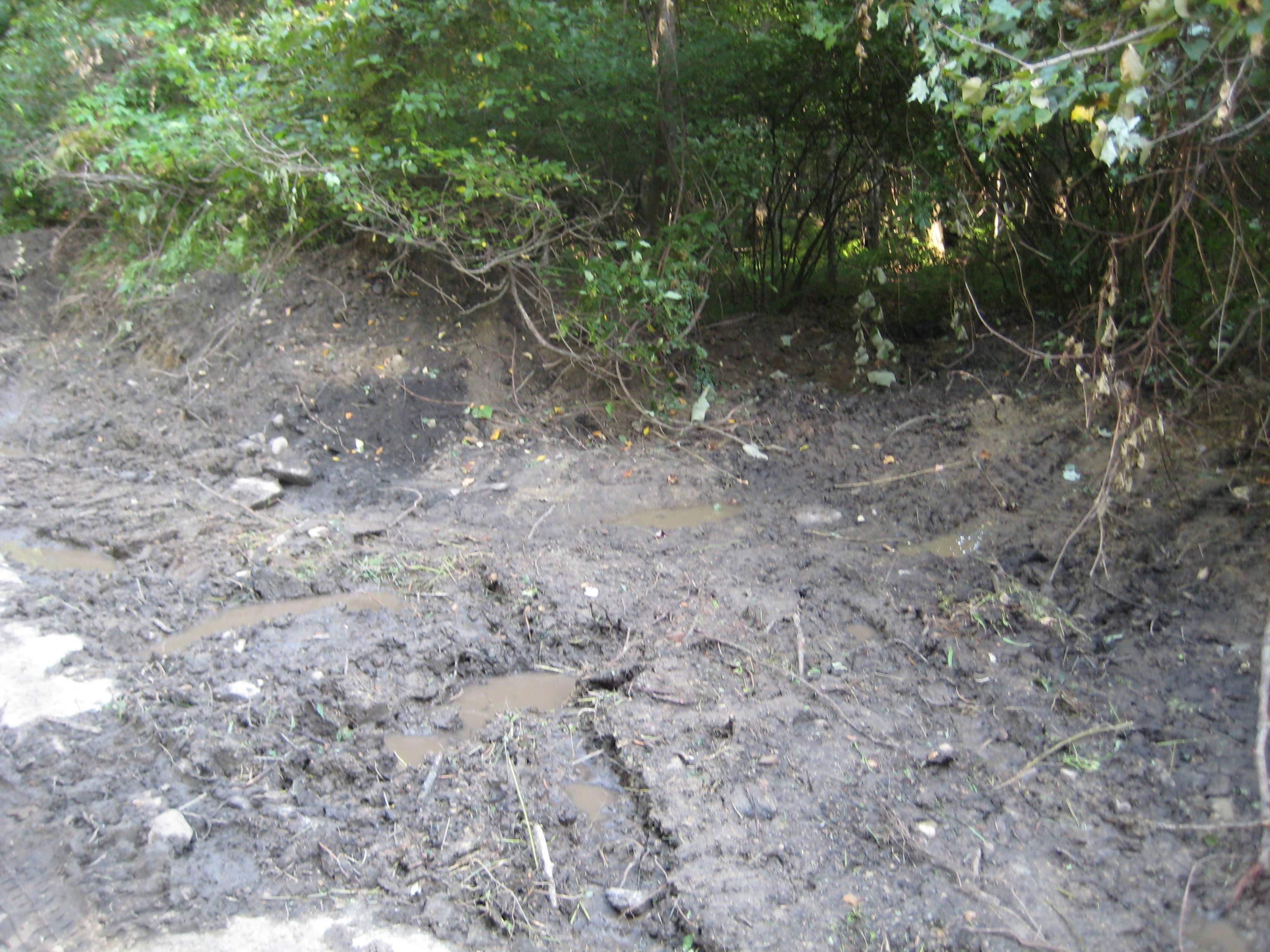

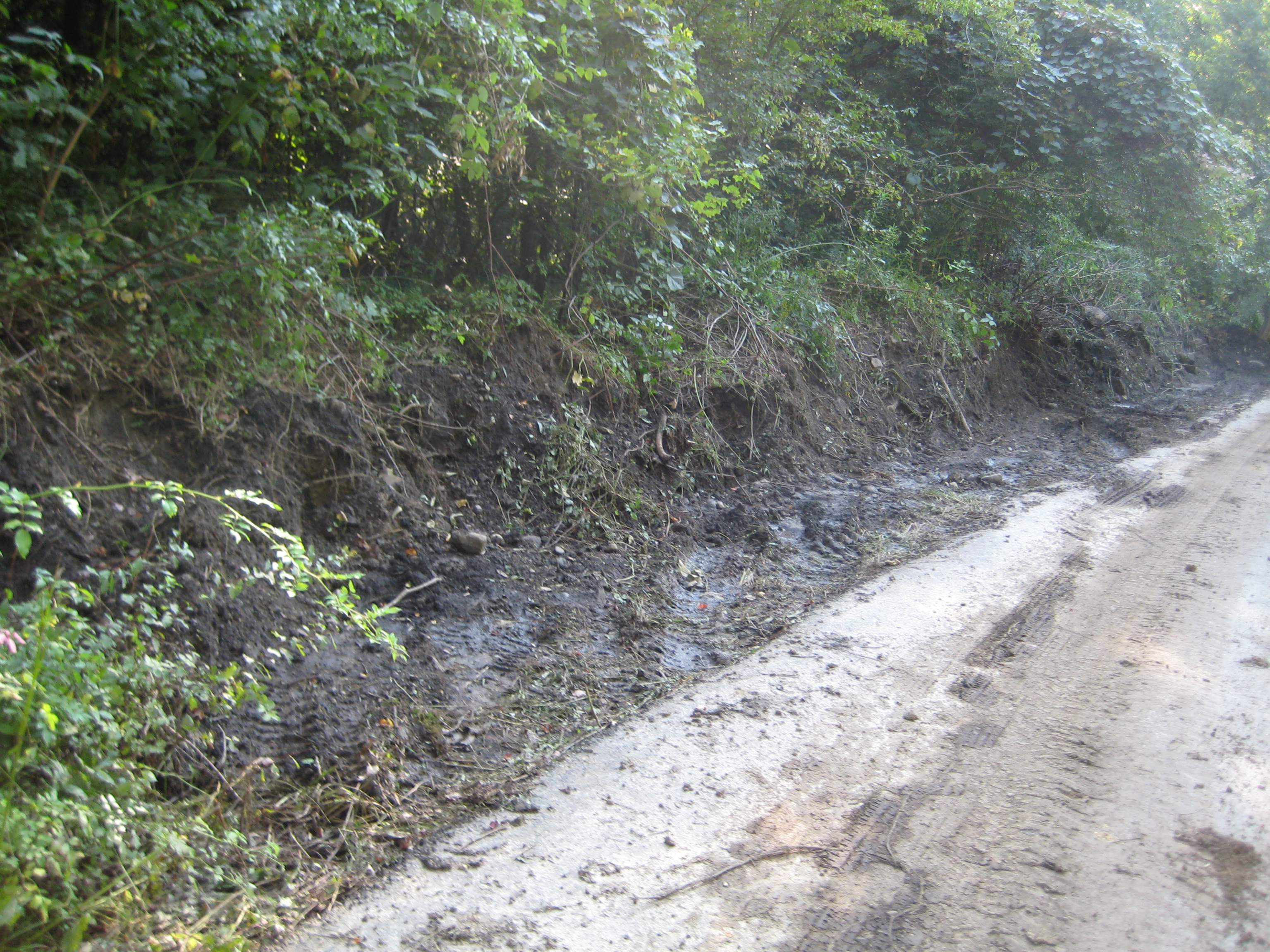

#13
The bad erosion is in the ditch that channels all the water down to a 12" culvert going to a pond. The fast downhill is slowed down now by large rocks placed every 20 feet. Now I am opening the other side of the driveway for a snow push area. Water just stays on top of this soil as in the picture. I might try a ditch behind this to see if it drains but I doubt it. I got some Timothy seed today and once I have the whole driveway cut back 2 feet I'll plant it. The burms used to be right up to the drive so it's going to be better

   / WHAT TO PLANT BY DRIVEWAY FOR MUDDY GROUND? #14
It's hard to tell, but is your driveway cut into the side of a slope or through a knoll? Is that the origin of the berms? Or, are they banks pushed up by a bulldozer when the driveway was built?
I don't think, from the pics, that you are working with a wide enough overall space for a driveway and ditch. Ideally your driveway surface would be the highest thing, then lightly sloped berms 3'-4' wide, then a ditch that is deep enough, ~ 2'-3', to draw ground water from the elevated drive and berms.
It would mean moving a lot of material to get to what I am picturing compared to the pics, but if you do several hundred feet each summer, eventually it gets done. Your backhoe and loader should be able to do that as long as you don't encounter big rocks or ledge. They can be dealt with too if need be.
An intermediate solution would be to cut through the berms every so often and direct the runoff through those cuts if there is enough fall away from the outside of the berms to work with.
   / WHAT TO PLANT BY DRIVEWAY FOR MUDDY GROUND? #15
Dave is right- your driveway needs to be higher than the sides so that water flows off. Your ditches need to be deeper and sloped to drain- either alongside your drive or under your drive in culverts. The ditch water has to run somewhere. In the past during drier years - it sounds like surface runoff worked. But with this rain in the Northeast- not good enough. You have some backhoe work there. I don't think plants will cut it. It looks like your ditches are not deep enough.
