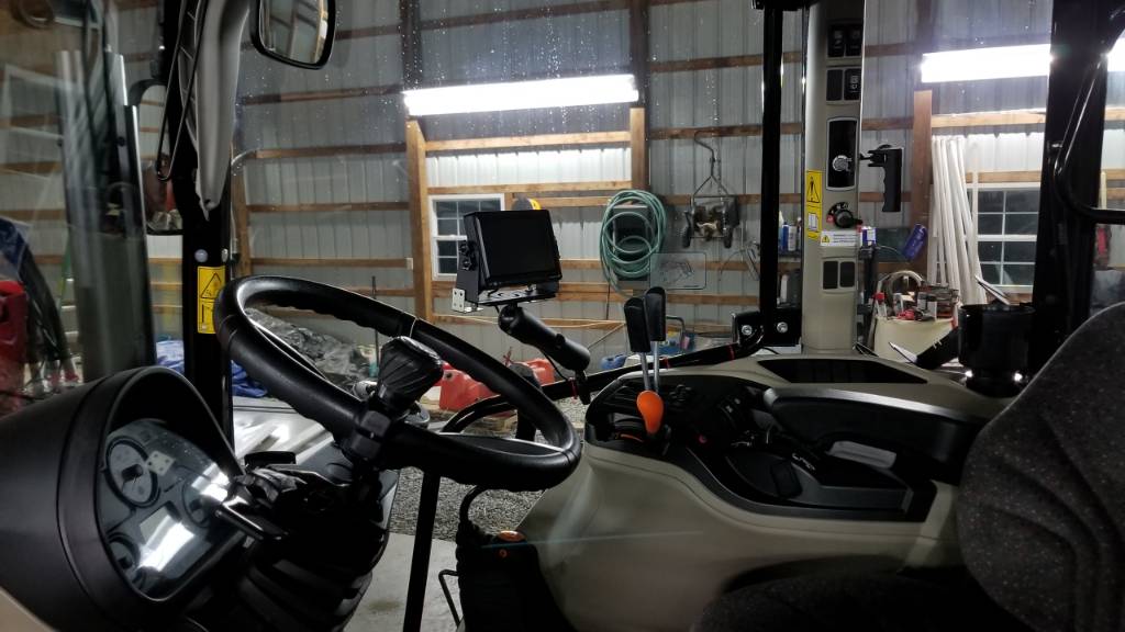

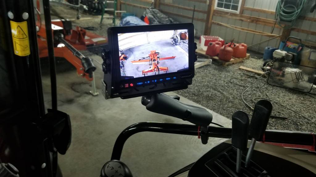

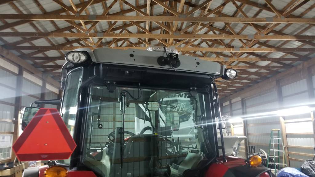

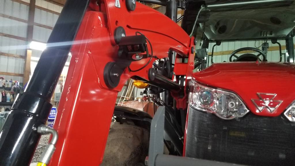

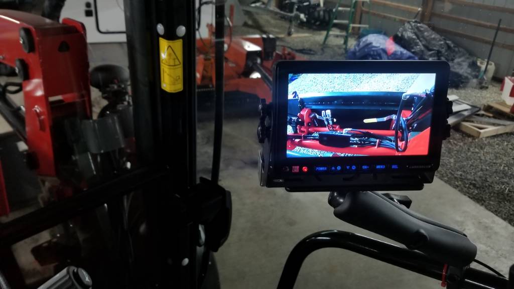

The power and video are all is one wire so you dont need to run 2 sets. The wireless still requires a power wire. Here is my setup... 20181201_162546.jpeg20181201_162559.jpeg20181201_162515.jpeg20181201_162503.jpeg20181201_164638.jpeg

4 pin cables are better video quality than RCA
