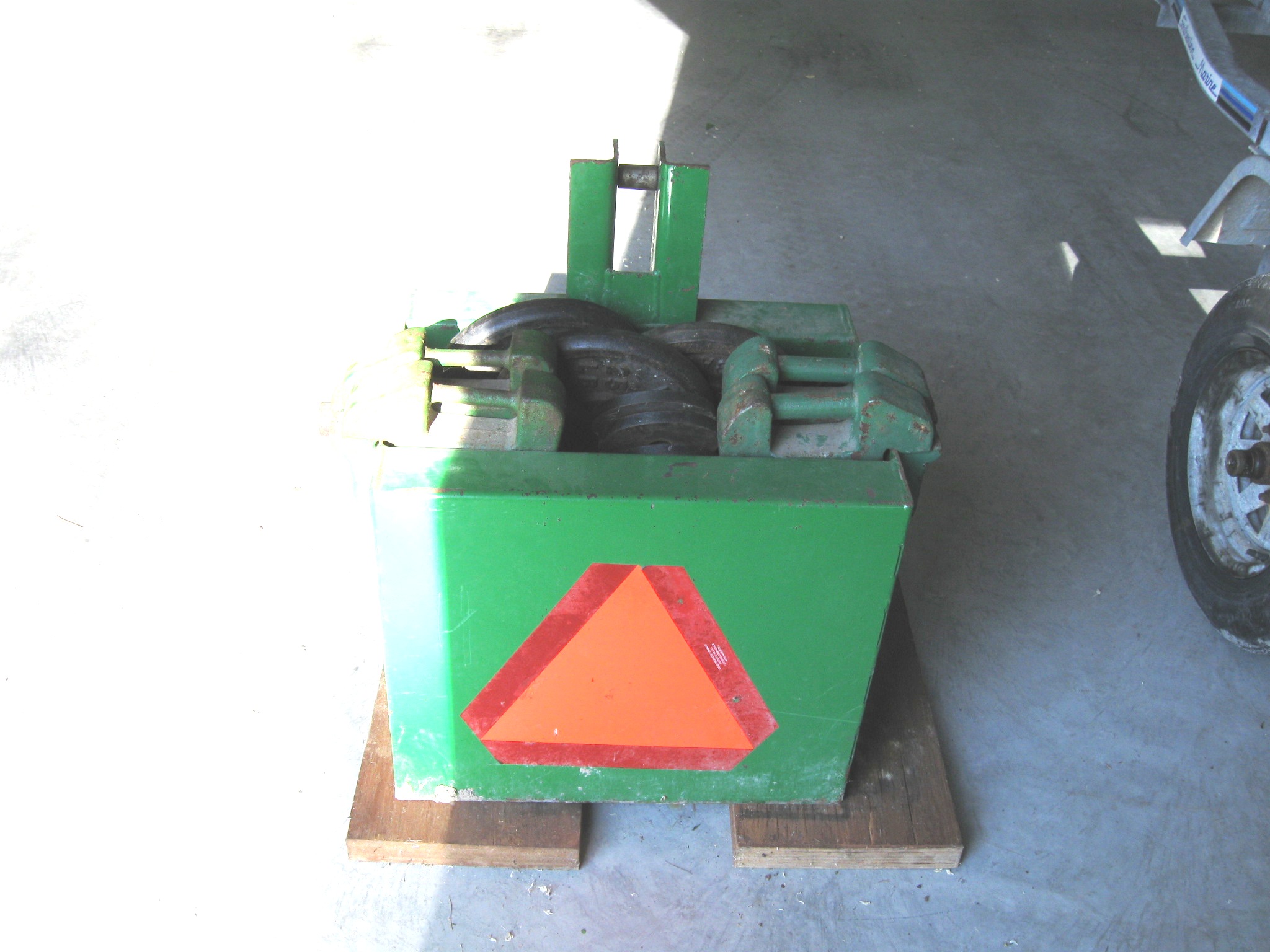

I just used some old lead weights that folks had lying around.
Four JD weights came with the 4300.
Easy to manipulate the weight. $$$ was right.
