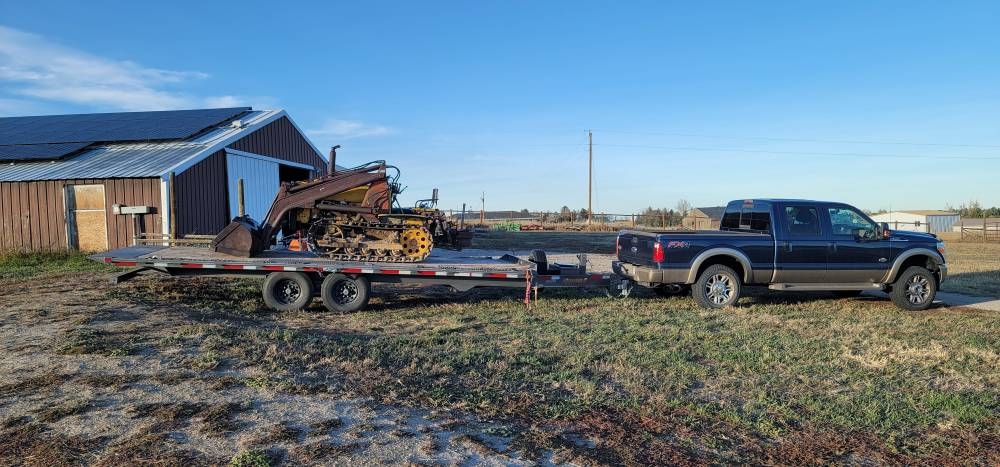

$2,400 brought it home. Fired right up from cold. Everything operates as it should. No wear on the track bushings. Sprockets look to be in great shape & aren't sharp. Judging by the brighter paint, I expect a vaguely recent rebuild of the undercarrige, or at least the sprockets. Hydraulics leak a touch & one of the glands on a curl cylinder dribbles a lot. Hoses are are old, but not super suspicious.
It came with a pile of spare fluids, some filters & the origional manual.
I'll need to pull the curl cylinder, probably all of them & get those rebuilt. Hopefully that will be it for a few years.

Mine ran great for an hour. Then it died, gas started pouring out of the carb. Waiting for the carb rebuild kit to show up, but have the carb fully disassembled & cleaned. Foat needle didn't look to be in good shape. Tore a gasket pulling it apart.
Kind of what I was expecting with an antique.

Carb rebuild got it running again. Could have used a bit more tuning, but it ran pretty decent. Busted out the new hot pressure washer & cleaned all the machines & cars off. As I half expected, that killed it again. Pulled the cap & rotor. Cleaned them up with some emmery paper as they were looking a bit crusty. Plug wires ends were a bit rusty as well. Had to grind off one of the fasseners holding the hood on as it wouldn't come out after loosening.
Spent a few hours scraping & chissling mud off the rear end & under the hood. I started clearing/cleaning my way to the spark plugs & got distracted. 50 years of dirt, oil & grease is apparently about like JB weld or old chewing gum. Several inches thick under the hood ontop of the engine. Most of it is finally gone & I need to bust out the steam cleaner again. But highs for the next week are under 50 & that doesn't sound fun.
Havent bothered diagnosing things or even pulling the plugs yet, much less seeing if it actually has spark. Waiting on tuneup parts it really needs anyway. And to finish cleaning it so I dont get dirt in the distributer or cylinders. Then onto rebuilding the cylinders & probably replacing hoses.

I'll definitely get it back up & running soon. All the internals are fine. Just relatively easy to access electrical stuff. Not hard to figure out with maybe a dozen wires total in the machine. My main holdup has been freezing weather & wanting to steam clean it again before moving forward.
Tuneup parts showed up yesterday.
