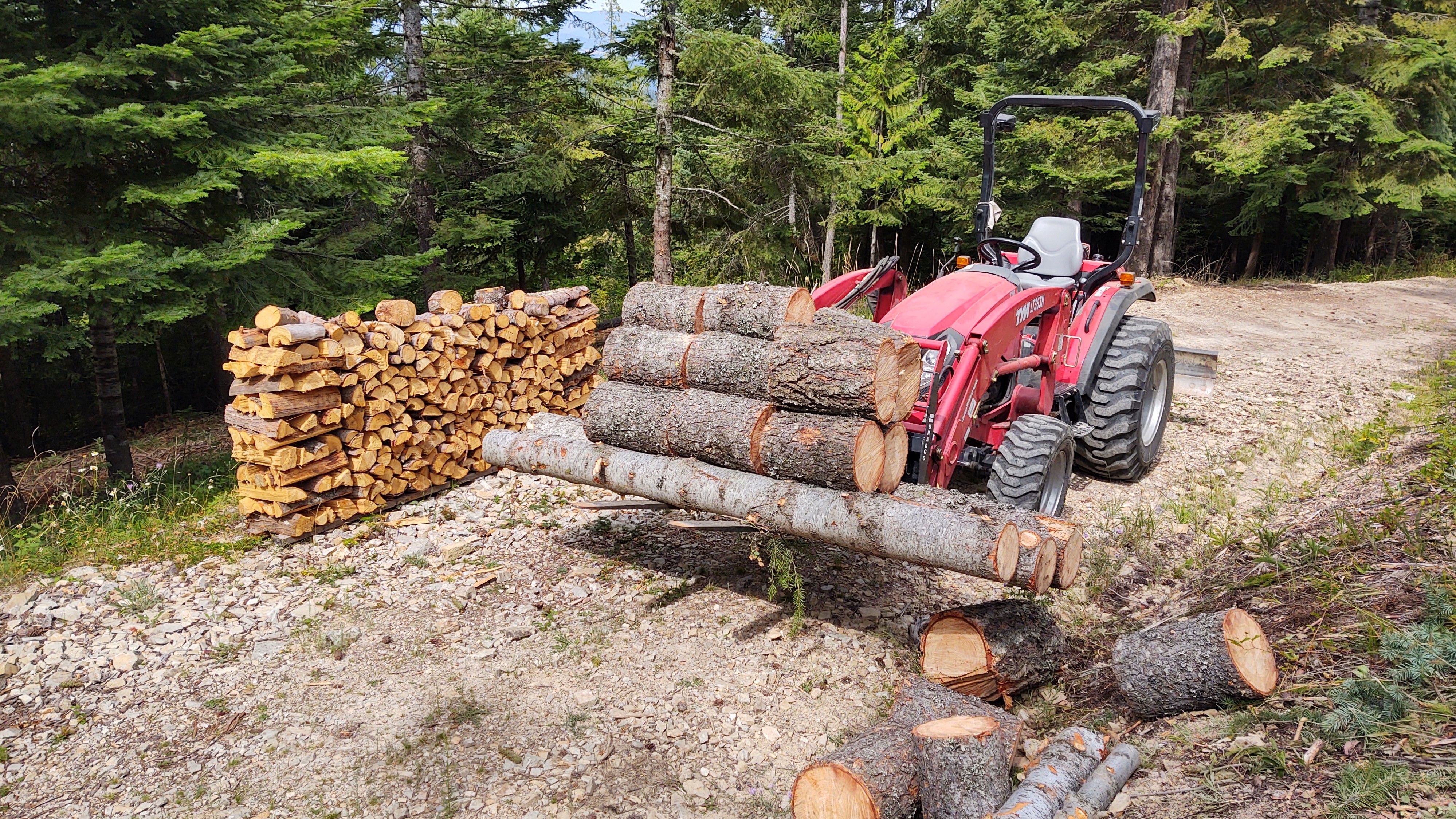

If you choose pallet forks or grapple. Know the max you can lift. Remember the lower the load is lifted - the more you can lift. There will be weight lift charts in any Op Manual for a grapple - use them. I have a log weight chart. Got it off a site after a search of the internet. I have a very good idea what various diameters & lengths of my logs will weigh.
I cut any/all my ancient Ponderosa pine logs into either - five foot or ten foot lengths. All my trees are Ponderosa pine. Makes calculations pretty straight forward.
A picture of an old pine log. Approximately 20 feet long and 38" diameter. I cut chunks off and use for various projects. View attachment 681767

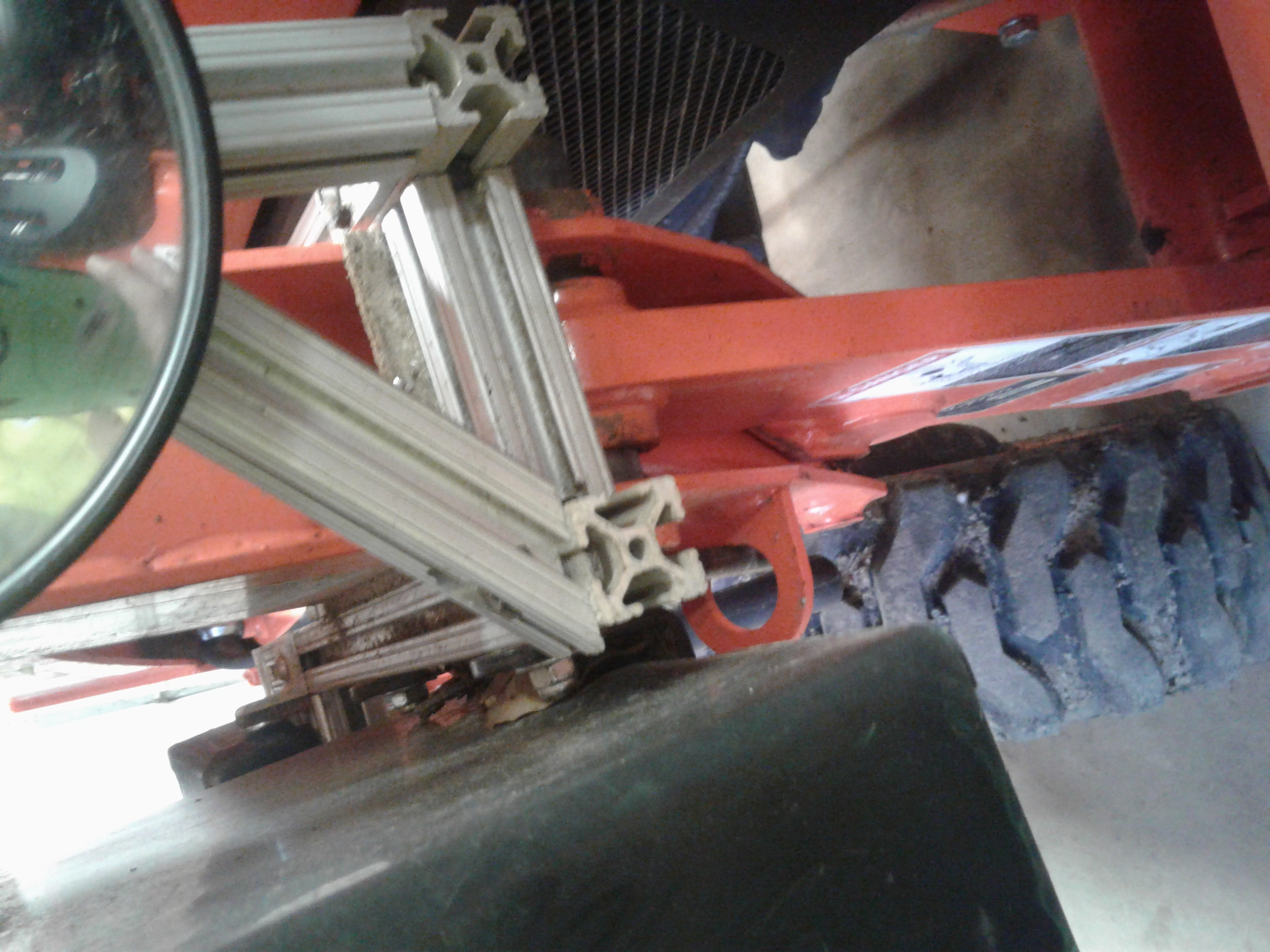

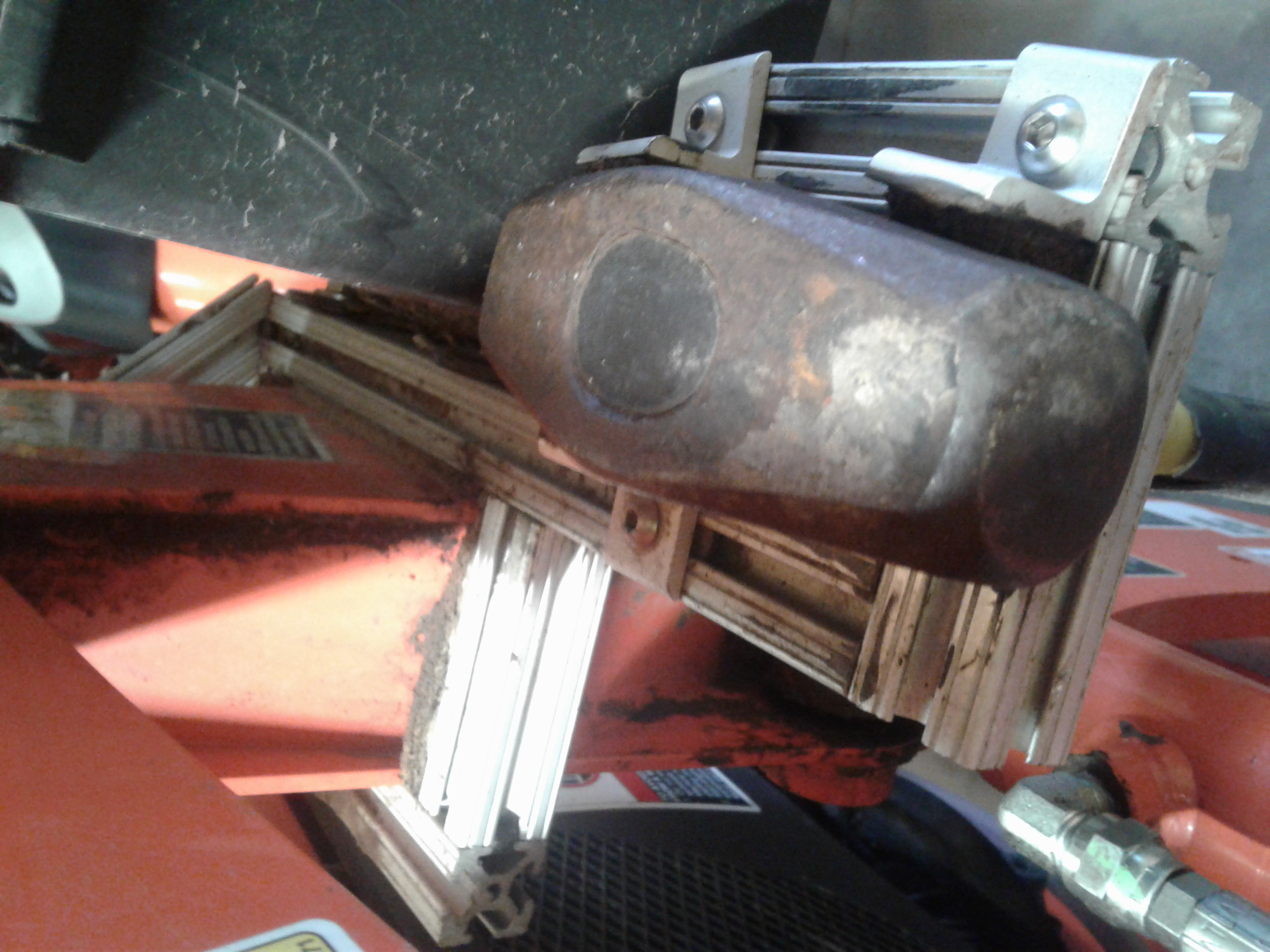

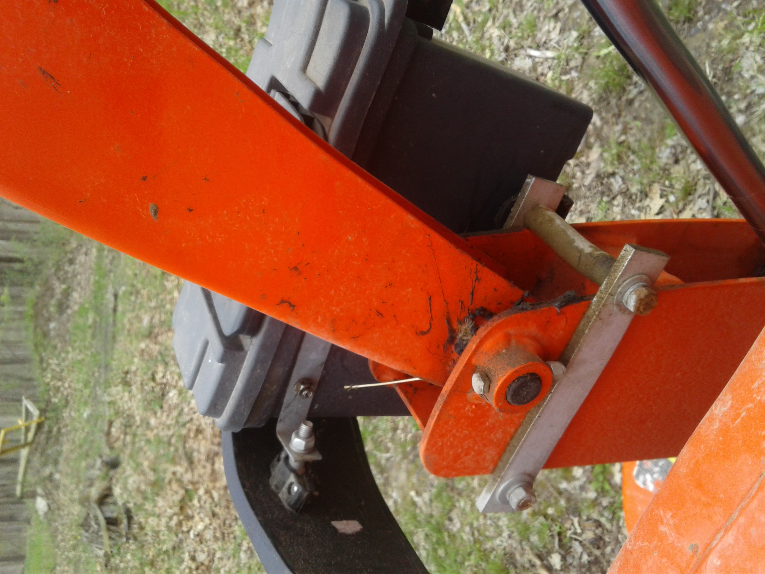

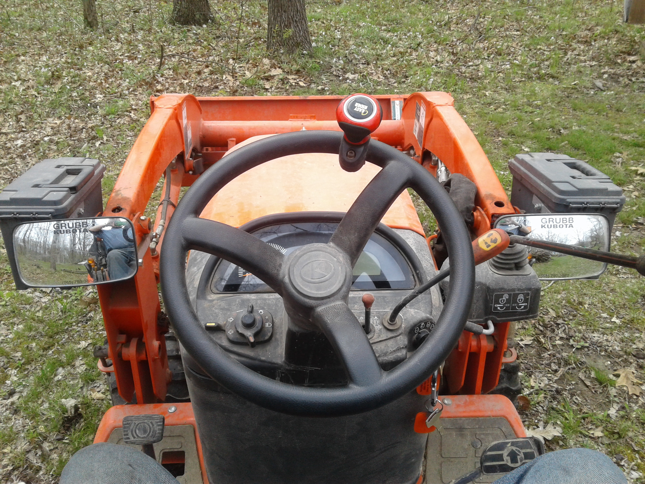

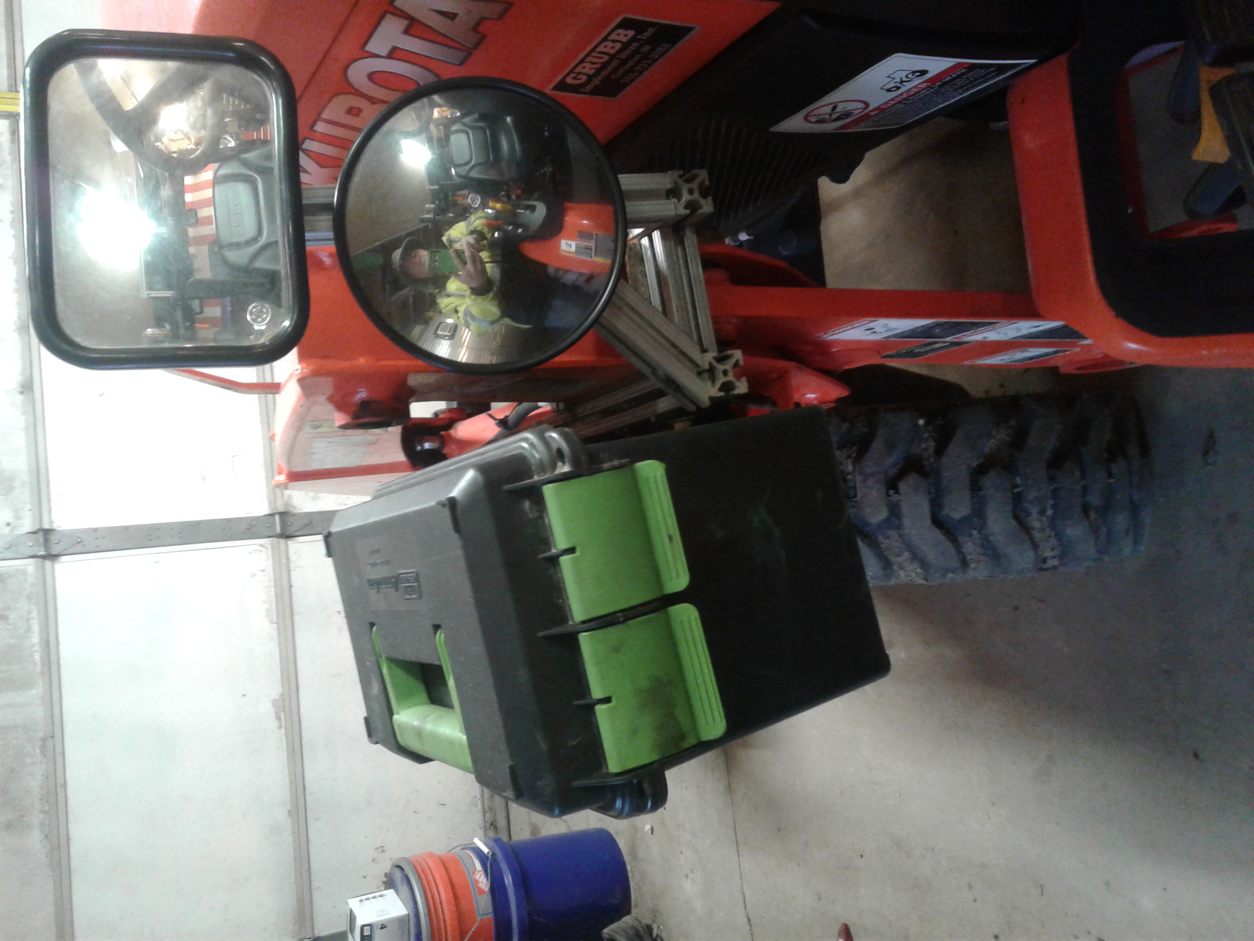

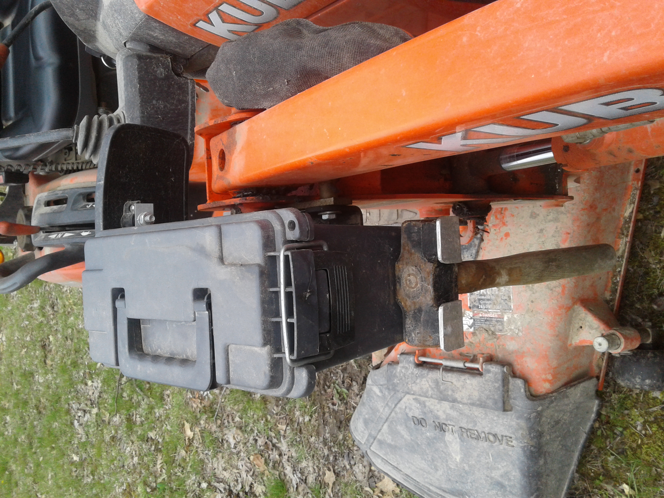

Do you have a close up photo of your mirrors, and how they are mounted? How's the visibility?
B2650 using 80/20 brand of extruded aluminum
BX2370 Using strap aluminum and tubing covered bolts (easier setup)
Double sided carpet tape and strips of cork to protect paint on loader.
These are what I used for toolbox mounts
ATV/Utility Winch Mounting Plate
The further out = better visibility
