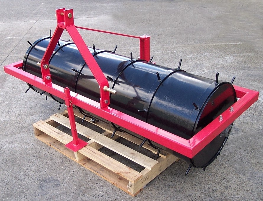

I have never heard of "rolling" the land so i would like to know more about that.
G'day Bill. A roller is a 'barrel' shaped implement, typically water filled or made from concrete that compacts the ground.
This is the one that I have (above); it's water filled & has aerating spikes that are on removable bolt-on bands. It fits my Cat 1, 3 point hitch (3PH) that my 41hp tractor, with R4 tyres can handle. Other designs can simply be towed.
Ask around your neighbourhood to see if there's someone who's got one & would be willing to roll your acreage for a negotiated price... or add this type of implement to your wish-list of toys for the tractor you decide on getting.
