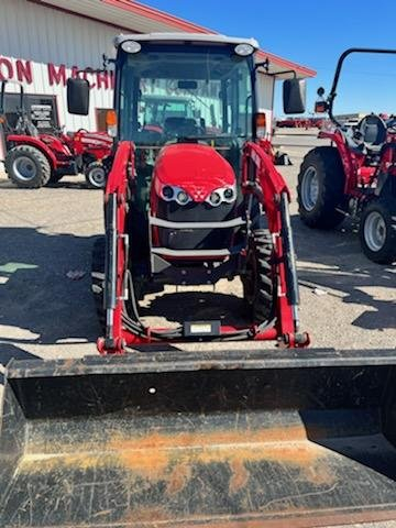

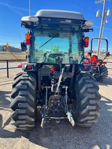

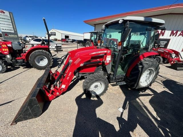

After more YouTube videos than I can count, reading around here until I went cross-eyed, visiting dealers, reading around on different brand FB groups, I made a final decision on a 2019 MF 1740M cab tractor with a Hydro trans. I found a clean used one with 730 hours on consignment at a equipment yard from a bank repo and was able to negotiate a deal for $8-9k under average market value. Since no one unit had all the features I ideally wanted, the massey had best compromise of features I felt.
I called my nearest MF dealer today to order the mid pto and front blower setup so that just maybe I'll see them for next winter. I'll be shocked if it shows up before December haha.
I'm not a huge fan of the ehydro operation of the trans, but I talked to 6 different dealers and not a single one ever had a tractor come in with electronic Hydro control issues. I couldn't find a single direct ehydro issue on the 1700/1800 series on the net either. So that seems to be a non issue and hopefully stays that way. I looked hard at another used 1740m that was a power shuttle trans, but I think that would make unloading logs substantially trickier than a hydro trans long term.
While the pto is electronically engaged, it does have a soft start mode which I didn't find on any other brand. It seems to be significantly more gentle then many YouTube videos of other brand's electronic pto engagements. The pto button on the rear fender will also be appreciated when running the forestry winch.
The turbo direct injection engine with common rail fueling and no dpf is a huge plus in my book. I'll be very curious to see how much different it performs running my pto chipper this spring vs my turbo 1620.
Only downside is the tractor is near Oklahoma city and I'm in northern Michigan haha. I have to deliver a customer car to Houston in late April, so on the way back I'll grab the tractor and bring it home! That should give me time to clean up my new hollands and get them listed/sold.

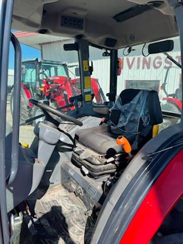

I hope I will be! I stopped at the dealer in OK on my way to california for family vacation and actually put eyes on it last week. It is very clean overall, interior is just dusty. Looks like it was mainly used for mowing as the loader joystick handle looks brand new for the 735 hours on it.
