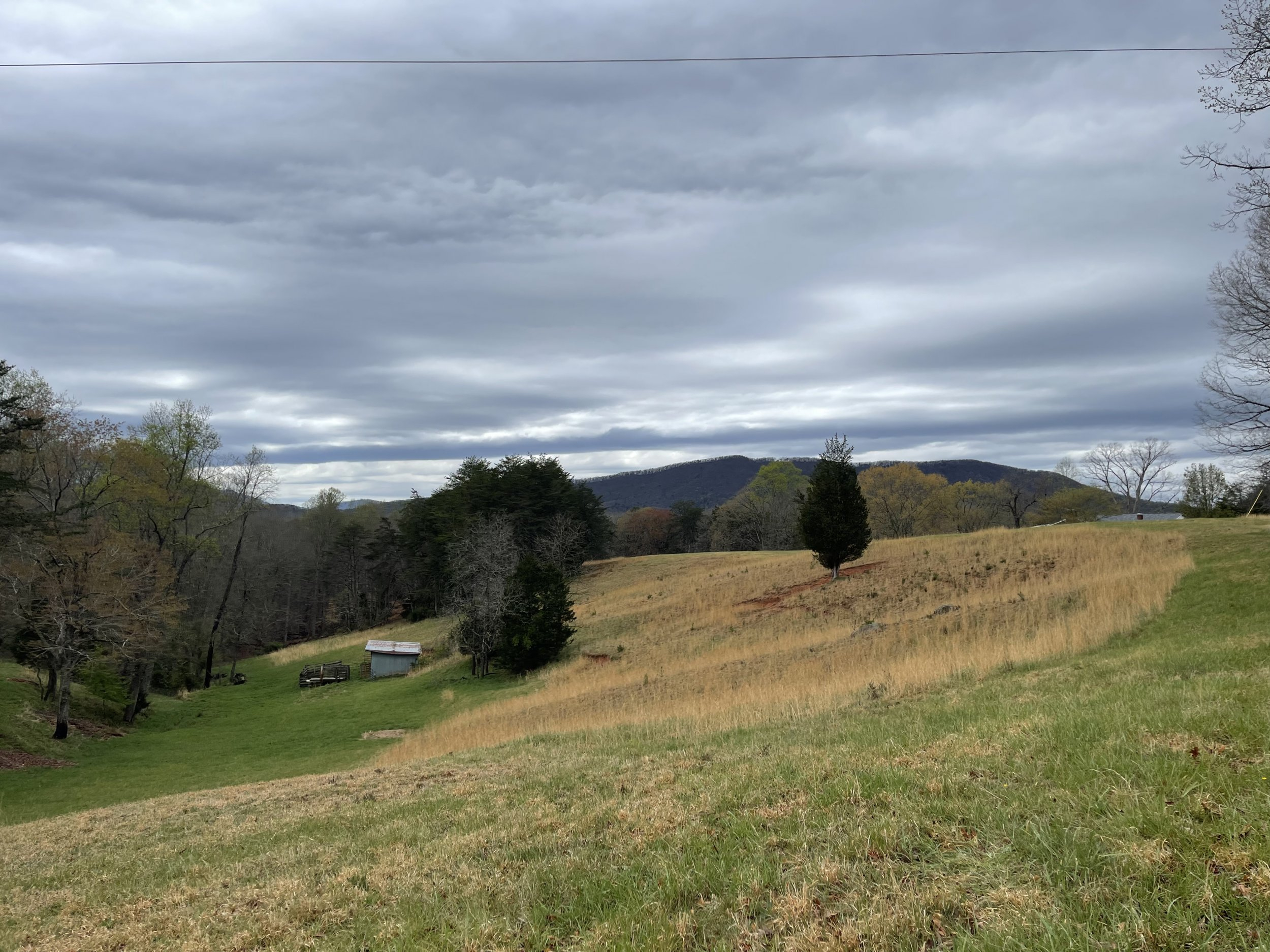

Twice a year, I mow a pasture that has sections with a near 20% slope. @ParkWhite suggested that you take time to practice. That's what I did.. After my 3rd mowing, I understood how to take the hills riding up/down rather than attempting to go across.
To help with the turns at the top, a FEL was added to the tractor to balance the weight of the 5' brush hog on the back. I learned that big wide circle turns is the way to go and if that cannot be done, then back down the hill. A tight turn tends to roll the tractor.
Slow is the answer on hills. This ain't no race to "gitter dun". Being alive when done mowing is a critical goal to me! It takes me 11-12 hours to mow this field.
And no, for this machine, I would not want a bigger brush hog.
A bigger tractor? Sure. But there is nothing wrong with this MF1533 for this job if one is willing to take it easy, choosing to live!

So my wife and I went back to the property Thursday, it is indeed very deceiving on the slope. The area with broom straw is likely not mowable with a normal tractor even up and down. Look at the scale from the barn to the top of the ridge. Topo maps show that as a 50’ difference.
I’m thinking now maybe a walk behind gravely or something similar. I trust my Kubota BX going up and down since it’s low to ground, but still want something larger for the flatter sections.
I know you are being cautious and think thats steep, but a commercial zero turn with bar tires would cut that easily. I cut steeper property with mine. I see the large rocks. Its the smaller more hidden rocks that get your blades.
Walk the property with orange snowplowing guides and mark all the rocks & obstacles you can find. Then set the deck up higher on the first couple cuts and proceed very cautiously. Might take 6 hours first time. I would cut that up & down, but if it really scares you, drive along the slope instead.
Before you know it, you’ll cut that in a couple hours with ease.
Just like everything else in life, unpredictability of the unknown adds a layer of fear & hesitation. Get yourself a diesel zero turn and slap a set of bar tires on it for that hill.
Now if you need a tractor because you have other chores, an older 35HP 4WD tractor with a 72” or larger mower and whatever other attachments you need will be able it, too. Probably want to go up/down the hill with a tractor if it has a narrow stance.
This would be a GREAT option for you. Its 1/2 tractor and 1/2 zero turn. Has better traction than a ZT but can handle more attachments and cut steep ground easily.
Love mine
You could cut the low and high parts of the meadow where its more level and do a controlled burn on the steep part. Very popular in my area.
