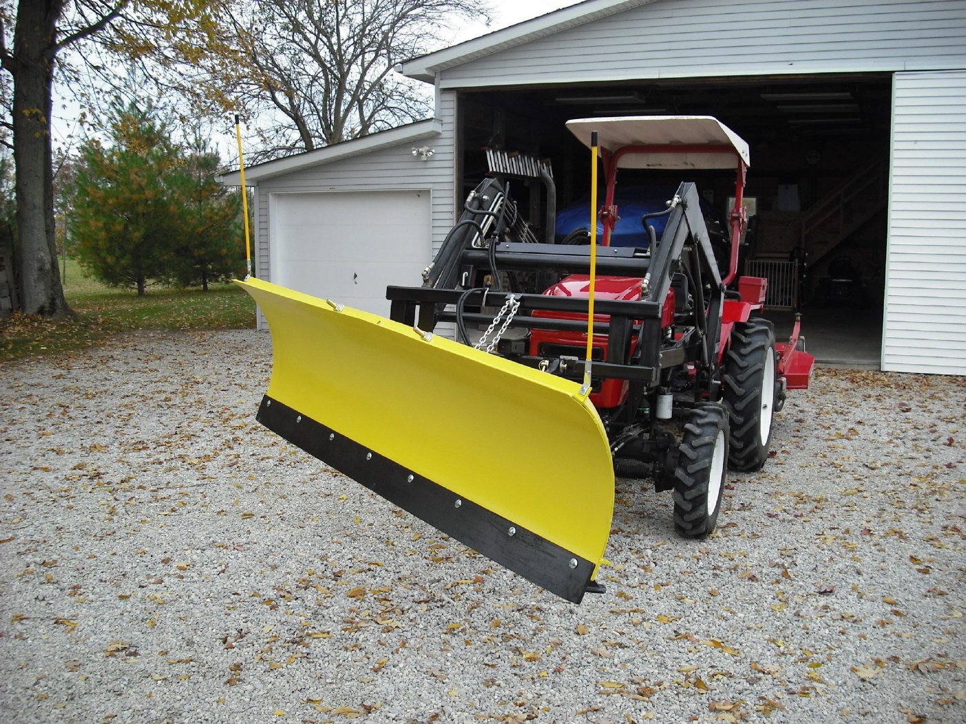

Biggest issue on old tractors and FEL's is no power steering. Very tough to steer with a load in the bucket. If you are looking for a cheap good tough simple tractor look at a Jinma 284. Same size and HP as a 8N but 4x4, just as simple but diesel with good hydros. I have one and have been very pleased. Bought it new with a FEL for under 10K.
Here is a pic of mine with my plow on in place of the the bucket on the FEL.
Chris
