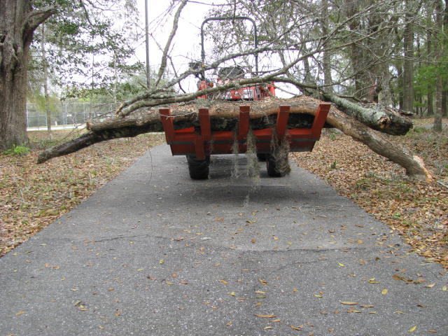

I have a Kubota B3300SU with 300 hours, which Kubota sells as a package including a front end loader, that most useful of tractor options. I think this package represents particularly good value. I also like the 14" ground clearance as I mostly tractor in the woods.
If you opt for a loader you need HST, 4-WD and industrial tires. An HST works at all engine speeds equally well. In my opinion Kubota is particularly well regarded for their HST transmissions.
As you compare tractors it is important to be sure they are similarly set up. When you are new to tractors it is difficult to understand the value of options to your tasks.
Take your time. Research. I concur with KYDan that good dealer support is more important than the tractor trademark. Make sure the Operator's Manual is written in understandable English, not pidgin.
LINK TO KUBOTA B3300SU:
