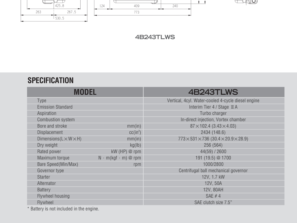

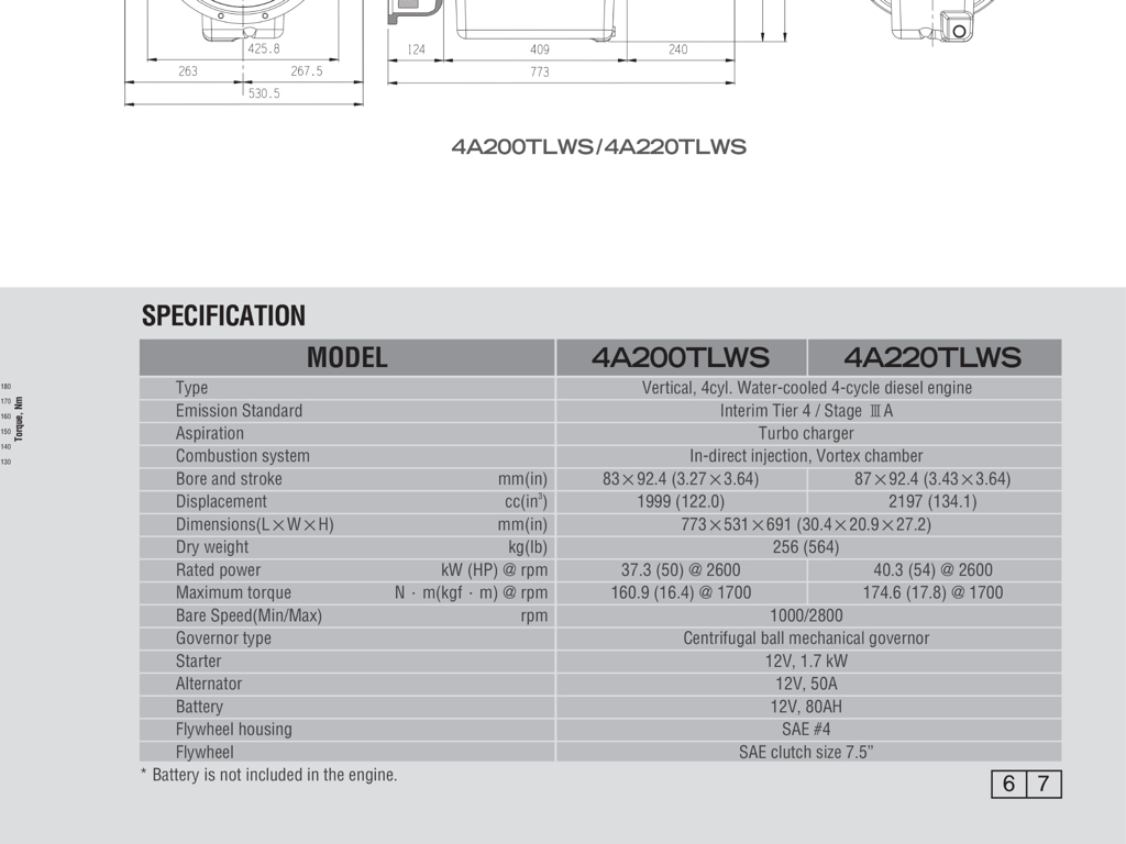

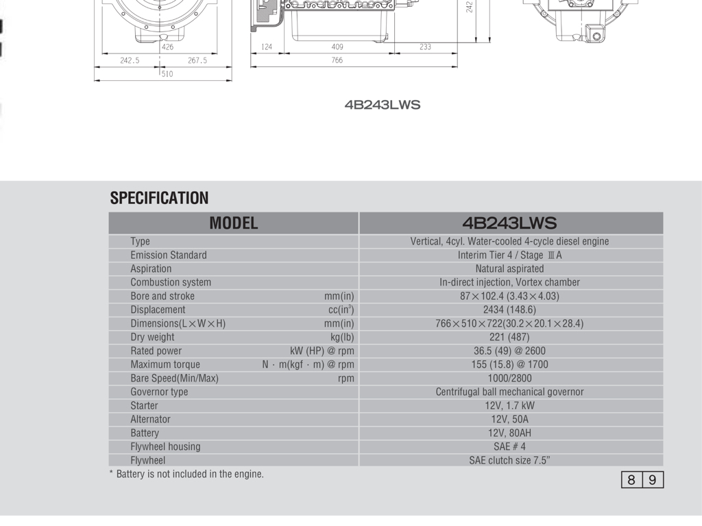

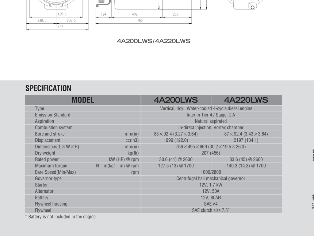

Seems to be some confusion here. The DK50 is exactly the same as the DK40 minus the turbo, the DK50SE is a different beast with a different engine.
The DK50 with the turbo 2.0 engine was made from 2001-2005 (4A200T)
My Bobcat is basically the same as the DK40SE, which has been made since 2007 with the naturally aspirated 2.0 (4A200)
This engine was used in several other tractors as well, Mahindras, TYMs, and Cub Cadet that I know of.
See my attached documents of the two enginesView attachment 4A200_spec.pdfView attachment 4A200T_spec.pdf
