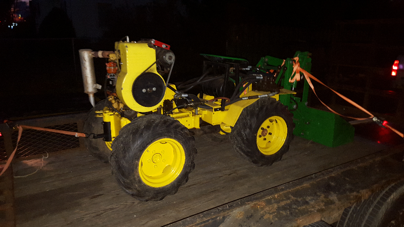

So I bought mini trencher that was striped to frame and turned into a mini loader. But I'll wondering what type of hydraulic system it runs
This is how it goes - pump to 1# 2 spool valve but then the outlet side feeds to 2# 2 spool valve. Then the outlet from the 2# goes to the tank
Next question. The pump is spinning backwards. Will that hurt it?? Seems to be fine.
Please no harsh/mean insults about the guy who built it. He's really smart when he designed this and built it and everything is great on the tractor so far except a leak by the pump and me breaking 2 welds from doing beyond what the tractor was made for abs digging up a sewage line in Clay ground

Not enough info to really say. I am guessing it is a open center hydraulic system and the first valve has a power beyond valve that is letting fluid flow to second valve. The first valve should have a return to tank line also. If it is plumbed directly from the return side of the valve to the second valve, and the first valve is not PB equipped, then it is plumbed wrong. You diagram does not show a return to tank on the first valve. So something is wrong right there. first valve should have inlet, A and b ports, Return and PB. second valve should have inlet, A and B ports, Return. If the second valve is also PB, the PB port could be plugged as long as the PB conversion plug is removed also. If PB conversion plug is not removed, then the return port and the PB port should be tee'd together to provide flow back to tank. Return port of first vavle can also be tee'd to return port of second valve before going to tank. If hydraulic system is a closed center system, there still would be a return to tank on the first valve, and again, your diagram doesnt show this.
   / what type if hydraulic system does my rig run? ? #3
Some pumps can turn cw or cc so I would say you are ok there. muddstopper has said the way it should be done. I don't agree all the way on the out of the 2nd valve about teeing the bp fitting and work ports out together. Just remove the pb fitting then tee it into 1st valve return line then plug the work port out. Right now you have no pb fitting in eather valve and it is putting back psi on the 1st valve. That could blow the spools seals out of the 1st valve. It well work the way it is but should be done like muddstopper said and get the back psi off of the 1st valve. Some people has said it would blow the 1st valve apart, but I have a hard time with that. People do it the way you have it now all the time.

In an open center system, the pump is always pumping flow to the control valve and back to tank. A closed Ceneter system, fliud does not flow thru the valve until the valve is activated. A closed center pump is usually a variable displacement type pump. The pump itself is load sensing (sometimes internal and sometimes external),and pumps on demand. In an open center system, the pump is always pumping oil to the system.
The attachment that LeeJohn provided is a pdf file, you might have to download the free adobe software to view it. The diagram is the correct way to plumb two valves using a PB circuit.
LeeJohn, I did not say to plumb the work ports to the PB port. Not sure how you interpeted what I said to believe I said what you said I said. With out a pb port, the work ports return to tank internally and out thru the return port. With PB, the work ports return to tank internally and then thru the tank port, back to tank. Inlet oil continues on thru the valve, to the Pb port, and to the inlet port of the second valve. Returning oil from the work ports does not mix with the oil passing thru the PB. With a PB type valve, the PB port can be used as a return to tank port as long as the conversion plug is removed from the control valve. If the conversion plug is left in place, and you do not have any other valves down stream of oil flow, you can tee the Out Port to the PB port and just run one line to tank. you can also Tee the return line from the first valve to the return line of the second valvee before running the lines to tank. A lot of the times, you can also Leave the PB conversion plug installed in the valve and plug the PB port to convert the open center valve/with PB to a Closed center valve.
While it would seem that the two valves in the diagram are plumbed using the out port of first valve to provide flow for the inlet port of the second valve, this can work, but care must be taken to not allow pressure to get to a high pressure situation. The return ports of any valve is considered a low pressure port. Not sure what the save allowable limits are for a low pressure port, some say 500psi, but I dont now how accurate that is. At any rate, exceeding the low pressure limit can cause the control valve to crack or burst. any body connecting two valves together using the low pressure return port is just asking for trouble, if the pressure of the second valve is capable of exceeding the low pressure limit of the first valve return port, its not a matter of will it blow, but just how long before it does blow. Spool seals are not what you have to worry about, instead its the valve body itself blowing apart.

This is why I said that. If PB conversion plug is not removed, then the return port and the PB port should be tee'd together to provide flow back to tank. All I wanted to say was why do it that way , when all you have to do is just remove the pb fitting. You didn't say how I said it, I should of said work ports "out" port.

You are right, if you remove the pb conversion plug, and then cap the PB port, no need for a tee. You can just run a line from "out" back to tank or you can use the PB port as a return to tank. Only if you do not remove the PB conversion plug would you need to tee the out and PB before returning to tank. Unless of course the valve is being used as a closed center valve, then you would keep the pb conversion plug installed and also cap the PB port.

Sorry about not earlier replying bit the tractor don't have a PB valve. Just a regular valve. No problems yet with valves but that leads to my next question.
Didn't want to start a new thread yet. The tractor is driven by hydraulic motor to the rear end then a shaft the front for full time 4X4. But it is extremely slow. Walking speed and don't have alot of power. When going into a dirt pile it will lose power and stop and has a you are lucky is you can craw over a 4by4 block of wood with bucket 1/2 full.
Is there any way to make it go faster and have better power with the current hydraulic motor or does it need a better motor. If it does I can get info off it and see if you guys got a suggestion for a upgrade? ?

Hydraulic motor HP is determined by the torque and speed.
If the motor is working at full potential, it should do the intended job.
If the pressure is not developed by the motor and GPM's lacking, then the motor can not work to full potential.
Could be due to a weak pump , worn motor, or leakage somewhere else.
You need to do a flow and pressure test.
