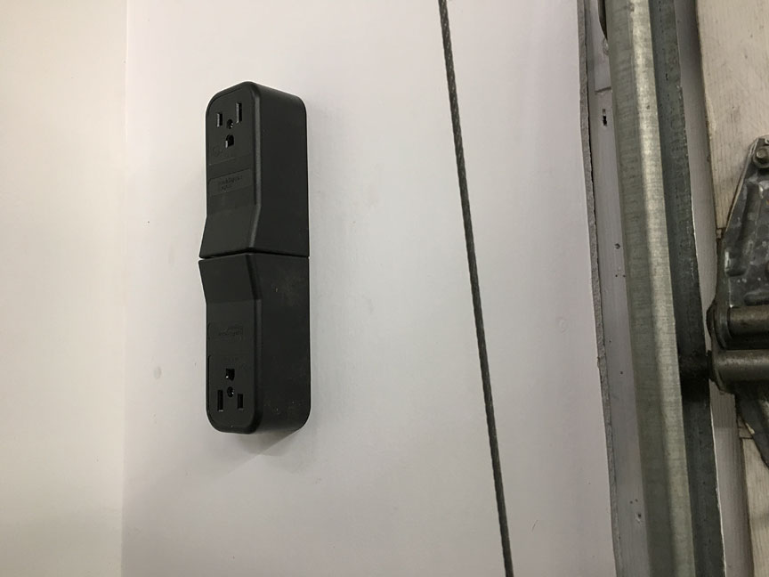

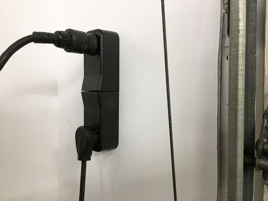

I have a TIG and a MIG. I got tired of unplugging. I did it like this.
563058d1531807024-what-type-220v-outlet-img_2529-jpg
563057d1531807024-what-type-220v-outlet-img_2528-jpg
Someday I will weld TIG with my right hand cuz I'm right handed. While at the same time running the MIG with my left (cuz MIG is easier). That way I can get my welding done without exceeding the duty cycles and of course the horrible, and frequent PITA of wasting time while the machine cools down.
:laughing:
:laughing:
Yeah but it's real nice to NO longer have to plug & unplug welders.
:laughing:
:laughing:
