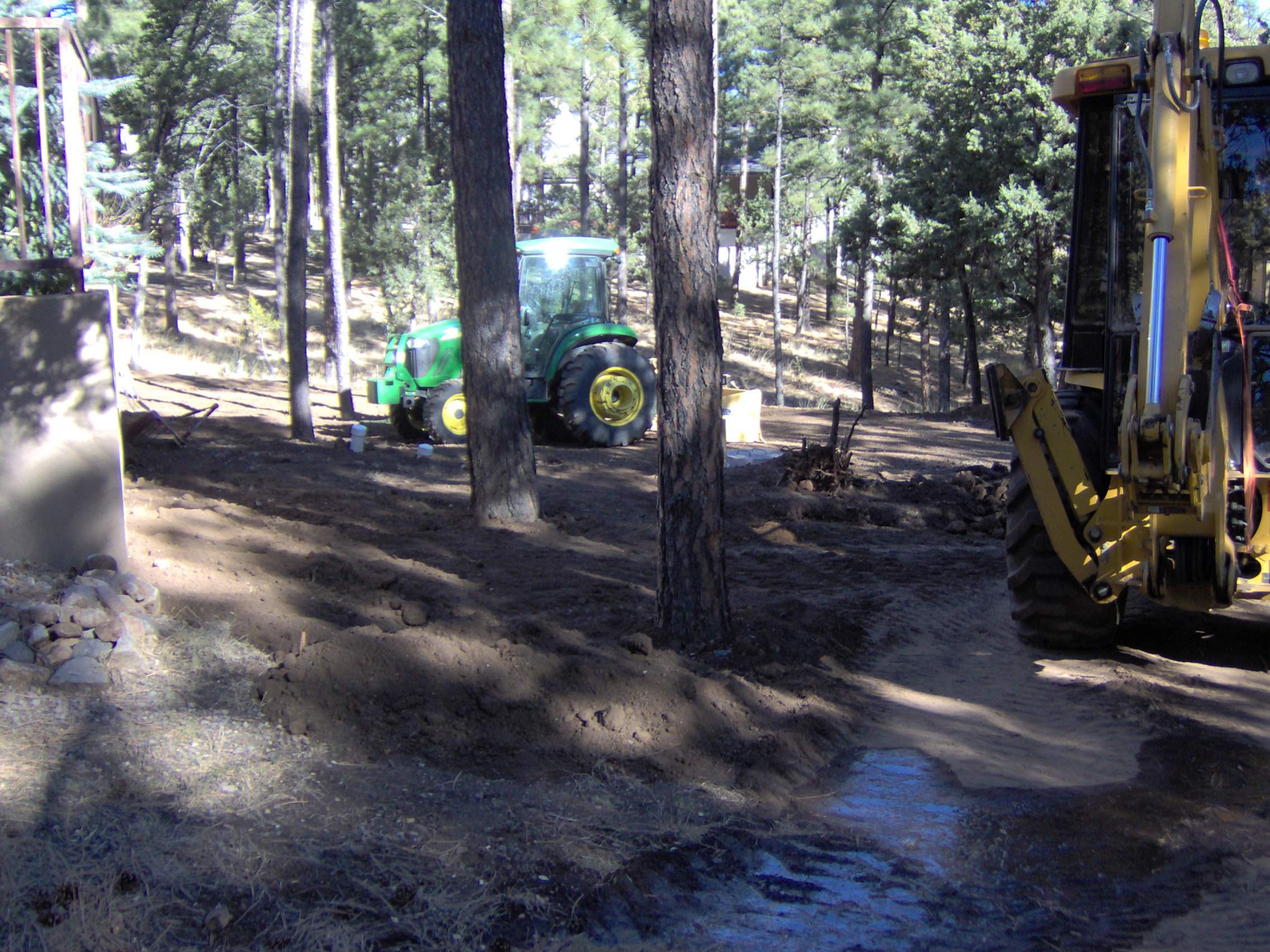

swick1,
How about a Kubota K008? Thirty two inches wide, fits thru the doorways. I agree there are limitations in close quarters. I can see your point about urban areas, just another reason to stay out of such places. Working in this yard wasn't a picnic either, the cleared area in the middle is where the septic tank is.
