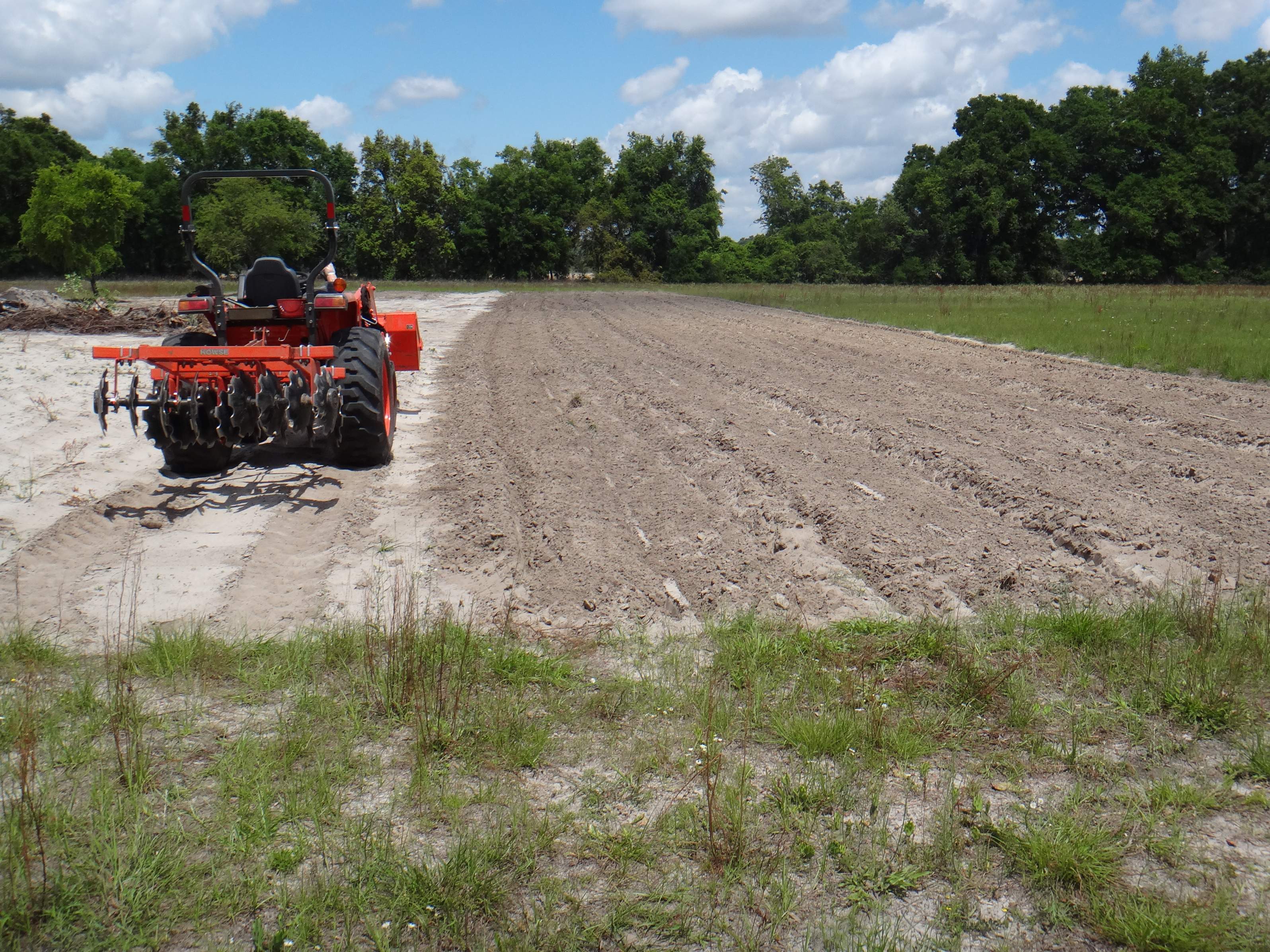

Five miles per hours is about right. Looking to the rear, you should observe soil being flung outwards my the front gangs and gathered inward by the rear gangs, pretty vigorously. You may have a pretty rough ride the first pass. Fasten your safety belt.
I use HST/MED and full throttle on my tractor/disc combination.
PHOTO: Notice the feathered left edge, past the faint furrow made by the outboard disc pan. That is soil thrown out by the forward gang. Though the rear, gathering, gang is wider than the front gang, it is set less aggressively to smooth.
A Box Frame Disc Harrow with 18" diameter pans is about the lightest Disc Harrow which will cut and mix soil properly; 20" diameter disc pans are better.
((A Box Frame Disc Harrow with 18" diameter pans will apply about 38 pounds of pressure to each pan. A Box Frame Disc Harrow with 20" diameter pans will apply about 50 pounds of pressure to each pan.))
DISC HARROW ADJUSTMENT: http://www.tractorbynet.com/forums/...ing-three-point-hitch-mounted.html?highlight=
