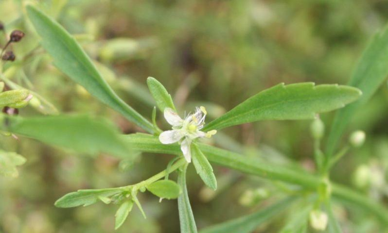

How far a gallon goes depends on lots of things; how wide a strip you are spraying and how heavily you apply it. The recommend rate is on the container, but as an example for glyphosate (Roundup(tm)) from the Pioneer websites
  • The standard rate of glyphosate is 0.75 lb acid equivalent per acre. The rate should be increased to 1.13 for weed height ranging from 6 to 12 inches and to 1.50 for weeds > 12 inches tall.
Sorry if it was the wrong weed. This one, perhaps, also known as licorice weed?
If it is licorice weed, you might have something you can sell...
All the best,
Peter
