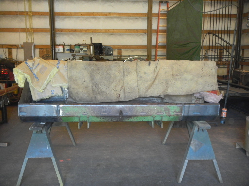

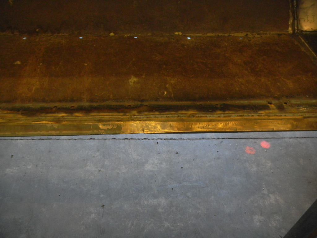

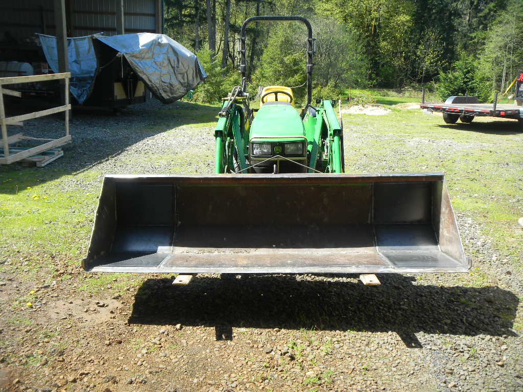

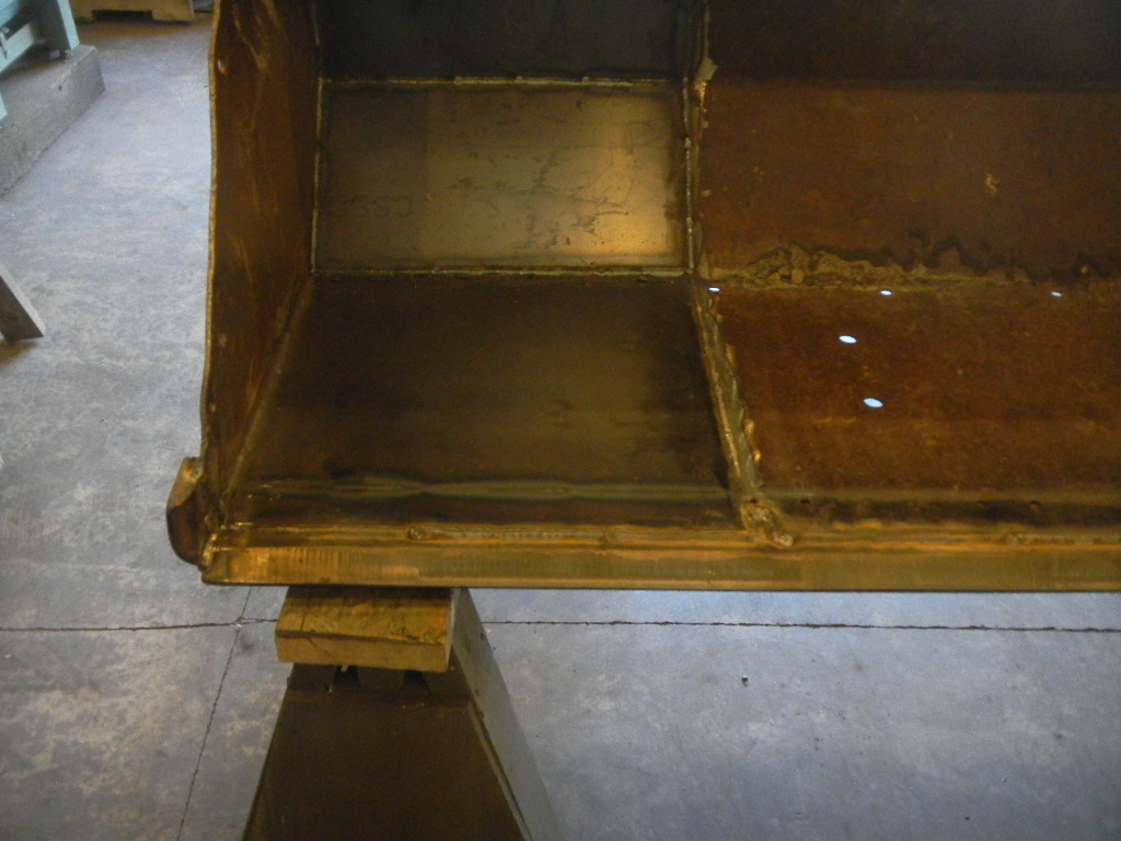

The last one I did for a buddy. I wrapped it in house insulation, and a welding blanket.

Do you ever use any product like the paste type heat dam?
Nice home kit type (cheap!) of slowing the heat loss.
Low preheat? Perhaps 200 or 300 degrees?
   / What type of steel? #13
Last time I used the paste type heat dam was in the 1970s, when I worked in a fab shop.
2 to 300-degrees should be fine, just don't go overboard with pre-heat.
Here's a good video, shows how wear strips are installed.
AR400 Steel Welding on a Backhoe Bucket
   / What type of steel? #14
Use 7018 and some preheat and you should be fine. Some people get the idea that peening means beating the heck out of the weld. That can add more stress. For a cutting edge, I'd just skip weld it and then go back and fill in between the welds.
