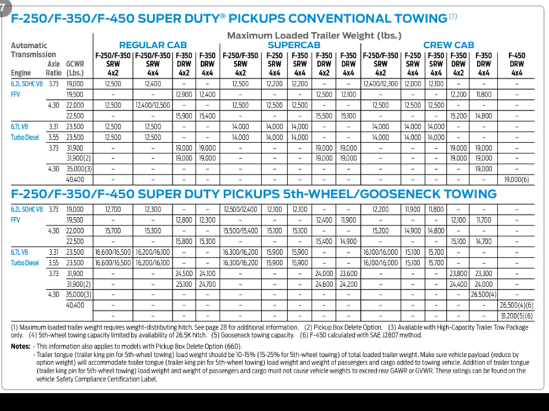

ZAR2USA
Sep 24, 2012
222
Using the Ford table, with a ......2015
CREWCAB
F-350
SRW
4x4
6.7L V8
Turbo Diesel
1) What is the maximum legal trailer weight for conventional towing (14'000 lbs) with weight distribution?!
2) What is the maximum legal trailer weight for fifth wheel/gooseneck (15'700 lbs) ?!
3) I realize that the tongue weight for conventional towing is 10-15% of trailer weight! and 15-25% for fifth wheel towing. That being said, does that mean that I can actually pull trailers heavier than the "maximum loaded trailer weights", since 10-15/15-25% of the weight is transferred to the truck?!
4) What would be my new "maximum loaded trailer weights" that I could then legally tow?!

Correct. Your trucks GCWR is 23,500. The tow rating is obtained by subtracting the trucks empty weight from that value. So they obtained 15,700# by taking the trucks weight of 7,800# from its GCWR.
The 14,000# BP rating is obtained by what the manufacturer deems safe.

1) I am wrong then in my calculations to take 15,700 x 0.25 (percentage max for fifth wheel weight on Kingpin) = 3'925 lbs,
and ad the original 15,700 for a maximum of 19,625 lbs of trailer loaded weight, since I would exceed GCWR ?!
2) I also could not used this calculation method for conventional towing, correct ?!
3) When is this method of calculation used ?!

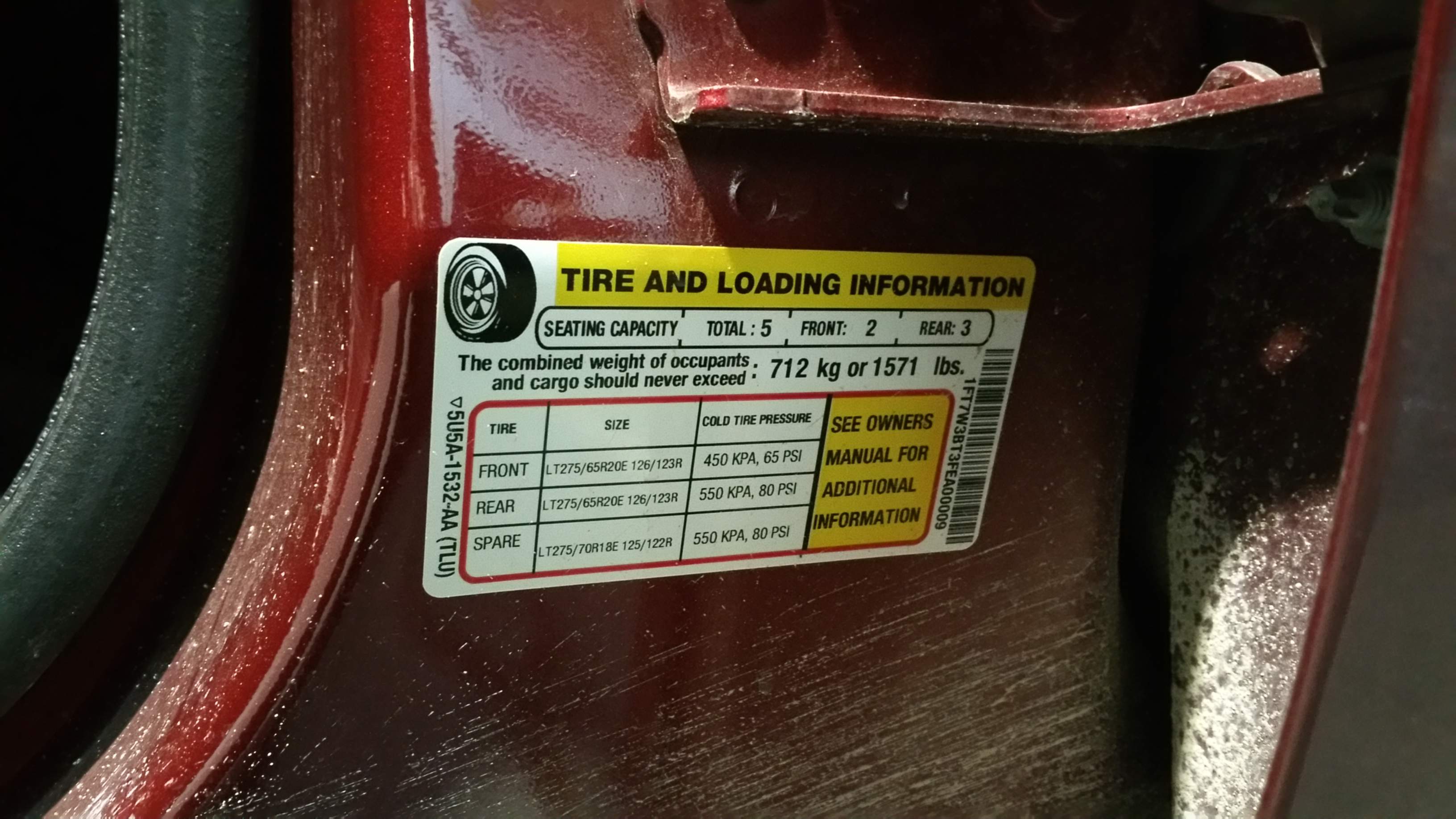

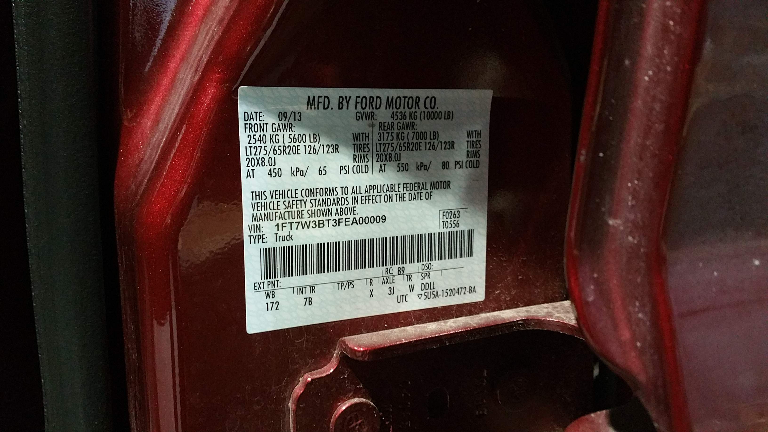

I just looked at an F350 Lariat CC, 4x4, standard bed, 6.7PS, SRW as a possible tug for a fifth wheel. The one thing these published charts typically do not show is a configured truck's maximum payload numbers. When I am out looking, I take a picture of the manufacture's placard that states this number. The Ford's I've looked at to date are light compared to the RAM or GM 3500 offerings. To get the payload needed for a fifth wheel I need to move up to a F450 which only comes with DRW, an option I do not want. Here are the placards of the F350 I looked at;
The placards numbers would say no to your 5th wheel and a bumper mount trailer would be pushing the maximum payload number. It seems to me the 2500 offerings and Ford's 3500 can pull weight but can't take much of the tongue or fifth wheel weight. If I am reading something wrong please advise.

1 - You are calculating the pin weight of the fifth wheel and this number is not used to calculate the GCWR, it is used against the vehicle's maximum payload (driver door's placard). The GCWR is the number a scale would show for the truck and trailer, loaded, as being driven. You want the GCWR to be lower than the GVWR which is the number the manufacture states as being the maximum weight of the vehicle loaded and what ever it is towing.

Yes, can't do that. Max GCWR is an absolute max but you must also no exceed the trucks GVWR, any individual axle, or tires.
View attachment 404493View attachment 404495View attachment 404494
The F-350 you are looking at has been neutered and only has a GVWR of 10000 lbs. The F-350 has multiple GVWR ratings for the SRW. You need to find one that has the higher GVWR rating of 11400. That would give you close to 3000 lbs of payload. Also look for 18" wheel instead of the 20" and that will save you another 100 or so pounds. the option weights add up quickly. My 2014 F350 Lariat (6.7L Crew Cab Short Box 4x4) has a payload of 3260 pounds.
