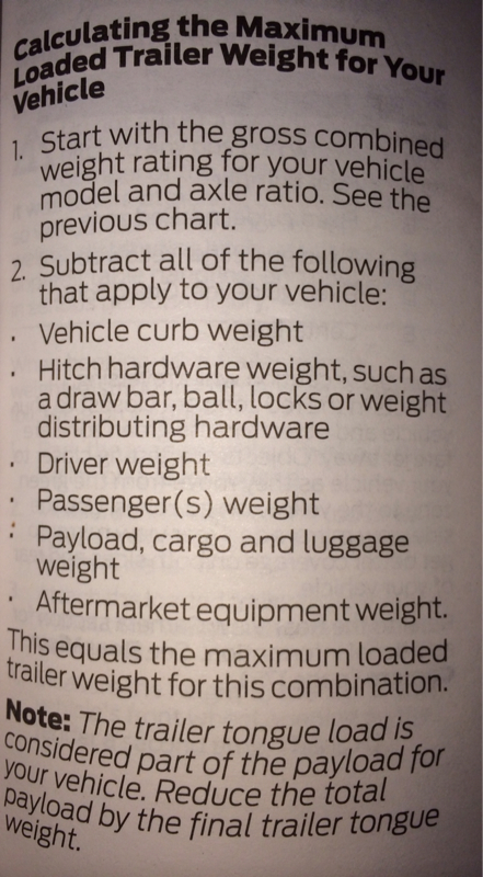

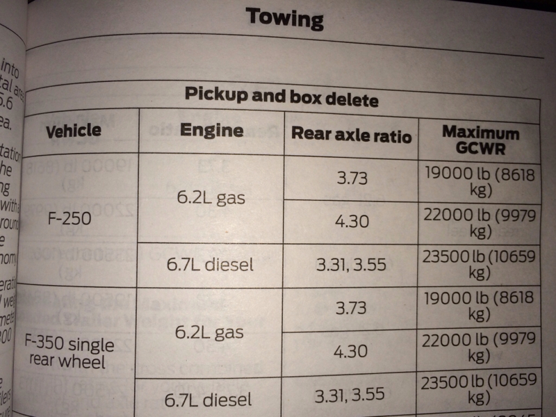

Correct. Your trucks GCWR is 23,500. The tow rating is obtained by subtracting the trucks empty weight from that value. So they obtained 15,700# by taking the trucks weight of 7,800# from its GCWR. The 14,000# BP rating is obtained by what the manufacturer deems safe. Chris

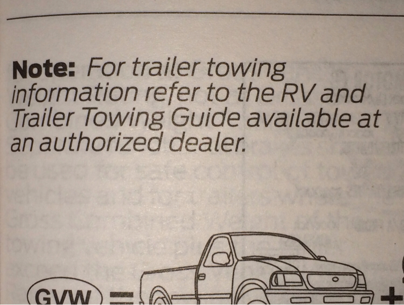

Chris I did as you and others have said, went to the owners manual and found this. It match the door sticker for GCWR.
I was surprised to see how well the bullet points were laid out by Ford in determining maximum trailer weight;
Fords calculations for the limits imposed;

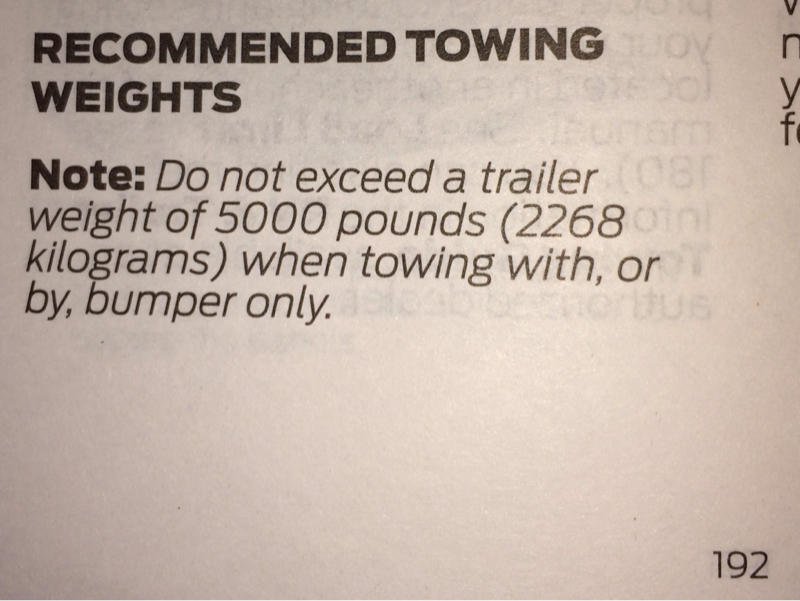

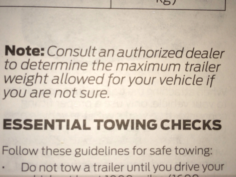

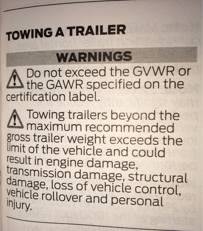

I found the following confusing and oxymoron.
<img src="http://www.tractorbynet.com/forums/attachment.php?attachmentid=404900"/>
<img src="http://www.tractorbynet.com/forums/attachment.php?attachmentid=404902"/>
<img src="http://www.tractorbynet.com/forums/attachment.php?attachmentid=404904"/>
<img src="http://www.tractorbynet.com/forums/attachment.php?attachmentid=404908"/>
<img src="http://www.tractorbynet.com/forums/attachment.php?attachmentid=404909"/>
<img src="http://www.tractorbynet.com/forums/attachment.php?attachmentid=404910"/>

They should also have a table showing max weight with each hitch type.

I did not read many responses to this but lets get this out on the table- manufacture ratings other than vehicle curb weight and axle capacities have no place when it comes to a DOT inspection or highway stop.
Ask any OTR trucker, DOT watches tire ratings, axle weights, and GCVW (Truck and Trailer combined).
Stay under axle weight ratings and under 26,000 gross, 26,001+ is grounds for Class A when towing a trailer over 10,000. 10k truck, 16k room for trailer= 26,000 GCVW. This is how lots of hot shot trucks run on class C licenses. Stay under 26,000 GCVW and you avoid the hassle of Class A.
Further more, payload is calculated by adding GAWR (gross axle weight rating, comprised of GFAWR and GRAWR (gross front and rear axle rating) and then subtracting the vehicles curb weight from it. 10k combined axle rating, 7k curb weight, equates to 3k payload.
