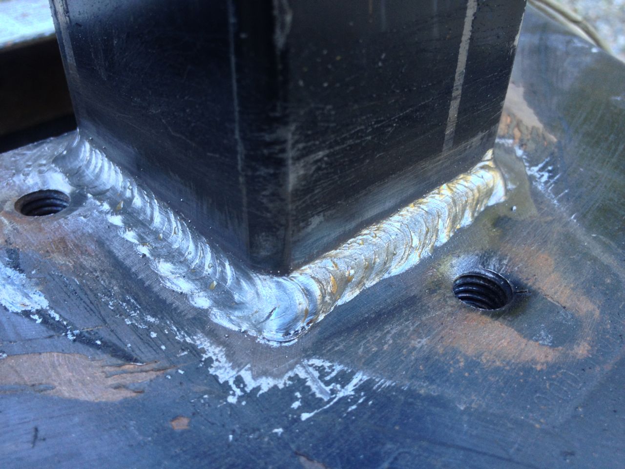

I know it has probably been talked about before but I asking again. I have a standard stick welder(big, not portable), if I were to replace it what would you suggest? Inverter? Mig? or what? I mainly use it for RHS up to about 3-4mm thick (don't know the conversion).
You didn't say how much experience "you" have at fabrication thus far. If you post a couple example projects you have done it will be easier to guess what your level of experience is. And your project scale.

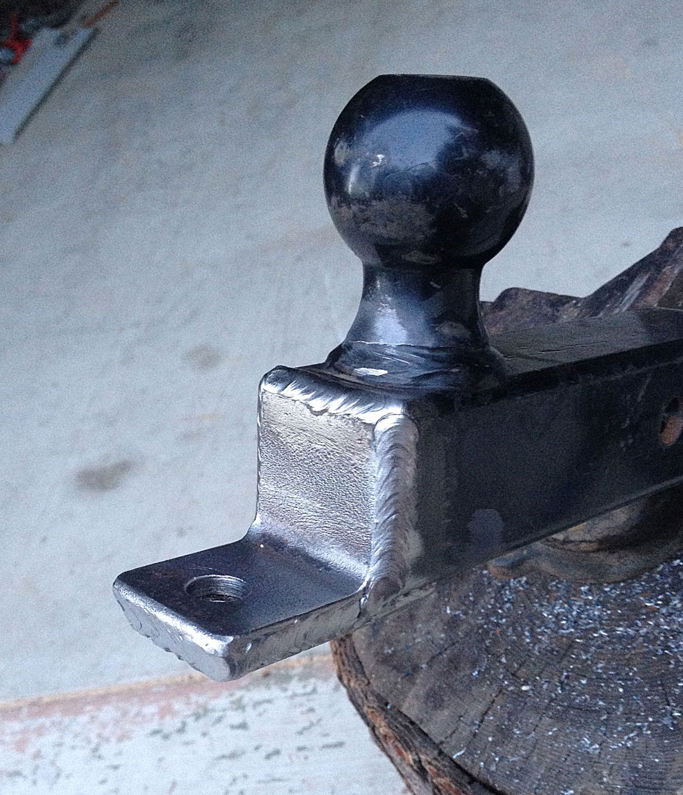

Here's a pic of 1/8" RHS welded to 3/16" plate (3mm RHS welded to 5mm plate) using 120v. With 220v, "you" should be able to weld double that thickness.

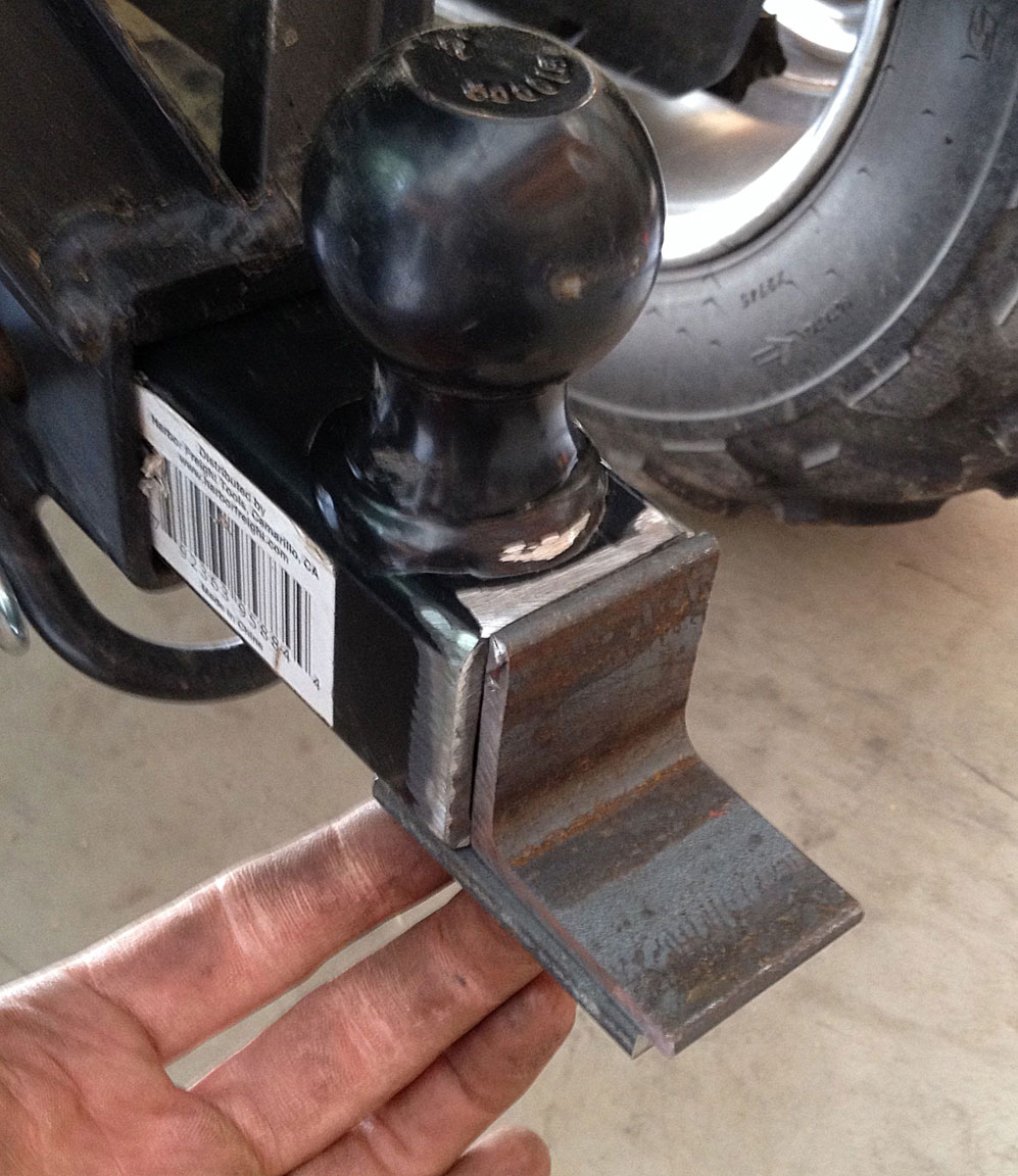

These are a little thicker, 3/16" & 1/4" thickness (5mm to 7mm) and welded with 120v too. Maybe you can make assumptions regarding 220v capability based on these simple 120v examples.
Sorry I can't guess what a $500 welder will do for you. I've never tried one. I have a Miller MIG that's rated for up to 10mm (on 220v) but some folks say I could have bought a better machine for a lot less $$$ than Miller. I'm curious but I just weld with what I have, which just might last me longer than I will be welding.
Just a note, the OP is in Australia and they have 50hz 240VAC power (like in Europe), 120VAC is not available there.
