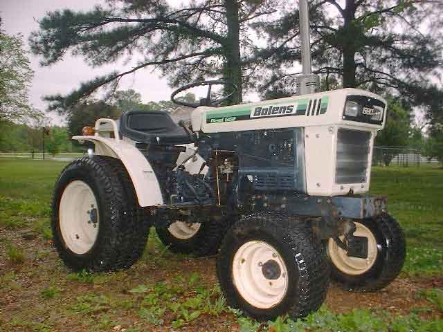

With those turf tires you might consider chains. I used a Bolens G152 (attached picture) that had turfs and a 4ft box with great success without chains. Mine had wide turfs and on bare dirt they grpped pretty good. Greatrandinin has a good point about the rear scoop, I think they can be had for about $150. It is not a replacement for the box, but it will help you in relocated all the dirt you scrap up with the box. You should be able to find a regular 4ft heavy duty box that would work with your 2210. Turn the lift pins to the inside if lift arm spread is a concern. Like you said, you could go with a 5ft and not engage one of the scarifers.

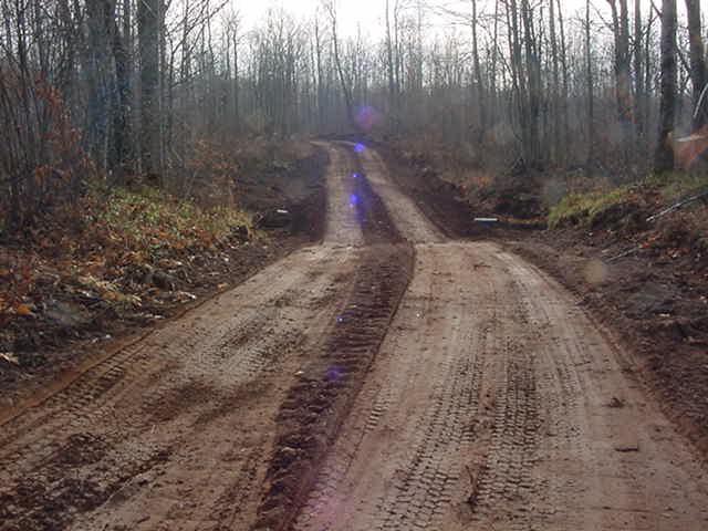

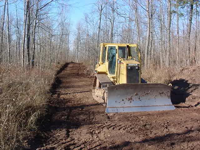

Went through somewhat the same thought process last fall, building a woods road. Ended up hiring a contractor and he did in a few days what would have taken me several weeks and probably months. I'll do the finishing work this summer with my L3130. Picture of project and rented dozer attached.
penokee /forums/images/graemlins/smile.gif
   / What will fix my yard? -- Pictures #20
one more pic.
