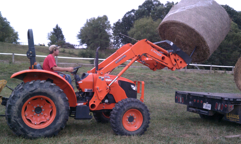

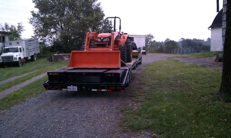

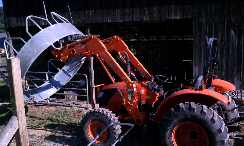

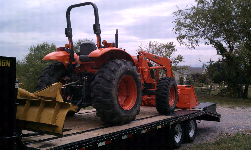

I was all set to buy a Kioti DK40SE with HST, but I ended up buying a used Kubota M6040 with hydraulic shuttle instead. I found it listed for sale not too far away at a good price, and I couldn't resist. I have had the tractor since Saturday and have been able to put in a few hours of seat time, mostly grading driveways and around barns with an 8' scraper blade and the front end loader. We tried out the bale spear as well. So far I am very impressed with the power and ease of use of the tractor. I couldn't be happier. Tomorrow I will pick up a 7' Kodiak rotary cutter, and this weekend I hope to start mowing about 20 acres at my inlaws, most of which hasn't been touched since last summer.
