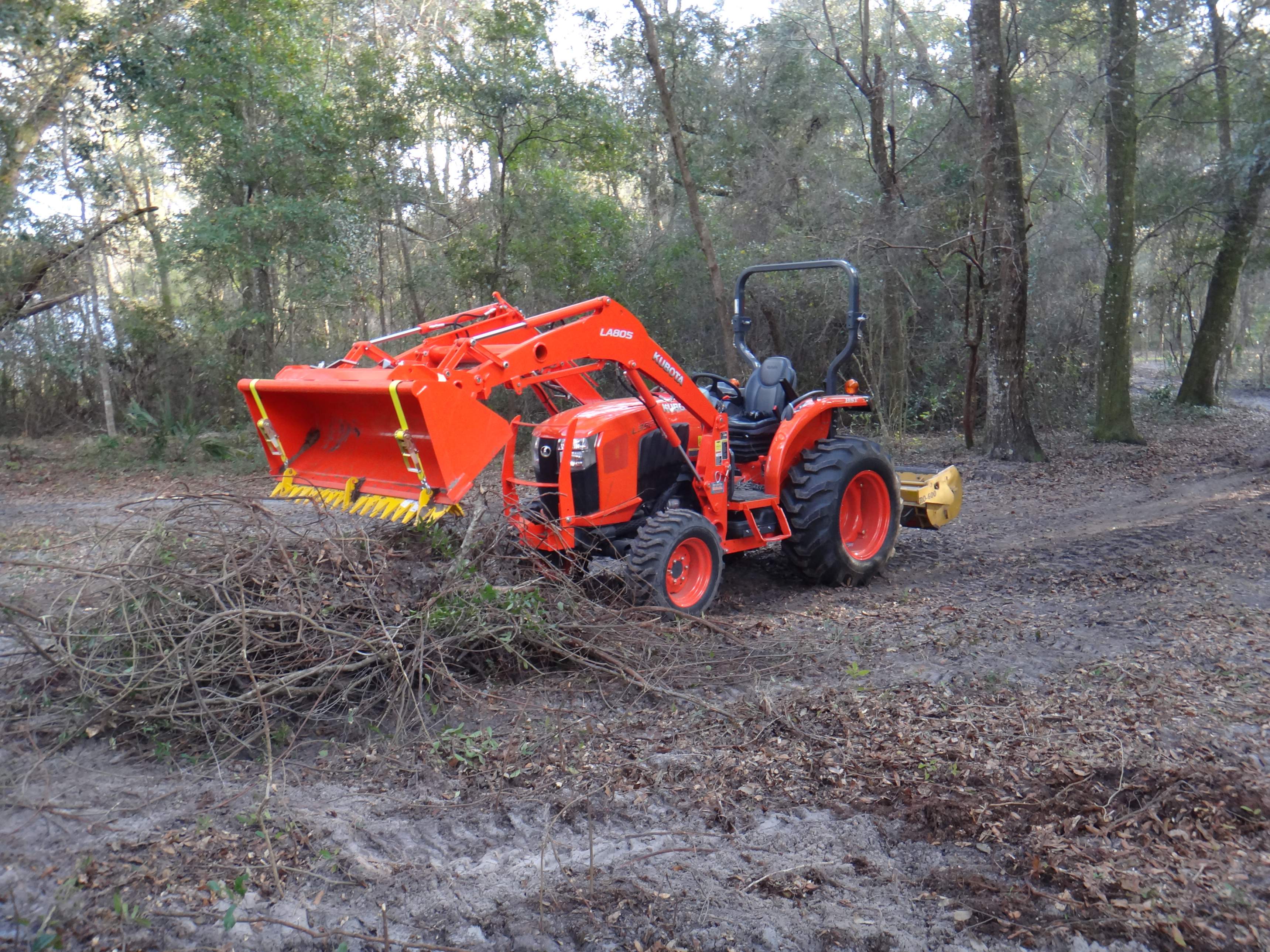

Your LS XG3025 is a nice, heavy tractor @ 2,400 pounds which will make it quite capable for ground contact work.
However, at 80.4 cubic inches engine displacement it will only "fair" at PTO powered implement work. I would search for a heavy duty 48" Rotary Cutter rather than a light duty 60" cutter. For clearing brush, a heavy duty 48" Rotary Cutter, if there is such an implement, may last. A 60" Rotary Cutter behind a 25-horsepower tractor is for grass only.

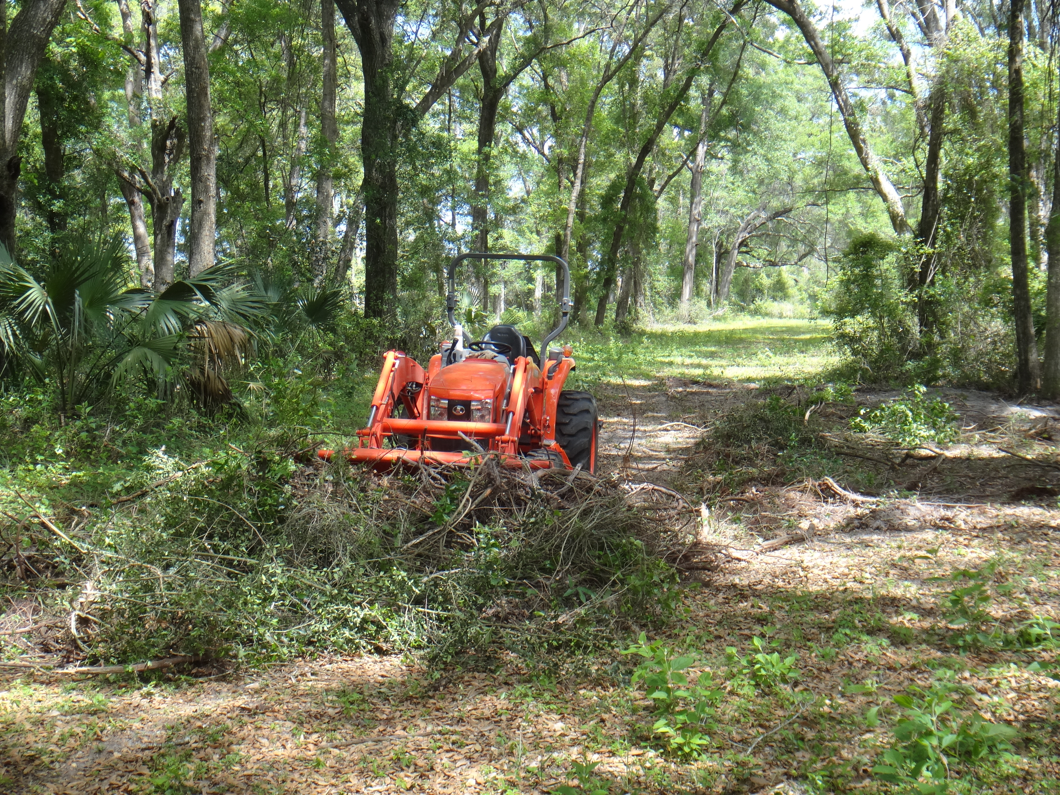

I pulled a King Kutter (brand) 48" Rotary Cutter behind my 25-horsepower Kubota B3300SU and it was completely reliable shredding brush lying on the ground.
If you knock down the brush first, before shredding, it is much easier on your Rotary Cutter. Consider a Ratchet Rake bucket attachment.
VIDEO: ratchet rake brush clearing - YouTube
Ratchet Rake is good for minor grading, leveling and light road maintenance. Ratchet Rake is more effective at piling debris than a Landscape Rake. It is much easier to maneuver a Ratchet Rake on your bucket, than a Landcape Rake on the Three Point Hitch. A Ratchet Rake does not need gauge wheels to level but it does require a few hours of operator experience with the FEL control to level quickly.

Piranha toothbar is excellent for digging. But most of your tasks involve woods and grading. Ratchet Rake is a more versatile attachment.
OTHERS OPINIONS: Ratchet Rake versus Piranha - Google Search
