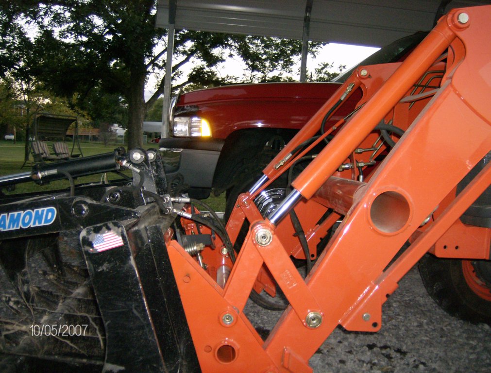

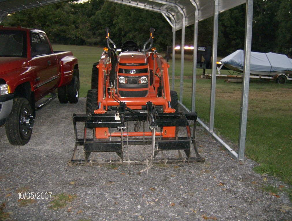

Just FYI... the more I think about it, the more convinced I become that you didn't cause the problem... some malfunction occured. So, I think it is a completely different thing than backing into something:D
Even if the QA wasn't quite latched and one side came loose, I don't think that you were lifting sufficient weight, etc. to have caused the bending that occured. I think that the grappel would have simply fallen off... I'm having a hard time seeing how such strong metal could have been bent unless hydraulic forces on one cylinder exceeded that on the other curl cylinder.
Your talk with the service manager leaves indications that it will be covered. That's such good news... Please post what the analysis and resolution is.. we're all extremely interested.

I spoke with the service manager again this afternoon. They have ordered a new "quick attach bracket"--I assume this means they are replacing the entire quick attach, but that's what he said. They have also ordered the parts to repair the third function joystick.
I asked if they had any idea what caused it, and his response was that he had never seen one do that. He said that in theory I shouldn't have been able to lift anything heavy enough to cause that kind of bending/twisting. He added that they will check the hydraulic pressures before they bring it back. (I don't think that is the problem because the stump wasn't that big/heavy IMHO. I will try to post a picture at some point. It is only 13 feet around; green oak---KIDDING.)
I mentioned to him that "some friends of mine" had speculated that one of the cylinders had produced more force than the other, thus causing the problem. He rebutted that by stating that since they are in parallel that would be impossible--even with air in the system. I am not an expert on hydraulics, so I didn't offer a response.

Assuming one side of the QA came loose, perhaps it was all about leverage. It may have just been the perfect storm, so to speak, that caused the bending to occur.

The dealership returned my tractor this evening after replacing the Quick Attach and the Third Function Joystick. They covered everything under warranty, for which I am very thankful and appreciative.

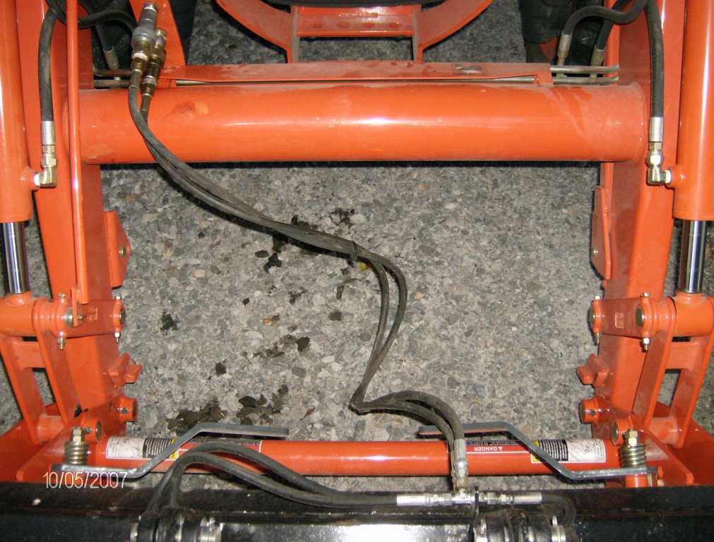

Everything appears to be working correctly at this point. My only frustration comes from the fact that there is still leakage around the third function valve even though they supposedly replaced all of the O-rings while they had it. I plan to see where that is coming from in the morning. Since they knew it was an issue and we discussed it a couple of times while they had it, I am somewhat annoyed that it isn't resolved at this point. I will contact them on Monday if I cannot resolve it myself. I hate to be a pest, but if it is leaking when it is brand new, it will only get worse! Arrghhhhh.....!

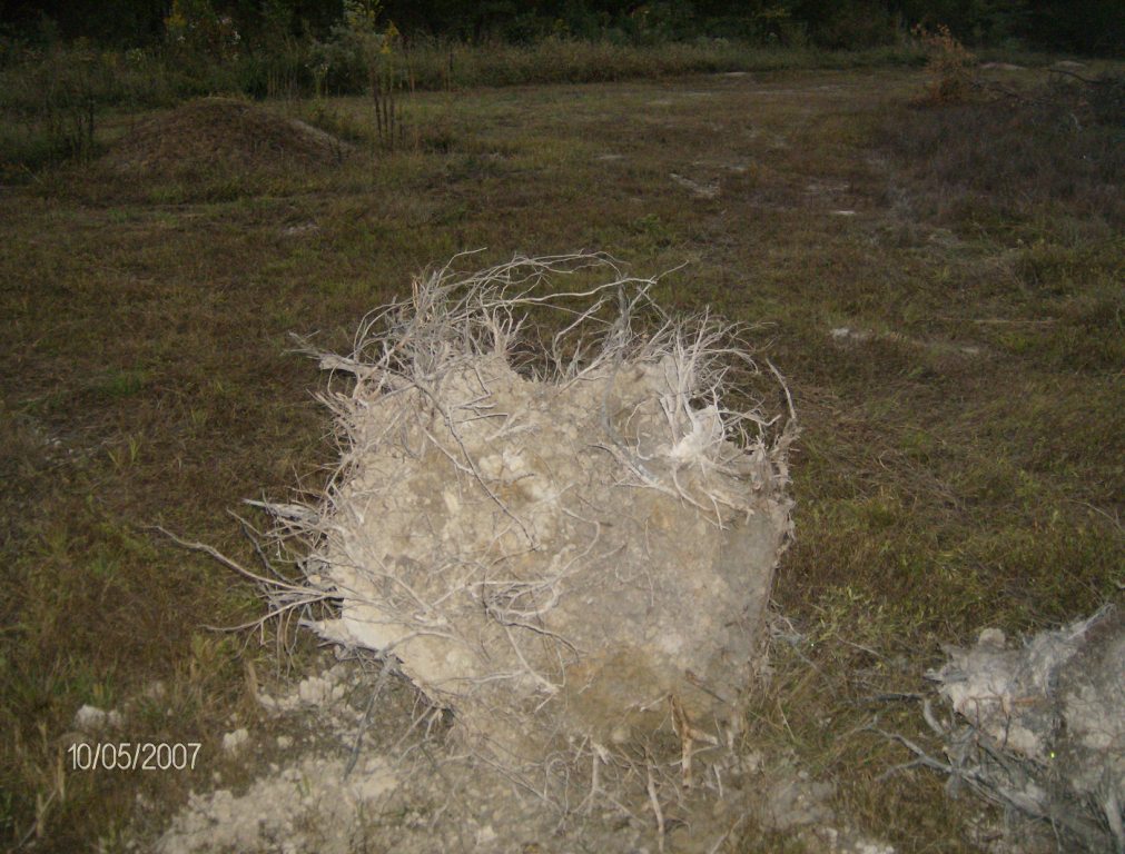

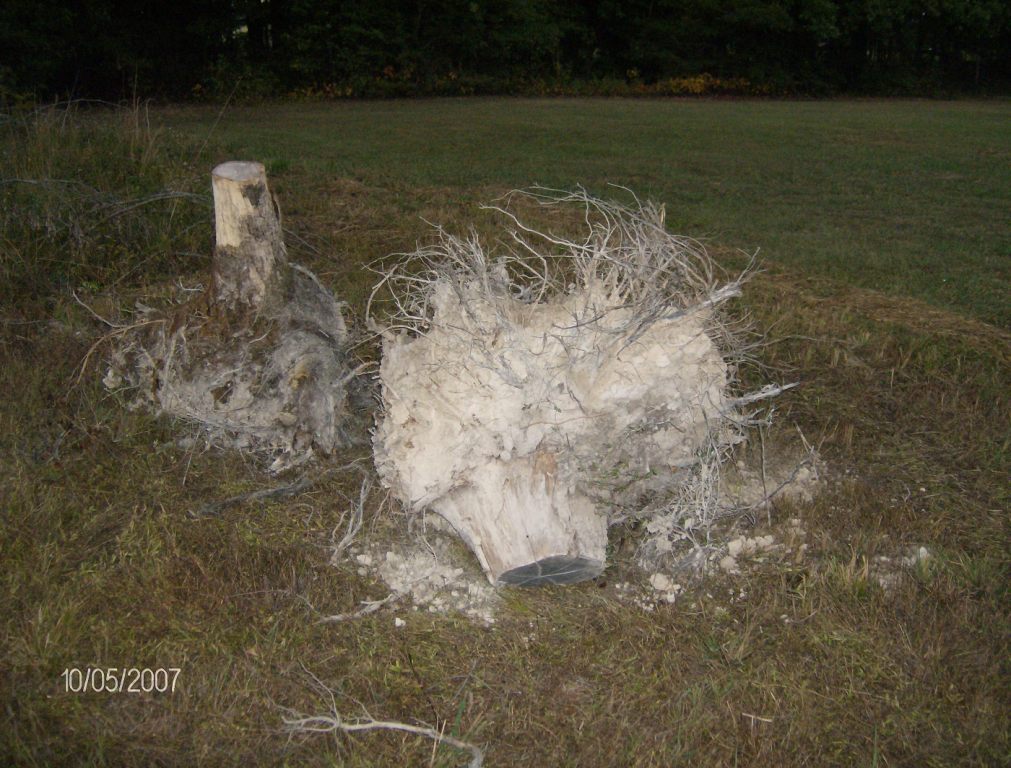

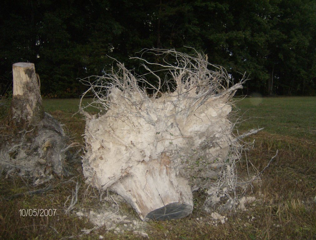

I am also attaching pictures of the stump I was lifting when the problem occured. I lifted it from where it fell and took it to where I was originally headed. I didn't have any problems.
Unfortunately, they never offered any ideas about the cause.

My opinion, the stump is well under the weight that you should be able to pickup... totally.
Try cleaning up all the oil... maybe it is just some residual... we can hope. Else, let them work on it again.. shouldn't leak.
