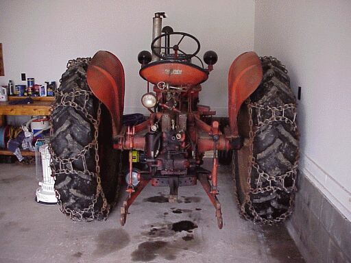

I should clarify my last post some. Case cultivator tractors (DC, SC, VAC, and on into the number series) built after about 1951-52 should have a three point hitch. Case called it an "Eagle hitch" and the lower links have latch type couplers alot like the ones you see on some modern quick hitches. Here is a shot of the back of my DC showing the hitch setup.

Oops, forgot the picture.

Nice. Looks like a nice size. Not to big, not to small. How much HP does it have?

The later DCs with the gasoline manifold and high compression head were rated around 40 PTO horsepower. At the time most tractors were rated by how many plows they could pull. The DC was sold as a 2-3-4 plow tractor. In heavy soil it could only handle 2 bottoms, 3 in average soil, and 4 under ideal conditions. The engine is 260 CID and the governor is set to 1200 RPM full blast. The tractor weighs about 5000 lbs dry. Lots of cast iron in that old girl./w3tcompact/icons/smile.gif
