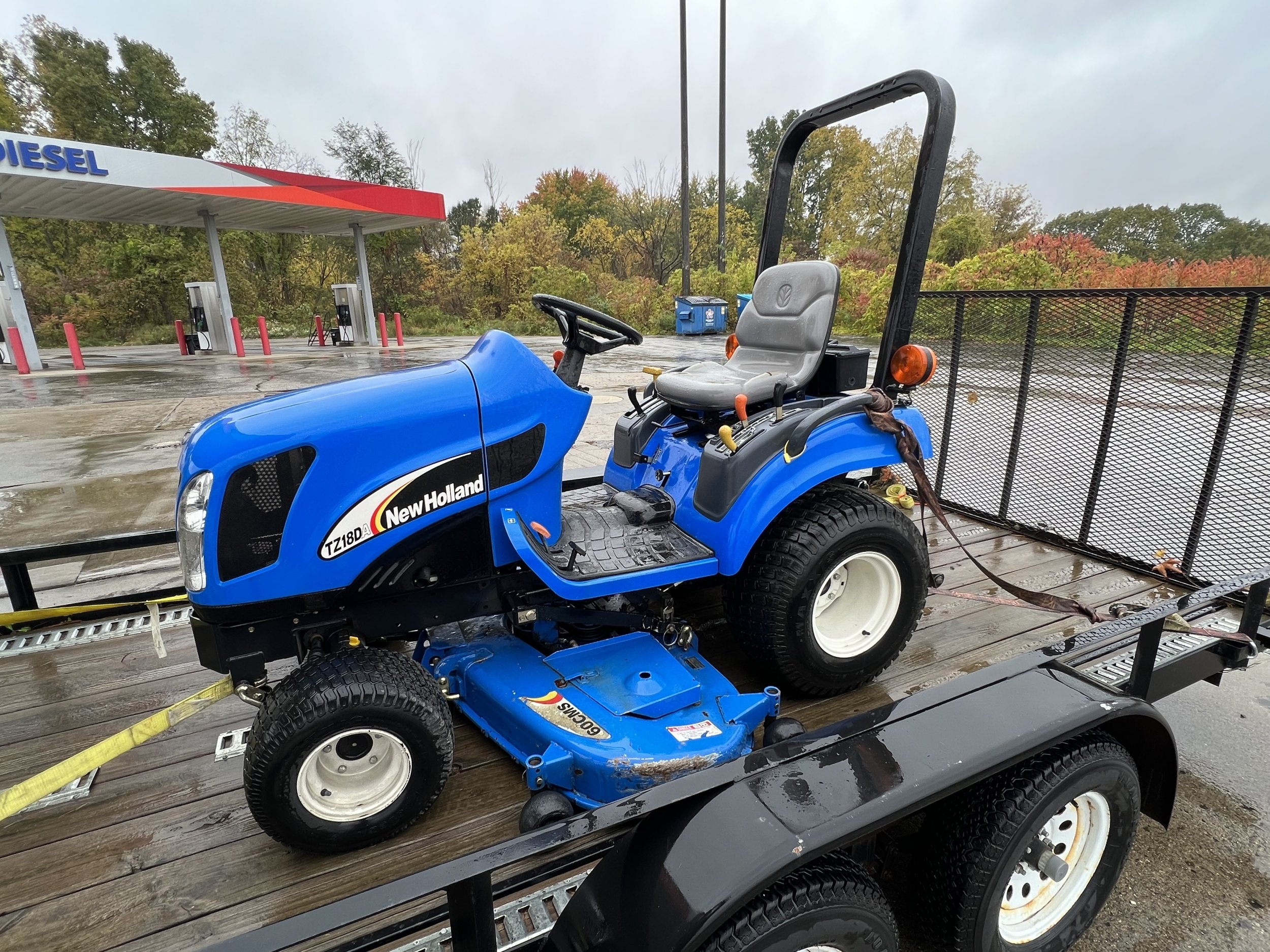

I just bought a TZ18 DA with 60" CMS Mower Deck Used from a John Deere Dealer. They had it listed as a 1991 but my research says it's a 2003-2008.
How do I determine what year it is? The serial number is *HB10027*
My guess is that it's a 2007.
In addition, how do I check the hydraulic fluid level? Just bought an owner's manual online but won't get it for a week or so.
Thanks,
JimBinMI

I believe those have a sight glass on the rear. Round glass should be halfway up on that glass.
I think those have the shibaura engine in them. It's a Japanese made engine and it's a really good one.
It looks clean and nice shape. Tractor data says 2003 to 2008. I'm pretty sure they were not making them a 91.
Yep, it’s the Shibaura. I had a TC18 until 2005 and it was a good tractor. Thanks, I’ll look for the sight glass.

The tranny dipstick is on the top right side of the pto cover shield.

Reference your serial #, mine is 350 above yours and I believe they are in the 2003 to 2004 range. There was an oil filling issue that began with the 20,000 plus numbers, the later units.
