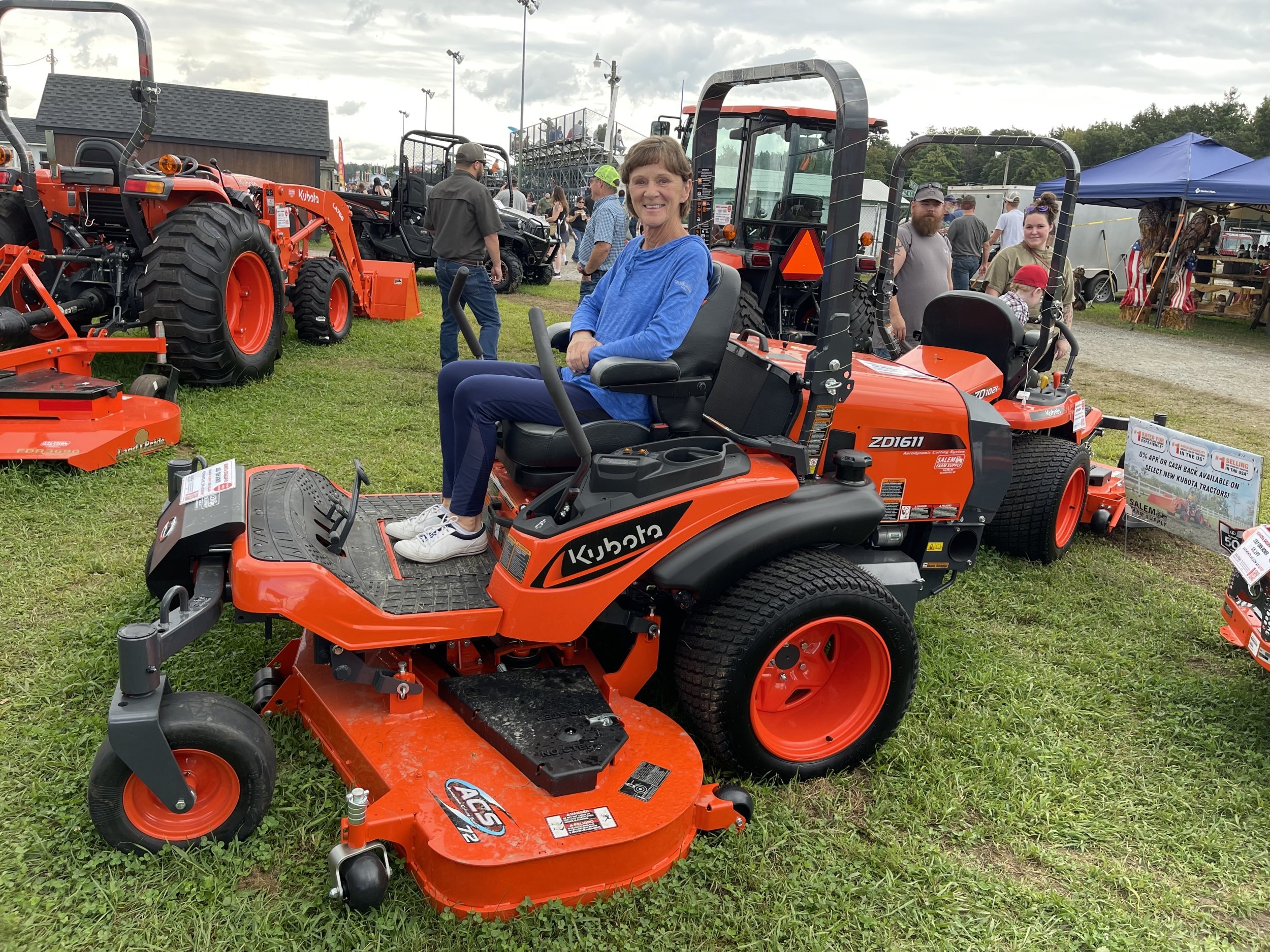

I saw this ZD1611 at the Washington County Fair in Greenwich NY today.
It has common rail & dpf so it’s unknown if problems were resolved.
Who will be the first to give it a try??
I think it was $23k minus $300.00 for cash deal from Salem Equipment.
Big break for cash🙄

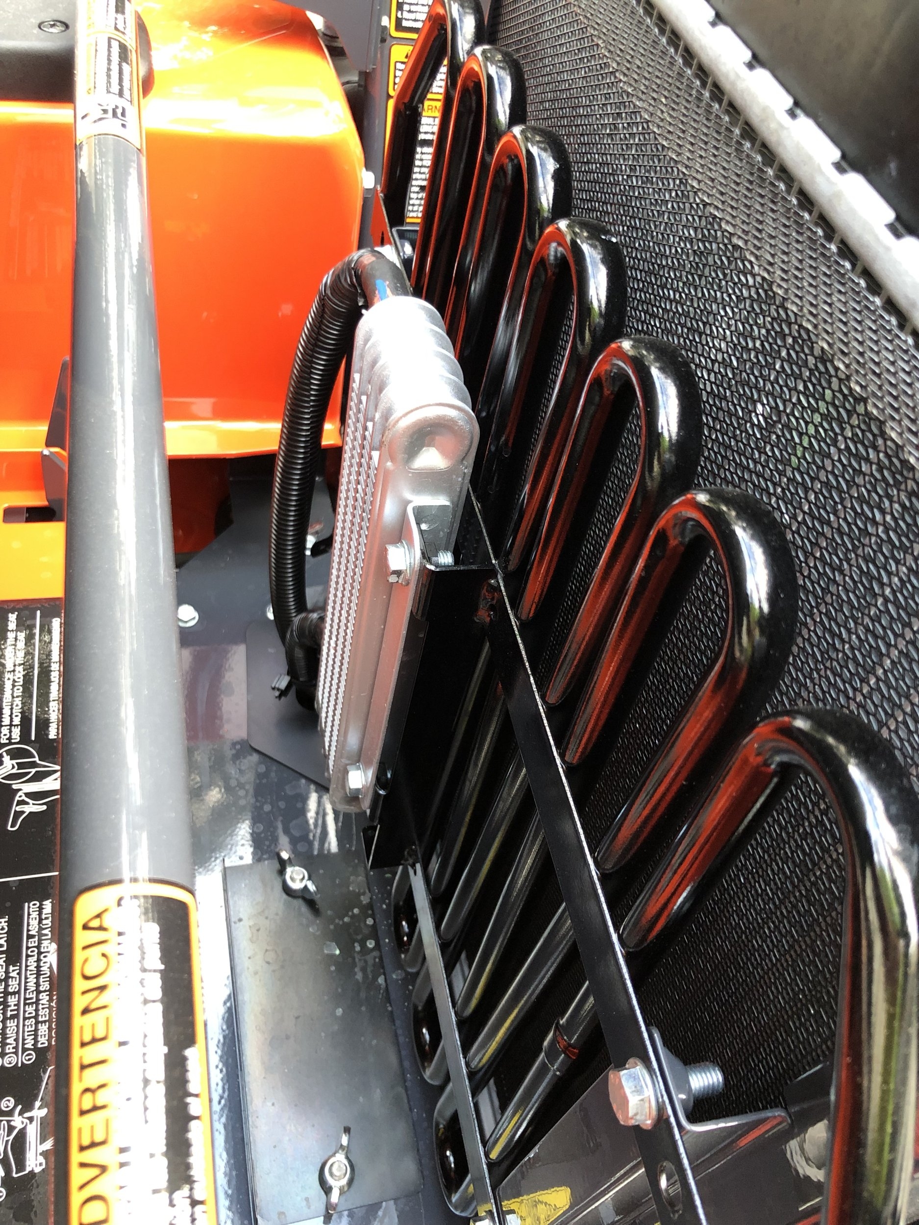

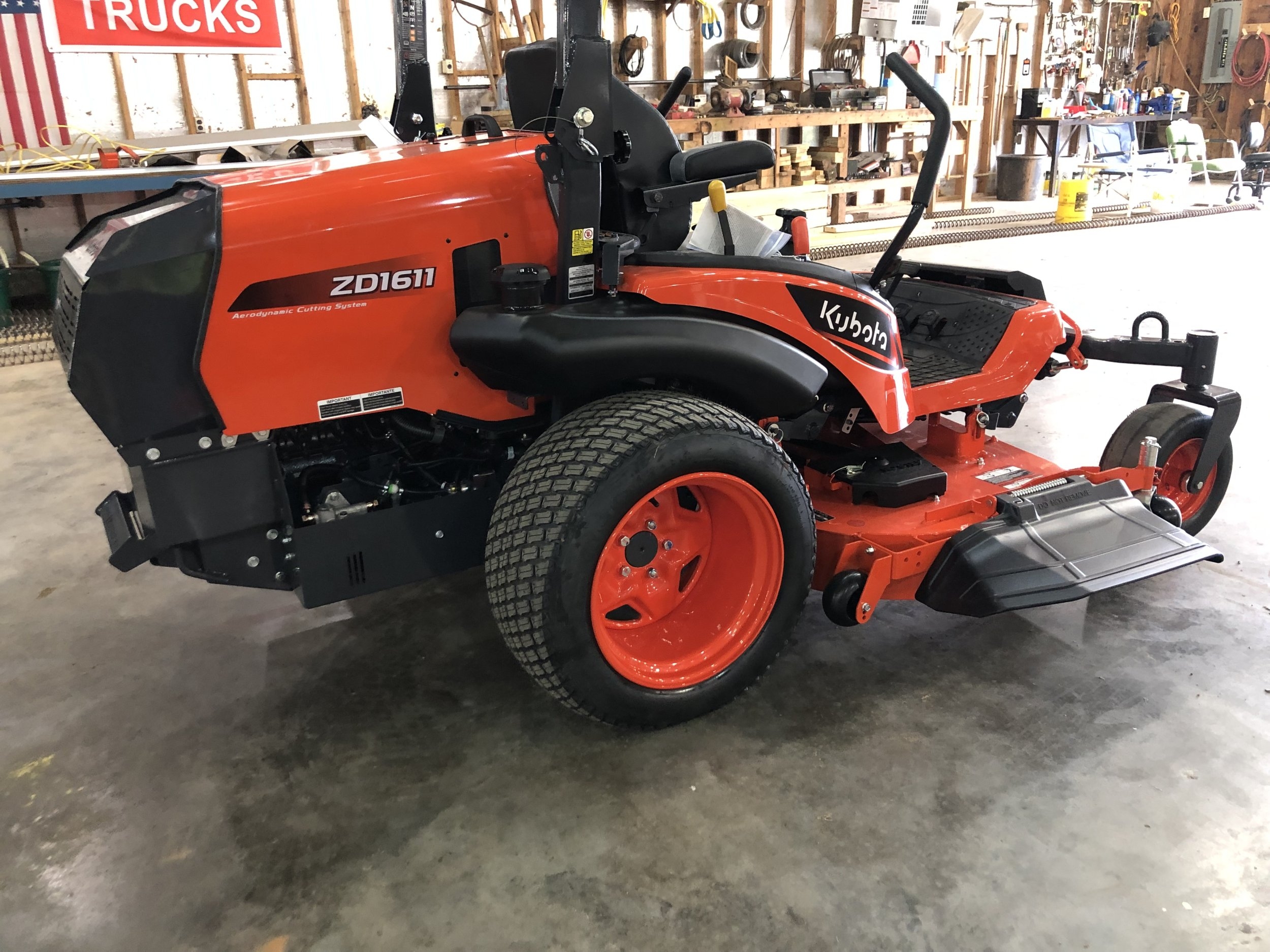

New ZD1611 landed yesterday :love:
Several things has changed & been added compared to my ZD1511 which I still have.
It still has the same V1505 1.5L 4cyl Turbo engine (y)
Notice the rear bumper out back & tie down loops on top of front axle
The new seat is more comfortable & has padded armrest.
An added aux cooler which I hadn’t found out yet what it’s cooling ….

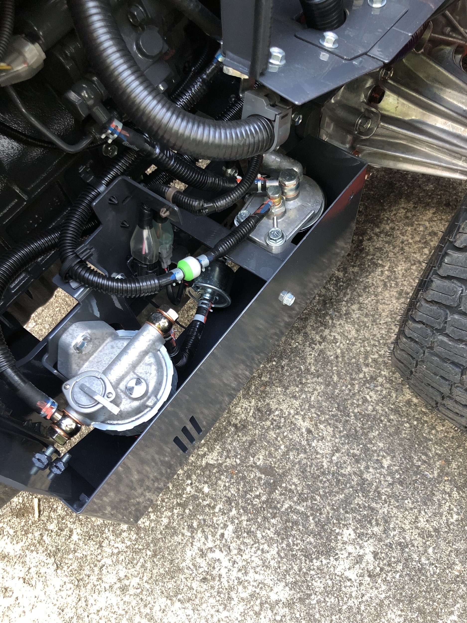

fuel bowl, pump & inline filter has all been moved to the right rear where the battery is on my ZD1511
It also has a bigger inner & outer air filter similar to the F3710 front deck that I traded in on this machine.

Nice looking machine. I like the fuel filters.

Mmmm, I don’t. Looks hard to access/service to me.

Mmmm, I don’t. Looks hard to access/service to me …
That whole guard comes off by removing 5 easily gotten too bolts then it’s out in the open (y)

That's a nice looking machine! The fuel filter location is where I added my Racor 2u filter / separator last year. I also removed the (2) individual tank filters and installed a pre-filter on the common line after the tanks.

… The fuel filter location is where I added my Racor 2u filter / separator last year. I also removed the (2) individual tank filters and installed a pre-filter on the common line after the tanks.
Did you remove the OE check valves at each filter ?
   / What ZD is replacing the discontinued ZD1511 Zero Diesel Turbo Mower ? #55
I left the check valves before the "T".
Result:
Tank > Check Valve > T > OEM Filter > OEM 12v Pump > Racor Filter > Secondary added 12v Pump > OEM Filter > Injector pump.
