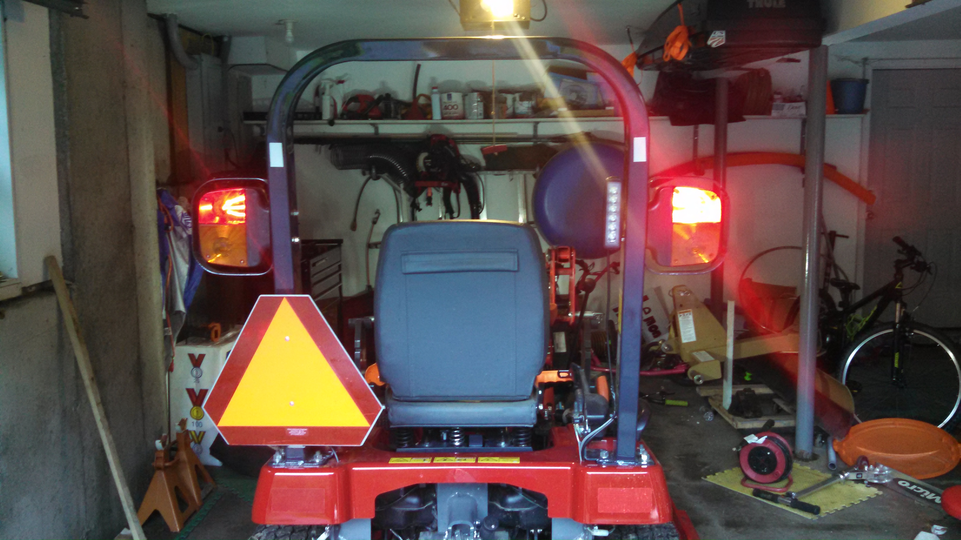

I tried several 1157s for the red lamps on the rops light. I found the winner KaTur red LEDs from amazon. Check these out... On the right is a KaTur, on the left is a pair of $23 red Sylvania LEDs. The Sylvania's were barely brighter than stock. No comparison compared to the KaTur on the right. Plus the KaTurs were $9. Check it out... Amazon.com: KaTur Red 1157 BAY15D 116 134 Base 33 SMD 5:confused: LED Replacement for Car Incandescence Bulb Interior RV Camper Turn Tail Signal Brake Backup Lamp Parking Side Marker Lights 9 Lumens DC 12V 2-Pack: Automotive IMG_20180814_175453_096.jpg
I found the same thing. I tried Sylvania Zevo in the back of my 2017 F250 and found them about the same or a tad dimmer than the stock bulbs. Sent them back to Amazon.
