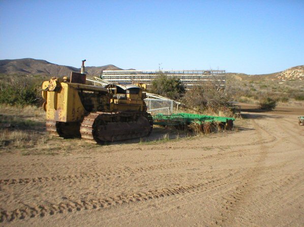

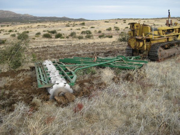

No, it's a D6-4R1. I believe it is the model prior to the 9-U model. Still has a pony motor that most people hate, me I like them, ours starts with 2 pulls and it sure is nice to have it warm up the big engine.:thumbsup: We paid $2000 for the tractor with a cable blade and $1000 for a 6 yard pull can, 30" deep 3 shank subsoiler and 12' Kielfer (JD) offset disk.
Like I said earlier, this thing paid for itself 10 times over vs renting that type of equipment to work on our property.
