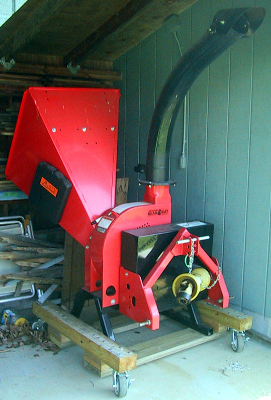

I just bought an Echo Bearcat 73554 which is now the SC5540B. Since I have a lot of smaller brush that I'm clearing out I followed RoyJackson's recommendationto get a chipper with a shredder as well. After giving it a LOT of thought, I also wanted a unit with a blower so I could direct the chips. The major difference between mine and TerryR's unit is that his has a single feed area and a flywheel with the blades. Mine has a feed tube for "logs" that goes the flywheel blades and a "brush/limb" feed chute that goes into a series of swinging knives. The flywheel and the piece that holds the swinging blades are all one unit.
I just bought mine a couple of weeks ago and only have about an hour on it. I just HAD to try it out once I unloaded it! :D Overall I'm super satisfied with the unit. The knives are sharp (and I need to buy a couple more sets!) and the straight material pretty much self feeds. The chipper unit just sucks in anything you feed into it, almost to the point that it's scary!! :eek::laughing: I did try to feed in an old piece of wood that was about 4" in diameter and about 12' long. It sucked it in and spit it out for about the first 8 feet. Then it stalled the flywheel. I turned off the PTO and pulled the piece out. I had to feed it in a little more slowly and had no troubles. Normally I would use something like that for firewood but I wanted to see what the chipper would do.
As CalG said, flywheel weight is a critical spec. My flywheel weighs 145 pounds and has 4 blades on it. I think it might have been able to handle that long piece better if the flywheel was heavier. (Maybe not though.) And based on everything I've read, he's also correct about keeping your blades sharp. Fortunately the Bearcats are pretty easy to access the blade area so I don't think it will be an issue.
My only major complaint is that the blower chute is too high to go into my garage. The plan this weekend is to cut 5" or 6" off of it so I can store it inside instead of outside of my garage. I plan to keep it on a dolly to make it easy to move around. I am also planning on modifying it so I can use my QuickHitch to hook it up.
I bought my unit used from an implement dealer in Wisconsin (I live in Ohio). One of the local JD dealers had the identical, used unit for $3500 (talked down to $3225). The one in Wisconsin was $2400. Shipping to the local ABF Freight terminal was $264. So even with shipping I saved $800. I had found a used, but super nice looking unit like Roy's at an east coast dealer for $1900. He quoted me $200 for shipping. I found these units on CraigsList using SearchTempest.com to search nationally.
This goes without saying, but... Eye protection and hearing protection are a must when using these things. They throw chips around and are REALLY loud as you're chipping. I am also considering getting a pair of padded gloves. If you're controlling the feed on longer stock, the wood does vibrate somewhat and I think the padding might be nice.
