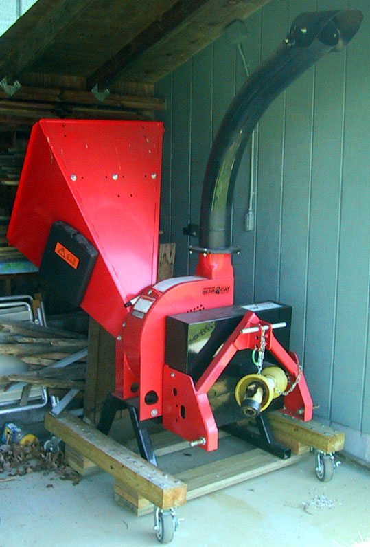

My only major complaint is that the blower chute is too high to go into my garage. The plan this weekend is to cut 5" or 6" off of it so I can store it inside instead of outside of my garage. I plan to keep it on a dolly to make it easy to move around. I am also planning on modifying it so I can use my QuickHitch to hook it up.
I had the same issue with the height of the chute, and cut about 4" out of it so it would fit in my buildings.
I find the dolly I made to be a great help. Here's a photo:
Terry
