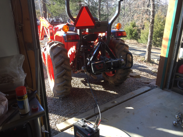

I have the winch bolted to a 1/2" angle bar and that is bolted to the ROPPs with 4, 1/2" caseharden bolts that was already there. Probably If I tried using the winch to pull logs where it's mounted, 9000 lbs off force might bend/brake something on my roll cage, which actually is a $300.00 brush guard.

I used a receiver mount from harbor freight.
ran #4 wire to battery and put a quick disconnect near the rear. It's only a 5k and I only use it with engine running and short pulls. Never really push it. I also had it laying around.
An extra disconnect set lets me connect jumper cables to the winch if using it on truck or trailer or I want to use the tractor to jump start something without raising the hood.
Darn it, I cant see the winch mount, to much shadow, gut turn the tractor around so it's facing the sun.

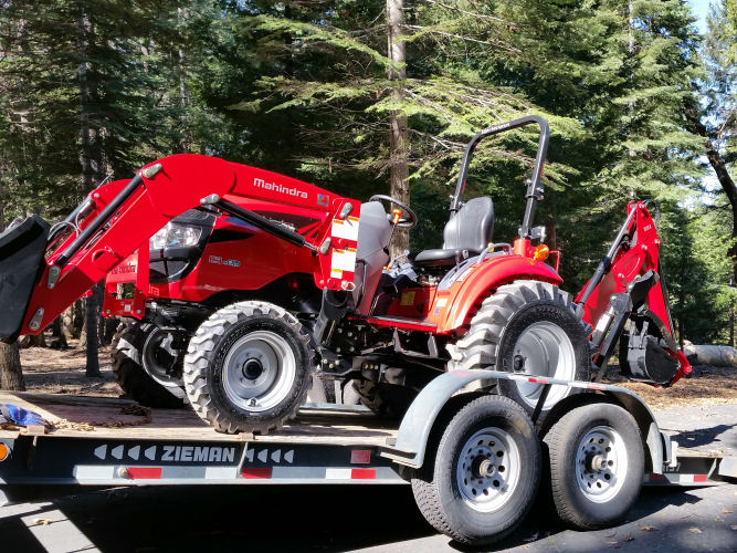

I do have a grill guard but there is not enough space between it and the hood or it and a cross bar on the FEL to mount the winch. It's kinda early on to start with body mods but I've been known to take matters into my own hands before. Maybe down the road a bit. Maybe you can see how tight it is from this pic.
I'm not too sure what good the grill guard is at this point so maybe removing it could be an option. There are four nice bolts holding it on that could be used for a winch mount. The frame looks to be beefy enough.
   / Whats a good location for an electric winch? #34
That's an idea but it looks like the winch would rip the ROPS right off if you put any real load on it.
I'd like to get it up front but space is at a premium up there. No place in front of the grill guard due to the loader, no place in the rear due to the backhoe. Maybe I'll just have to put the idea on hold for now or perhaps just put some class III hitch receivers front and rear somewhere for when the loader and or backhoe aren't mounted and put the winch in a carrier for a class III hitch. Those are pretty common so I wouldn't even have to make it.
I'm thinking, first you have to get the winch you want, and fabricate a new front grill to mount it on. But to do that, it might require some Yankee ingenuity and to get that, you might have to move to New England. OR take the faster then lighting quick disconnect back hoe off and mount it like these other guys have.
Hitch Receiver Mount for Winches
Oops and sorry. I used a Titan 3 pt hitch and then mounted the winch on the attached mount from harbor freight.
One caveat though. My 5000 lb is probably a lot lighter than your 9500 lb to hoss around. I do cheat(read as being lazy) and lower the 3point and stick the winch but that isn't really necessary. Would have to put my beer down though if sticking it by hand though.

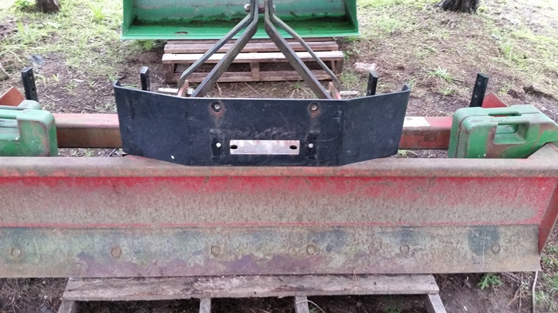

I used part of a brush guard I got with a used Warn M12000 winch and also found a used military AGM sealed battery to power it. Have to install a cable before I can test but currently on hold for other projects. The Box Blade makes a great base and works great as ballast. Obviously not going to work with a bucket attached.
Looks to me like there is room to take off the factory grill guard and make your own with a winch mount built in. Keep the factor one to go back on if/when you take the winch off. The grill guards are nice to have, keeps you from smashing the front of the tractor when you have the loader raised.
What's the distance between the loader cross bar and the grill? Looks like it's on the way to a foot.

Haven't measured it but it's closer than a foot. I think doing something to reuse the space where the current grill guard resides is in the works if a front mount is ever gonna happen. I'd likely just modify the grill guard that's on it now to allow for the winch and getting the hood up and down. I think the crossmember the grill guard is mounted to is beefy enough but I might put a doubler plate on that just to be on the safe side.
