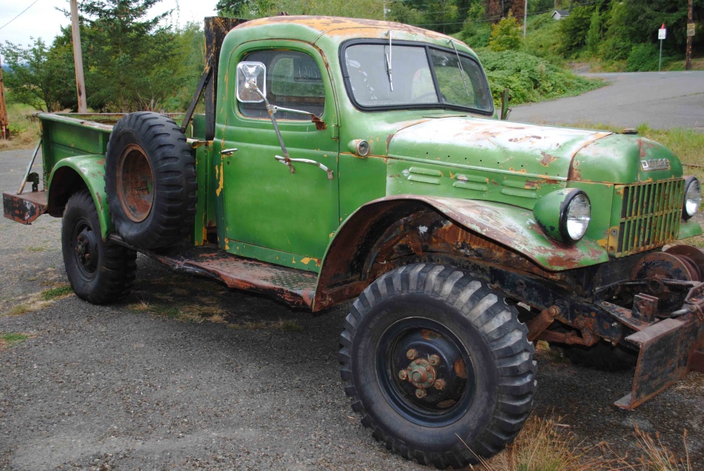

May be old but they don't get much easier to fix
