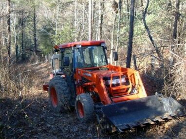

Well, guys I thought I would update you once more. A neighbor brought over his M-F tractor this morning. It's bigger than my 4610 and also 4wd like mine. We managed to get over while ground was still frozen real early and at least got the Mule unhooked from the 4610. After both of us giving it a good going-over underneath with one of us using pedals, etc and the other looking underneath and following the linkage and checking for obstructions underneath, he backed his down as far as he could safely, got log chain hooked to chain hooks on my bucket, I let off handbrake, put in neutral and 2wd and let him pull.
My kubota didn't move one inch!
It was just like the tires were frozen stuck (which they weren't because it rolled back when I moved kawasaki mule). I'm not sure what size his was but i think it was a 5400 series M-F or maybe 5500, etc
He just dug him some holes for his wheels, /we just couldn't pull it out.
I'm going to ask around but there's not anyone i know of with small dozer. Only ones i know of has those real big Cat's and they're all busy working on new road construction.
But, i'll get 'er out someway next week i guess.
oh, here's a couple pics i took to kind of help show the predicament here. Still doesn't seem to show the real slope in a pic for some reason.

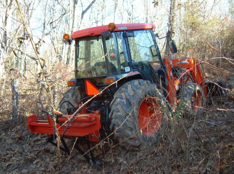

#35
Re: What\'s ailing my bota 4610\"
different view

A very perplexing situation, and I sure look forward to hearing the eventual outcome.
   / What's ailing my bota 4610" #37
Did you put fasten the seat belt and take off the parking brake?
   / What's ailing my bota 4610" #38
Sometimes when you're hung up on a slope the best thing to do is use a winch. I'm not entirely surprised the MF wouldn't do the job.
Around here most of the trucks have pipe bumpers with rings in the middle. Dozers without winches are rare. When the trucks get stuck, a dozer winches it out.
   / What's ailing my bota 4610" #39
<font color=blue>Still doesn't seem to show the real slope in a pic for some reason. </font color=blue>
Just a thought... instead of taking a head on or tail on pic, take one from broadside, holding the camera "flat" such that the hills incline is shown 2 dimensionally on the camera.
My experience is, it's hard to show incline looking up or down, I've always had to take a pic of it sideways for best results.
Richard
