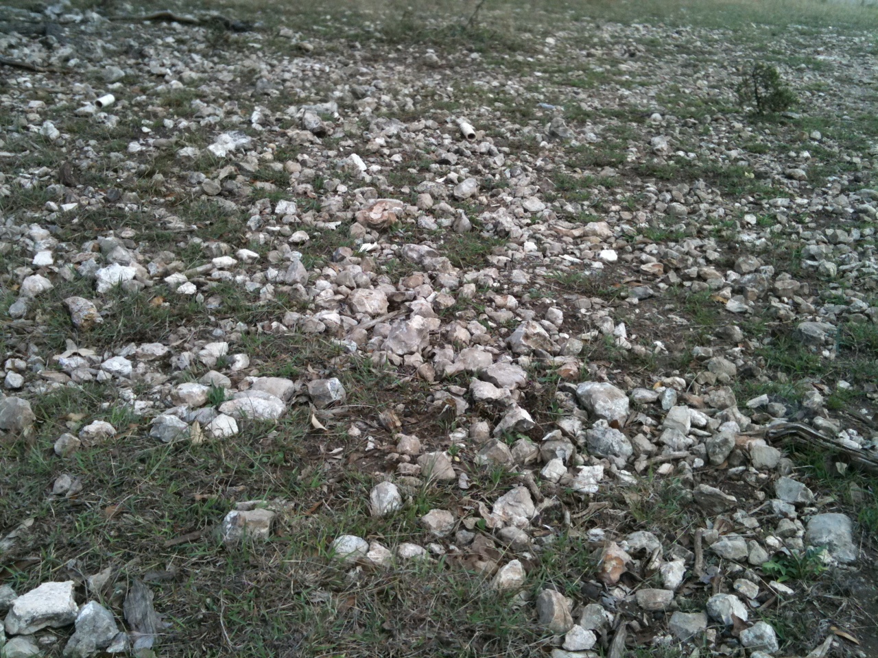

Re the rock bucket, I've given that a lot of thought and think that it should work well for the larger rocks. I just don't see how that could work for the smaller rocks and as it seems the rock bucket would just push them along?
Googleing the Veermeer Rock picker, I found this. I don't know how much it cost but it looks like it has possibilities.

On second thought, the Haybuster rock picker needs 80 hp and I only have a 50 horse tractor. :(

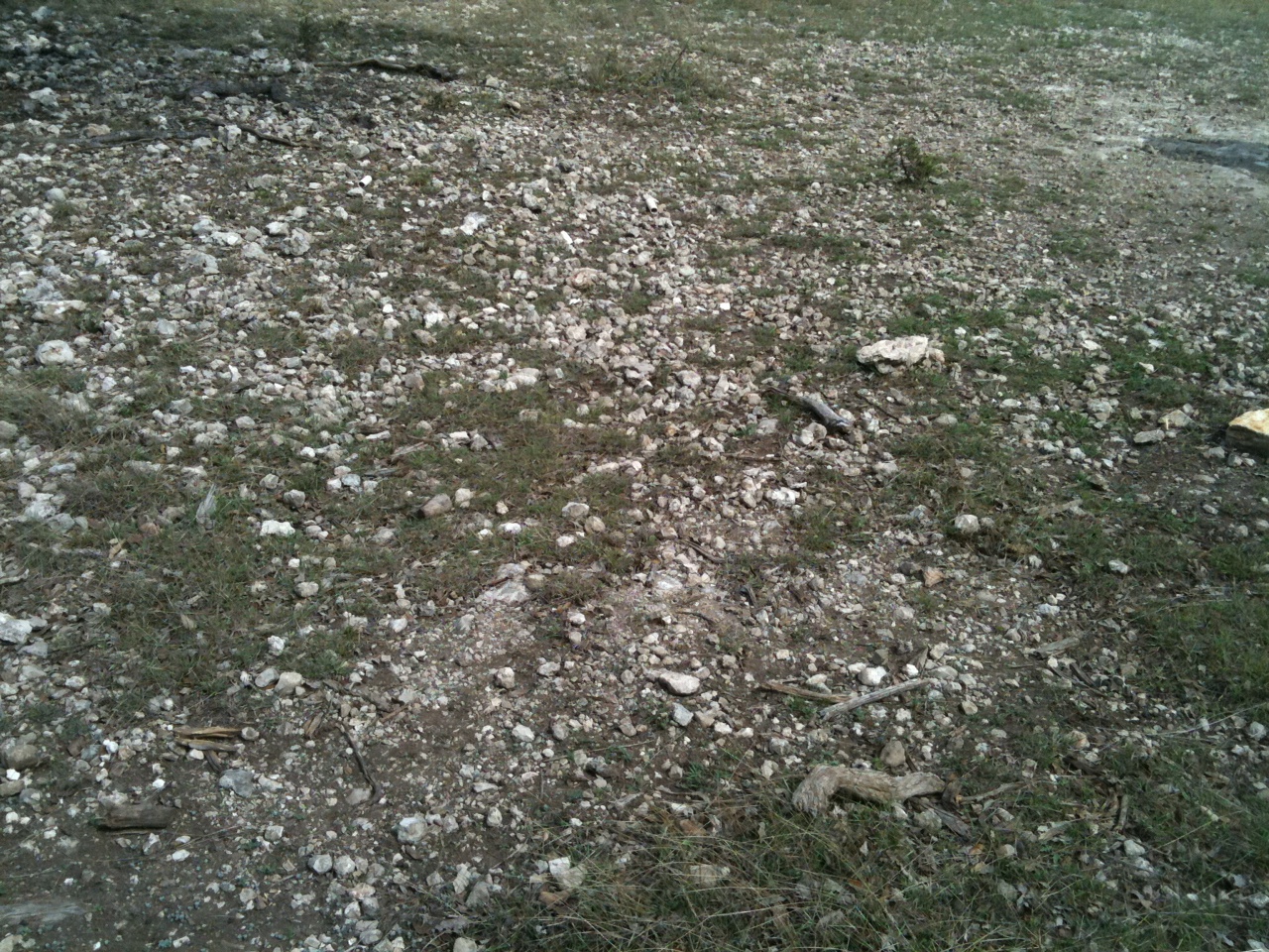

Man, looks like they have been put there and spread out.... is that a chunck of pvc pipe in the mix?
If that were my job to clear all that rock with what I have, would use a combination of a rear blade, rock bucket and a regular bucket not sure of the order, mabe even rent a harley rake or a landscape rake might do the trick.
Try to windrow them or heard them in to piles
If your into spending money... schulte?? sp??? makes a nice rock picking unit for smaller tractors

No, the rocks are natural, not put there and spread.. I made the mistake of putting a deer feeder in the area about ten years ago and the deer hoofs have loosened up the dirt which has long since washed away. The PVC was part of the baffels on the feeder. We have a standing joke around the Texas Hill country that whenever it rains, it rains rocks. I'm hoping to use hydro seeding to get the grass going again once the rocks are gone.

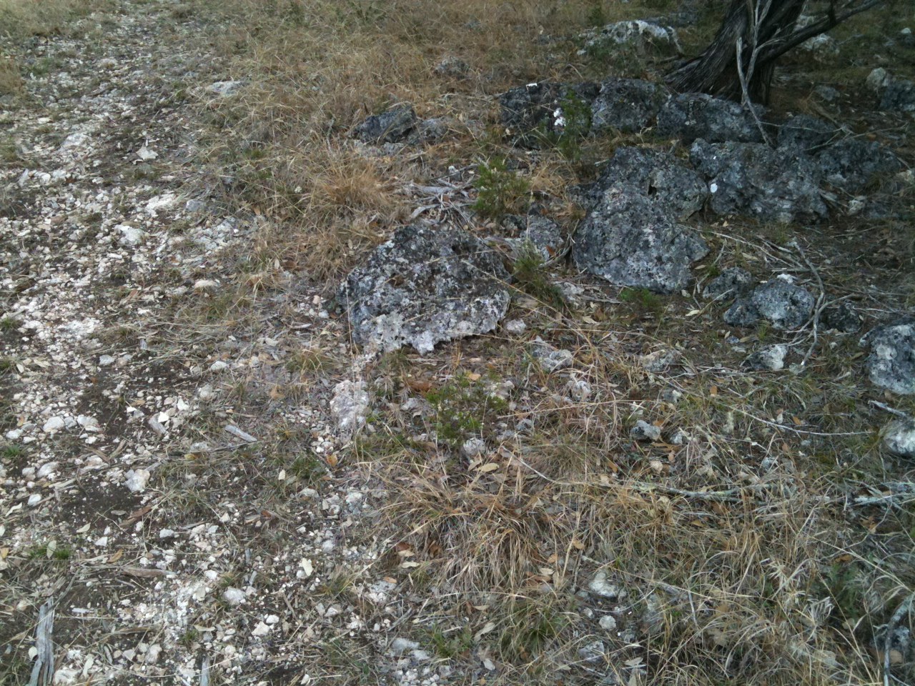

That is extreamly rocky to say the least! Since its a small area right? I would just pick up the biggest rocks by hand and leave the smaller ones. That looks like bedrock in your last pic so your soil is very very shallow. I would just pick up a few of the larger rocks by hand and sow the grass seed over it. By the time you get rid of the rocks you'll have a pond by the looks of it. Since the damage is already done why not just leave it as a feeder area like it is? I doubt the deer mind the rocks.
