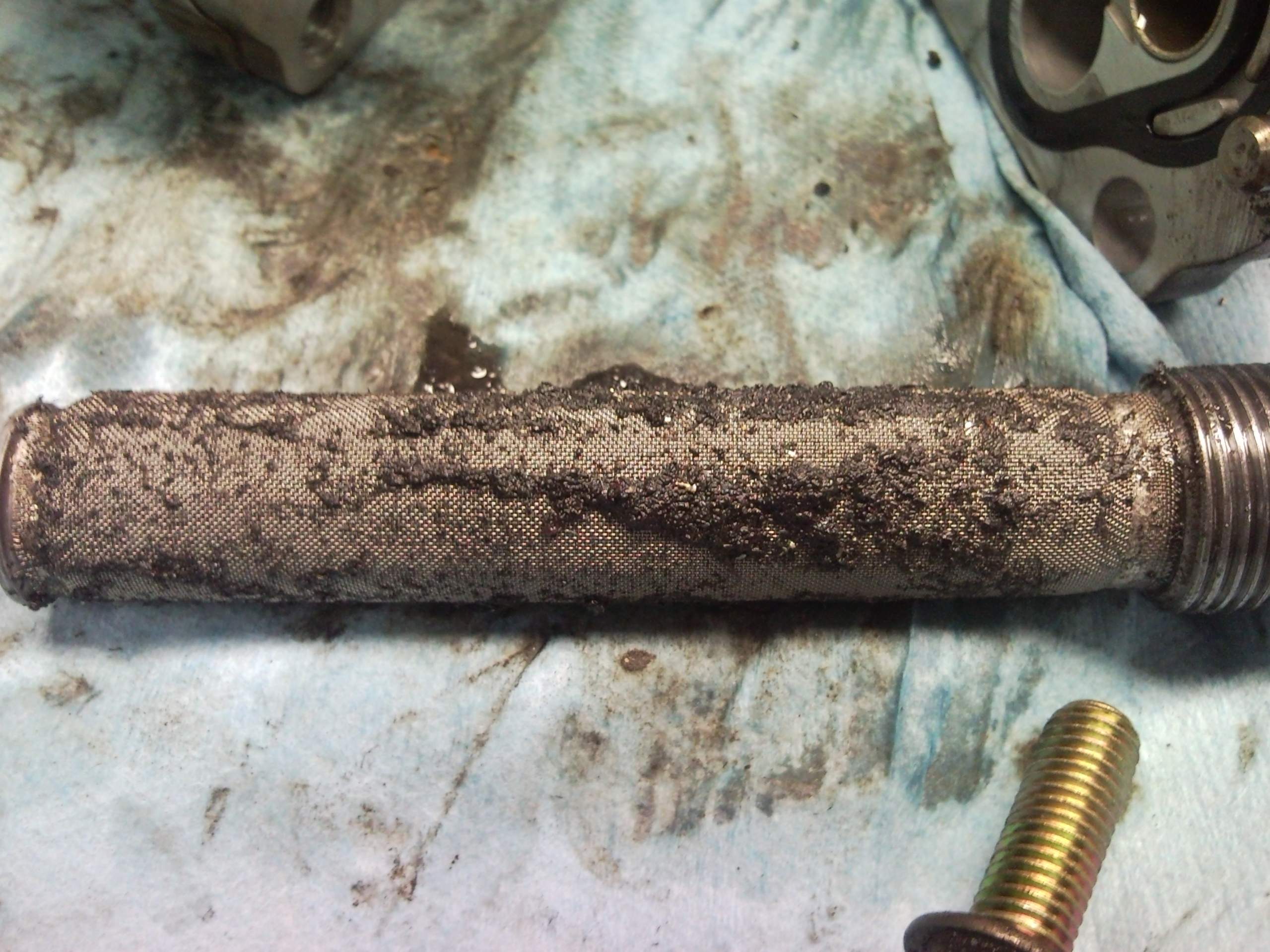

Well............... After reading through everyones replies, and looking at what was in the bottom of that nasty jar of fluid after it sat all night, I drained the rest of the oil out and took my filter screen out.
Long story short, the first picture is what my screen looked like and the second is what came out of the fluid when I ran it through a couple of screen and a filter. The black crud is rubber that I think must have been washed into the system when the fire was put out by the fire hose.
I'm thinking about flushing the system with a good amount of diesel or clean fluid by pouring it into the filler with the drain plugs open. Wash, rinse, and repeat.
Hopefully a clogged strainer was the root of all my problems. I'm thinking the oil might just be dirty from the smoke of the burning rubber associated with the fire.
Thanks for all of Y'alls ideas and suggestions. Can't wait to do a crackle test.

Many questions...
  • Was the tractor running when it caught fire?
  • Was it still running when the fire was put out?
  • Were hoses burned through?
If so, then it might be possible to get burned rubber from hoses into the trans case. If not then, imho, it would be hard to get burned rubber from hoses into the trans, unless the firefighter (owner with a water hose? extinguisher?) hung out spraying water for quite some time.
More questions...
How is the 3ph lift performing? Did you lift anything (other than the lift arms) in the 20 minutes of run time?
Did you disassemble and replace seals on the 3ph cylinder, drop speed valve, control valve, flow priority valve, and pressure relief valve?
If the fire was hot enough all the seals in these components may be toasted (pun intended). I believe all of these components are on top of the B2400 trans.
Also, have you checked/changed the hydraulic filter? Is it crudded up as bad as the screen?
With that much rubber in the screen and trans after a fire, I'd be worried that seals in the trans were cooked and have lost a layer of rubber and will continue to disintegrate over time.
With only 20 minutes run time, I'd put money that there is rubber somewhere actively disintegrating.

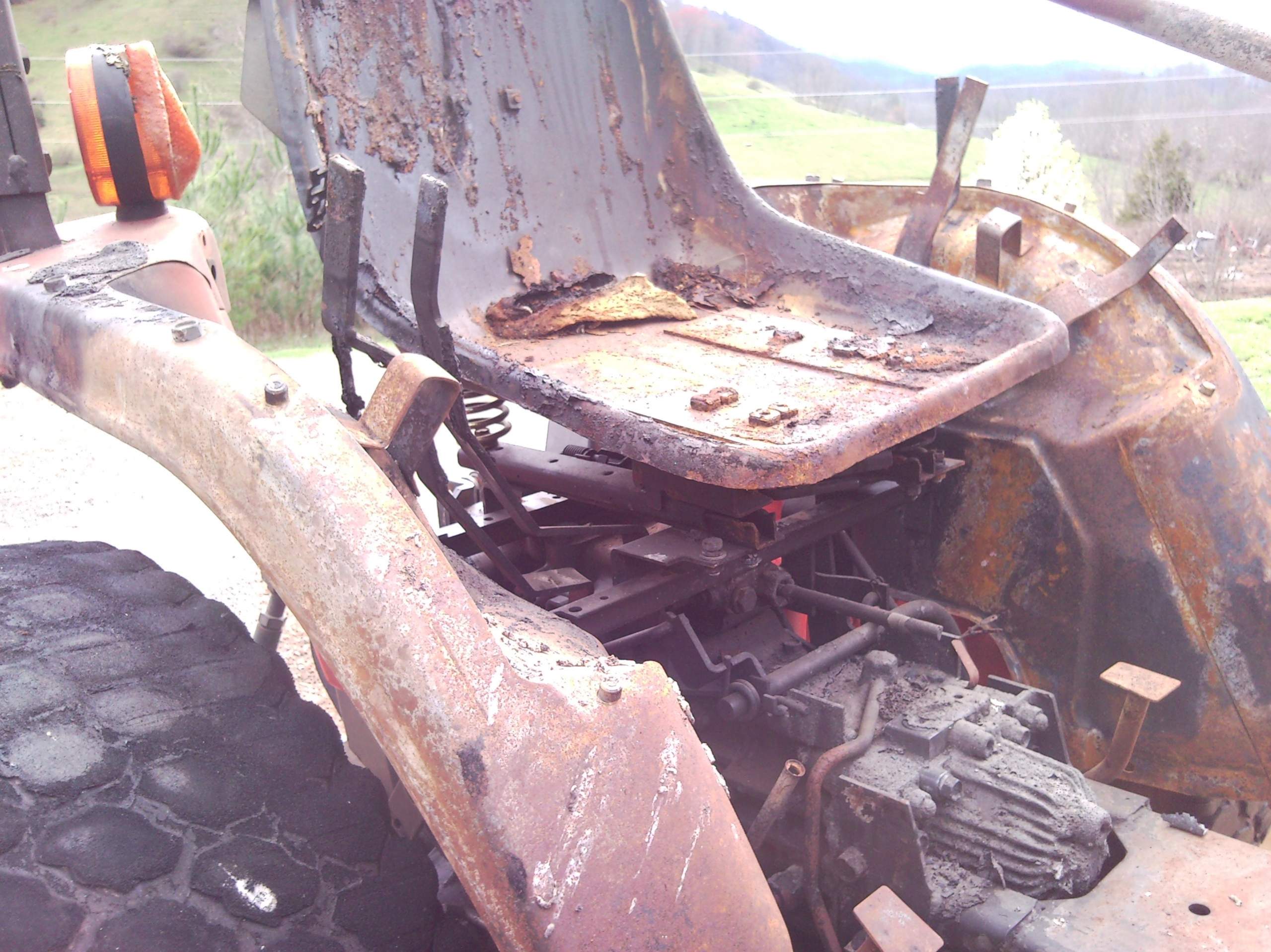

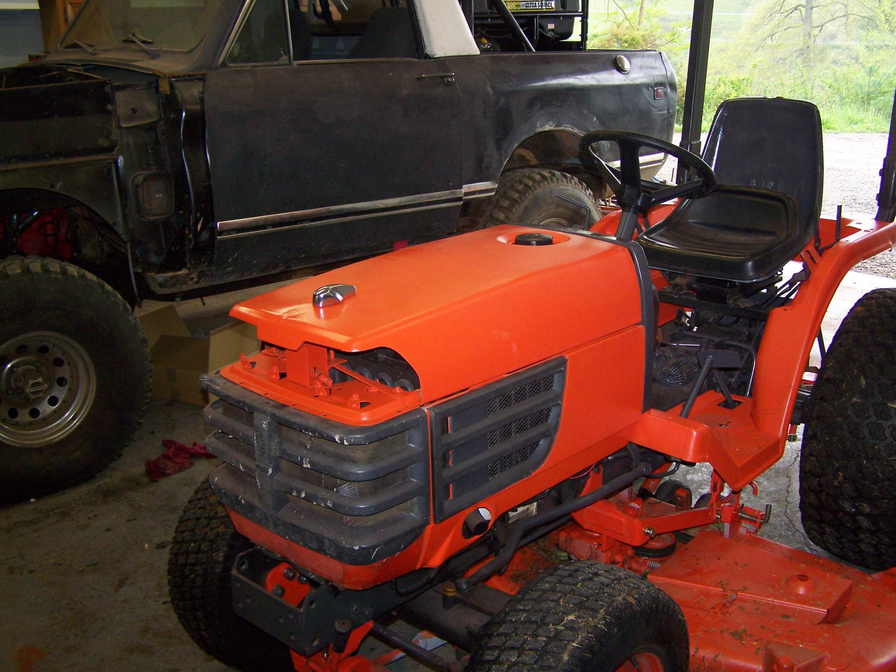

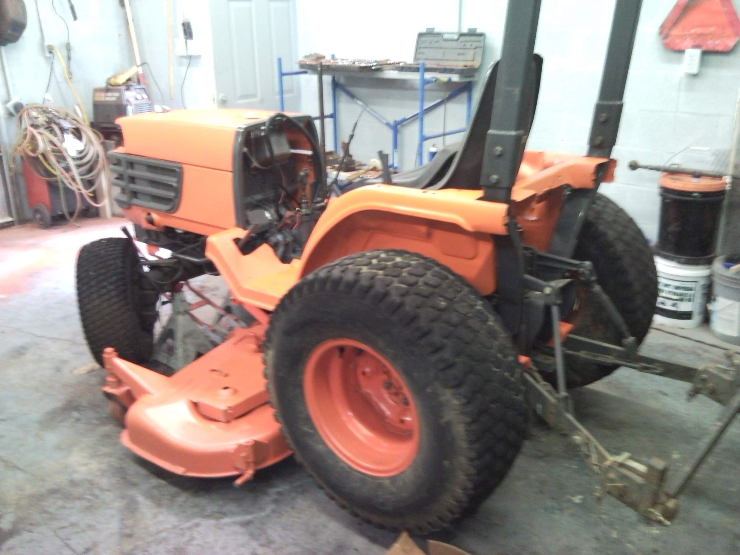

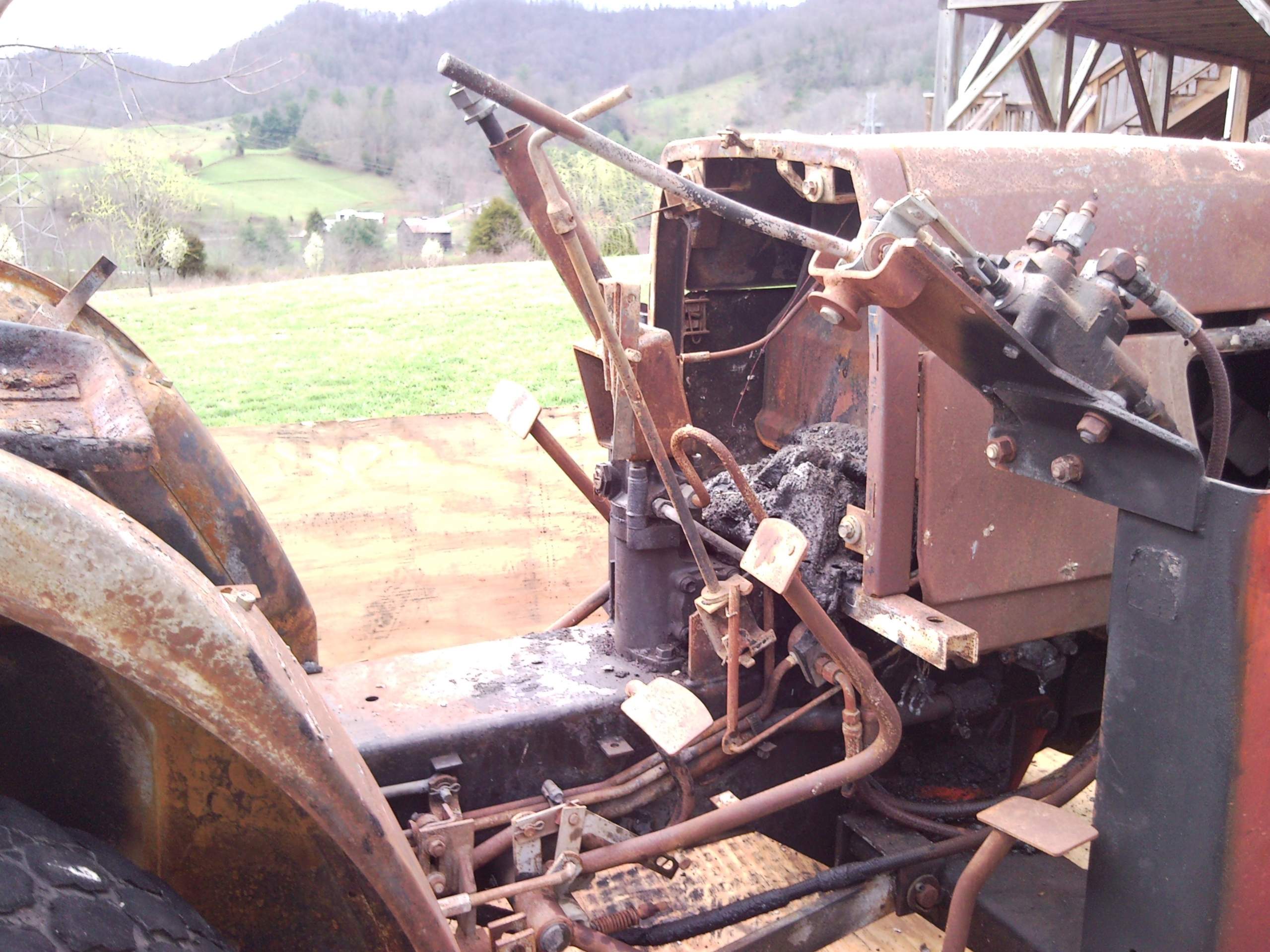

Quarencia, the tractor was inside a building when the fire started. The tractor was owned by the Town where I work and I happened to be there when the thing caught on fire( I'm a Detective with the Town). Basically, the key was left on by an employee and the fusible link apparently didn't do it's job.
I was the first one there and got to watch it burn(tears in my eyes) and almost burn the building down it was stored in. The fire fighters had to hose it down pretty good because of the diesel, plastic, and rubber being well involved. I remember thinking to myself,-I'm glad thats not my tractor-. It was hosed for probably about 3-4 minutes all together.
I posted some pictures of the before and after. I'm quite a bit farther along now than the after pictures, but still have some non-essential parts to buy like the plastic trim, mat, stickers. Oh yeah, I forgot about the $1000 worth of wiring, gauges, and safety switches.
The thing I love about a diesel is all that wiring is just for dress up. I f the glow plug and the starter have juice and the injection pump has fuel, It'll run fine.
I'm rambling, the fire was the hottest over the power steering box. I've already had it apart because the top seal was leaking, but the rest of the o-rings and gaskets were fine. i guess the oil probably protected them.
As far as the TPH, contrary to what it looks like in the pictures, it didn't get that hot. After peeling off the melted plastic from the seat and cover, the paint was perfect and no leeks from around the lowering adjustment.
Sorry for the lengthy response.
Brad
