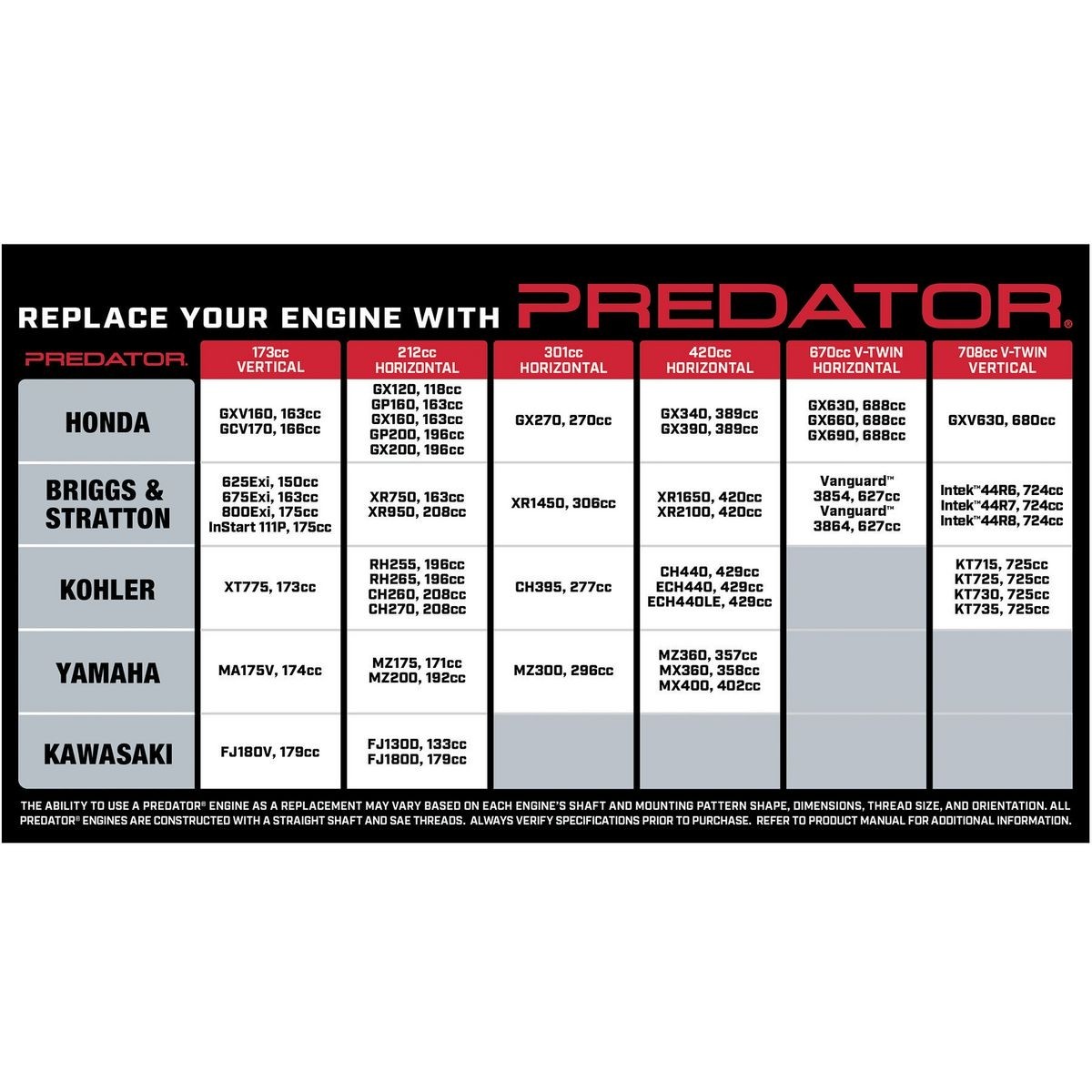

Would a new Harbor Freight Predator fit?
   / What's it cost to have a Briggs 8 hp engine overhauled? #6
Love my Predator powered generators and semi trash pump!
   / What's it cost to have a Briggs 8 hp engine overhauled? #7
   / What's it cost to have a Briggs 8 hp engine overhauled? #8
Look up your Briggs numbers and compare it to this Predator list. See if you can find one that's compatible.
