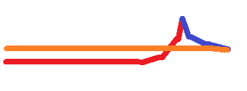

You can do it on the mowers I have driven, but I wouldn't unless I was trying to do doughnuts on pavement. It sounds like a good way to flip the mower of on a bank (ie: one full forward, the other full back) 1/2 forward and 1/4 back is about all I would do on our mowers... The issue is that if you want to flip around and mow the next pass, you have to have the inside wheel move over ~1' while the outside one needs to move over ~4' and its hard to do that without a K turn OR enough space to make a "loop" (which then makes your lines look funny at the ends)
Usually I would go from both sticks full forward, to the outside one at half way forward and the other ~1/4 back (Red line in the picture below), then switch which was fwd and which was back to back up while turning (Blue line), then both forward (Orange line):
Total time, ~5 seconds.

I think I figured it out.. Its all in semantics.. The '3 point turn' referenced earlier is noit really a 3 point turn like we think about while driving four wheeled vehicles..
This is the way I was pretty much taught, and they call it a '3 point turn', but its not.. Its more a '3 step turn'.
I was taught to do it really, really quick, thus the 'full back/full forward' on the sticks.

That guy is describing one way to make a tight turn at the end of the row, but it is not what most commercial cutters are referring to when they say 3 pt turn. The true 3 pt turn is like the letter Y, only the bottom of the fork is radiused vs pointed like a true Y. Come to the end of the row, slow and turn toward the next row in the headland. Stop. Back up in a semi circle. Stop. Pull forward into the next row, and go.
Like I said, it would take a lengthy post to cover the different ways there are to do it, but the 3 pt turn as I described it here is the most common turn used.
