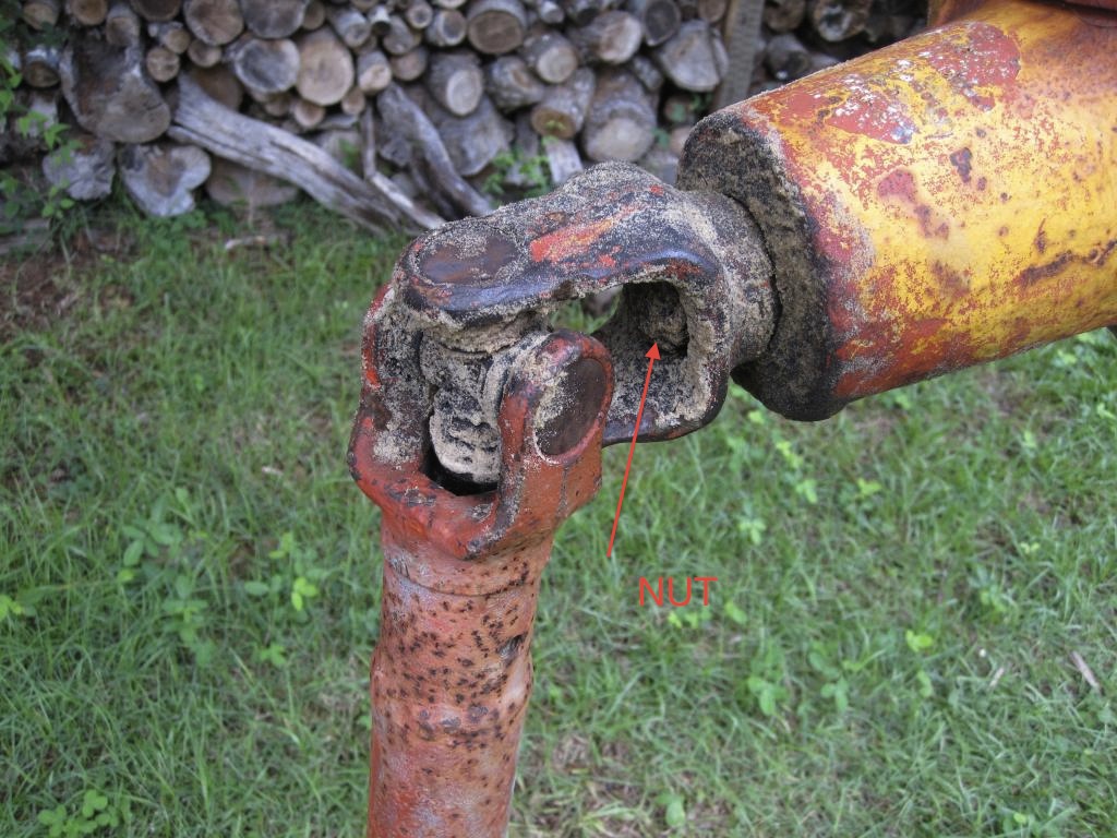

I don't think you are going to be able to do anything with that U joint except get the assembly off of the input shaft of the gearbox. That U joint looks to be a pressed in one. Try to find the shear bolt or whatever is keeping the U joint connected to the input shaft of the gearbox and get it off so you can measure the input shaft.. Did you go to the Danuser web site I posted? It looks to me like you have a little over 1/2 of a post hole digger... No Driveline, and I didn't see any augers, perhaps you have them elsewhere. I am guessing but cannot see in the photo, that the U joint is shear pinned to the input shaft. The input shaft should be just round, and smooth, No splines.. You need a Driveline with 1 3/8 six spline on the tractor end and shear bolt on the other. Exactly what size for the round shear bolt end, I don't know you will have to measure.

Does anyone else see a shear Pin?.. I don't see one.. You don't suppose it did not have one!

no shear pin on the PTO shaft thing, but there was one for the auger side..........what you see in this U bolt pic is what I got, this thing looks really old, I went to the website and not many looked like this they were all a little different..

I think you will find that the yoke is held on to the gear box with a nut in the center like the yoke on a truck differential. (see pict) You can not use a regular shaft like Tractor supply sells because the yoke is totally different. If you can fine the correct size of the other end of the shaft it would be very easy to make the connection to the tractor. Measure the opening in the end of the shaft carefully. It may not be square. Many are rectangular to keep the u-joints in phase. tractorauger005_zps9edfca2a.jpg
Click on the picture to see the location of the nut.

This is either a late Danuser Model F7 or early model F8. The tractor half PTO is missing. Seeing how we have been in business for 103 years, some PTO suppliers were not lucky to stay in business. The PTO is an old Rockwell. Rockwell went out of business in the late 1980's.
The correct way to fix and covert this machine is with a PN 7577 Conversion Kit. Here is what comes with the kit:
The # 7577 Conversion Kit includes a pinion with hardware, Pinion Guard, gaskets, grease seals, complete guarded driveline all the way to the tractor, and the # 7270 Auger Adapter Guard for 2-3/8" diameter center column augers. This # 7577 kit is required on all diggers with serial numbers prior to 60,000.
Once the kit is installed, the digger will be set up like a current Model F8 and all repair parts will be available. With this kit you will also receive a free manual and safety decals. Check out Attachments | Augers | Post Diggers | OEM Parts | Recoil | Danuser for more details and you can email me from there.
