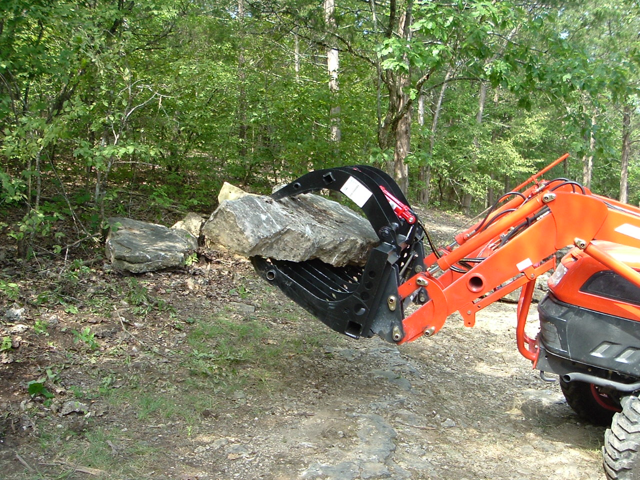

Something along these lines will work. EA makes great stuff.

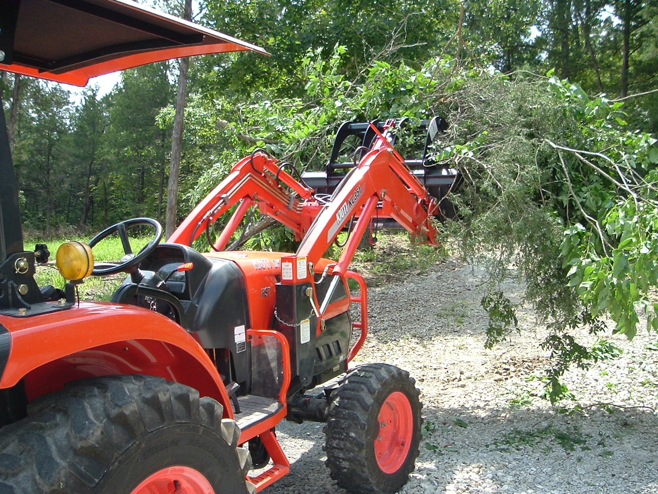

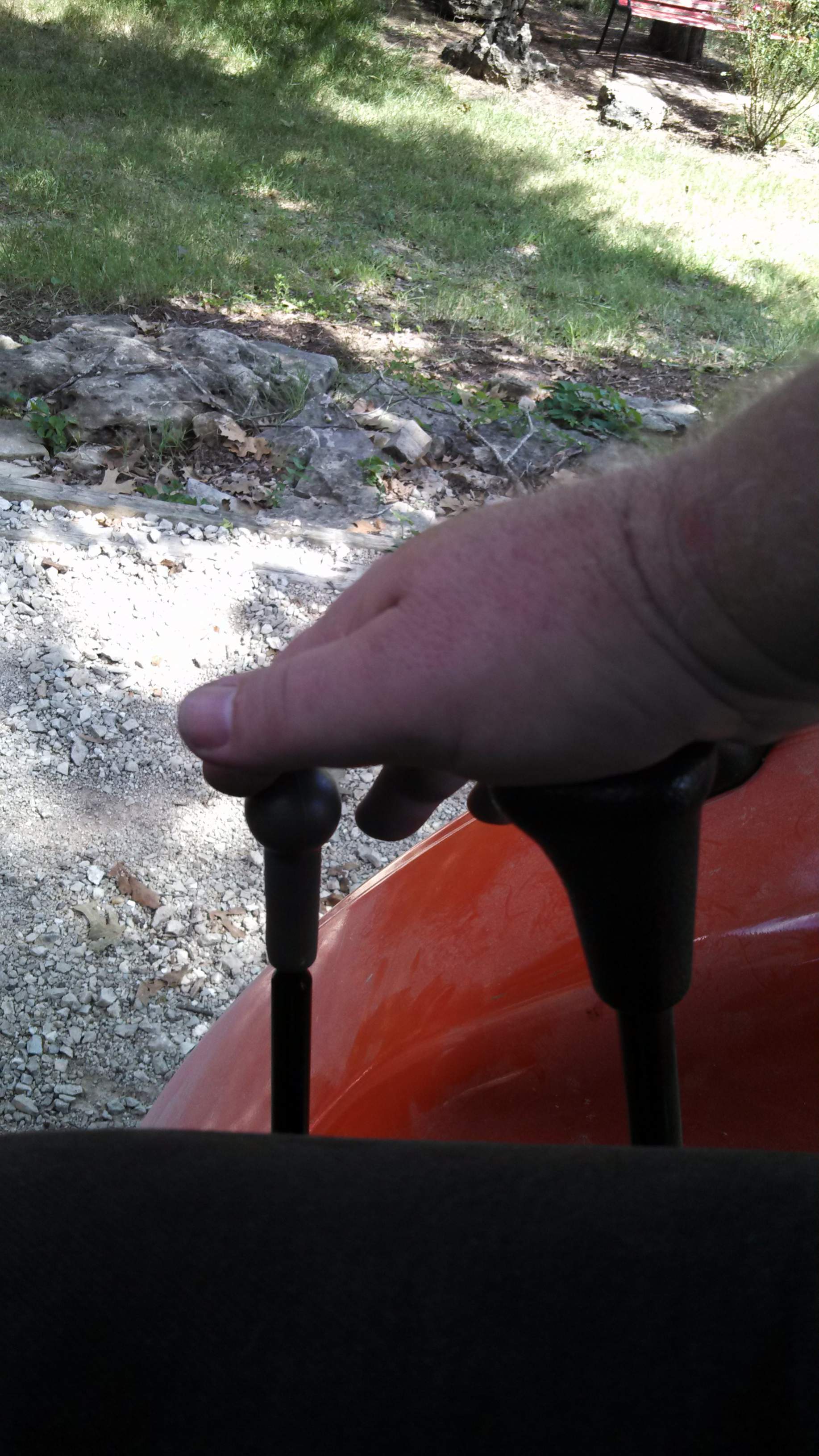

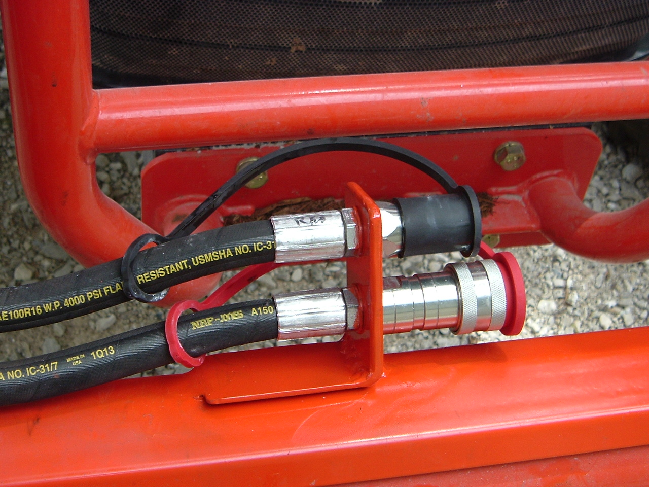

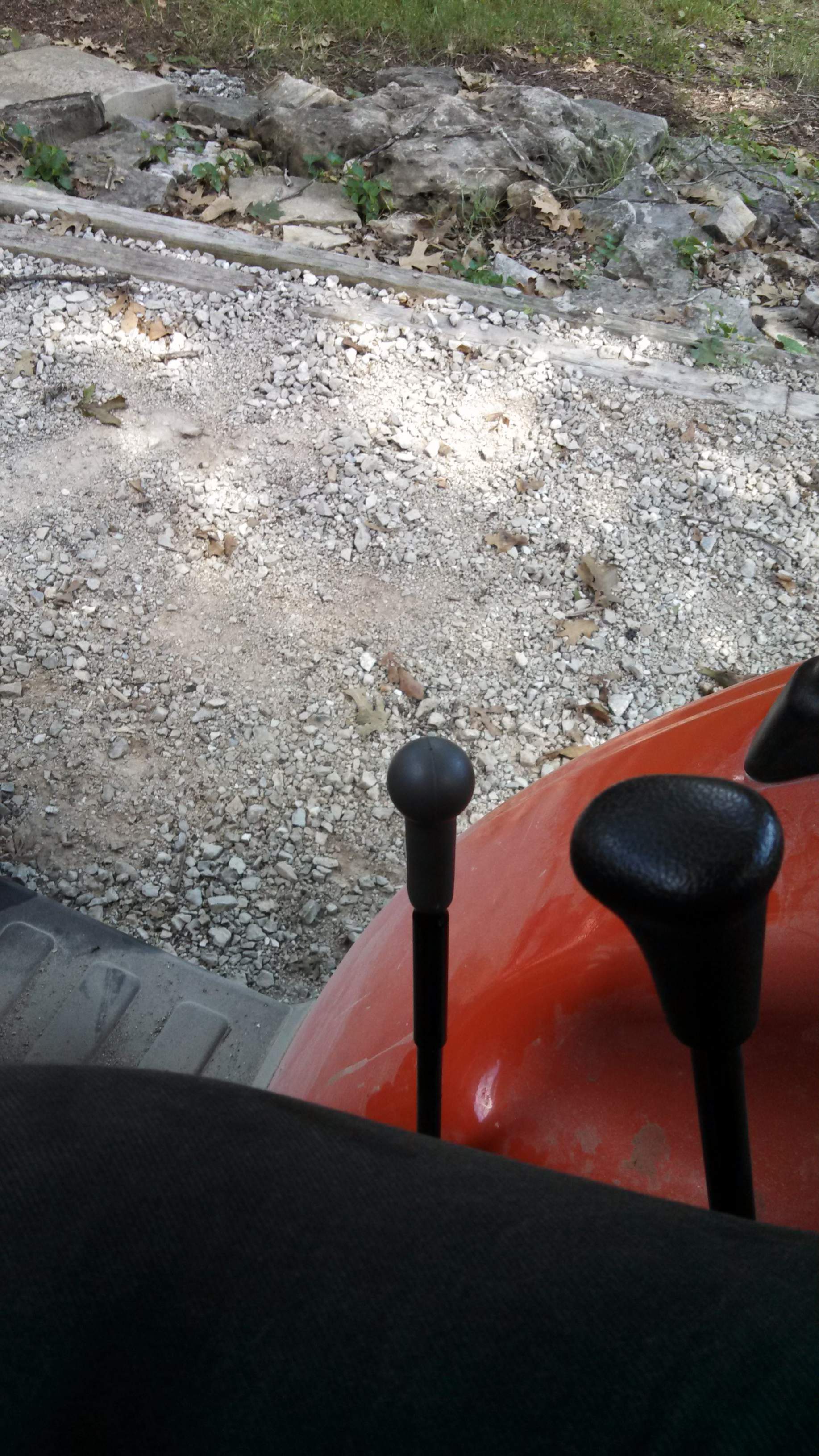

I use the rear remote lever. BUT, I extended its length, and it is so strategical placed in front of the joystick, I can actually operate with my fingers while operating the joystick with my hand. Not many tractors are built like this, Most will have the rear remote lever somewhere behind the joystick lever, usually by your rear hip. So, not so convenient. In fact, probably not convenient at all. But it is cheap. A true third function would be best if you can afford it. And if you can have the dealer set it up before delivery, Well, that would be nice. :) I did it all myself, and I am very satisfied with the way my setup turned out. But it probably would not be the best for most tractors.
