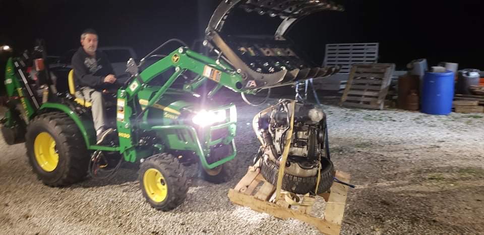

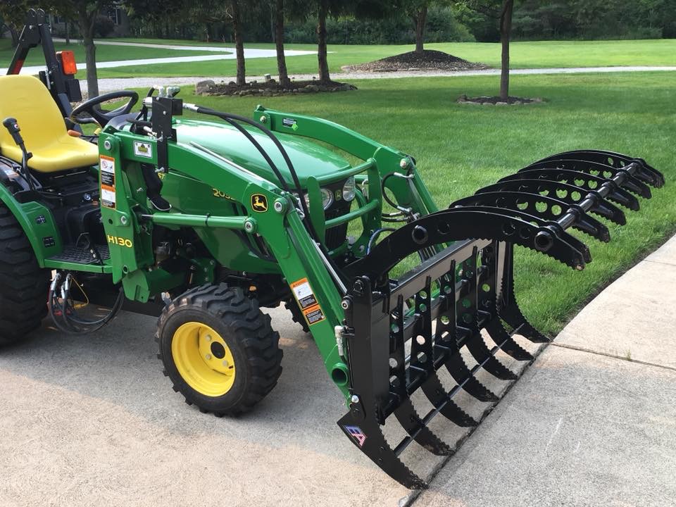

I bought a Grapple for my JD2032R last fall. Got it from Everything Attachments. They have the 3rd function kits also, which I got. The kit for mine is a divertor valve type. It works fine. I don't think the average person needs to operate all three functions at once. It doesn't seem to slow me down at all. Once you get a grapple, you'll wonder why you waited. I pick up all kinds of stuff with it. Tore up one of those sheet metal storage sheds and rolled it up into a ball in about 5 minutes. Good attachment.
