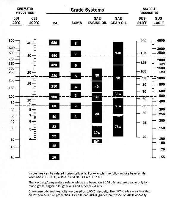

Also during my hydraulic fluid research for my wood splitter I found the attached chart. I have found it to be very usefully. There is a color version of this chart on the Internet but I could not find it today. Even if a oil matches in viscosity you may not want the included additives or the base oil type. The attached links are also a few of good sites about oil / lubrication I found.

Interesting side note, when I found the specifications for Kioti recommend hydraulic oils I found fluids' viscosity did not match up precisely on the chart.
