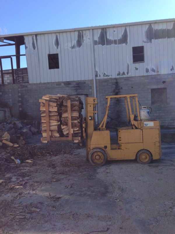

I've got plenty of leaky equipment, but I didn't just pay to have it fixed and it's not $60,000 equipment. It looks more like this. image-894545119.jpg That forklift actually leaks a lot less then his M59 currently does.
