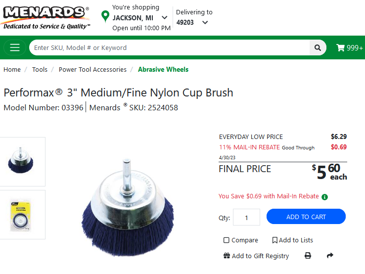

I have had pretty good luck getting just about anything clean using this nylon bristle brush chucked in my cordless drill. Just dont go crazy with the speed... Depending what exactly the contaminant is, the "solvent/detergent" will differ. Sometimes, I need to throw in some "barkeepers friend" and let the bleach in that work for a bit. Once you get it clean, then is the time to seal it with a good quality wax or similar that makes it hard for dirt to adhere in the future. The worst I have ever had was the liquid part of asphalt transferring onto shoes from a newly re-sealed driveway. To get that stuff up I had to use kerosene and then wash that crap off the floor with detergent but I got it up.... just do small sections at a time..
