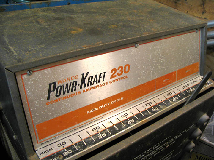

Go back a littler farther to this elderly AC stick welder from Montgomery Wards, mid 1960's. The cooling fan is the only thing aside from the transformer, inside it. Any similar fan could serve to replace that, there's plenty of space to fabricate a new mount.
The generic on/off switch has the only points in the whole welder. Current adjusts by moving a slug in/out of the core. Aside from the on/off switch there's nothing to arc and burn anywhere inside. I expect this thing will outlast all of us. Elegant, no, but similar units fabricated a lot of stuff up to shipyard size, long ago. (But I gotta admit my mig welder is a lot easier to drag out for a project that is within its capability! :) )

FWIW, on our welders use muffin fans, which will work if you match specs. Easy to find, cheap to buy. Same thing with the old Montgomery ward AC stick welder. You still need to match specs if you want the same duty cycle.
