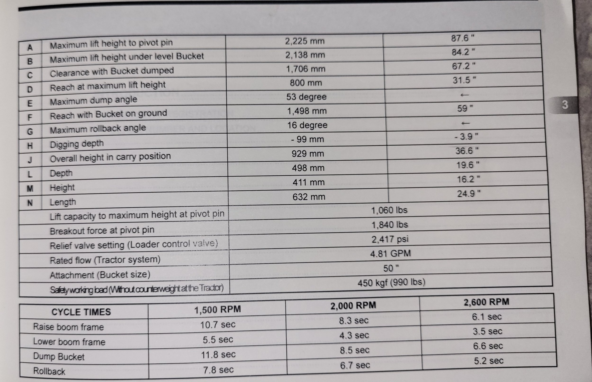

Hi all the bL00 loader is made in Korea by Ansung and the SL00 is made in Korea by Shindong not sure of exact specs at the time but will post soon the major difference between them is the SL00 goes a little higher in lift and capacity is a bit more will post specs in next couple days
   / Whats the difference between bl00 and sl00 FEL? #8

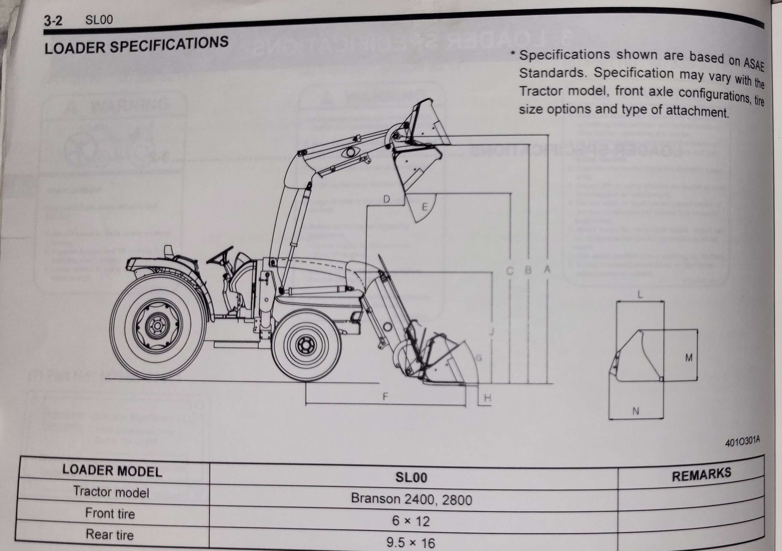

I know this is an old post but I have a manual for my 2016 SL00 loader and thought I'd post the specs pages. The manual says printed June 2014.
   / Whats the difference between bl00 and sl00 FEL? #9
It may help someone in the future.
